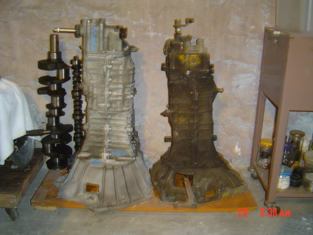

Here is a picture of both side by side, the UN1 is on the left and the NG9 on the right, you can clearly see the difference between the two, The UN1 came from a 1995 Lotus Esprit S4 (300 HP I believe) and the NG9 is out of a Renault Fuego, about 100 HP on the Fuego?
In any case the only difference between the Medallion and the Fuego transaxles was the bell housing otherwise they were the same, they may had different designations, NG6, NG3, etc but all the NG are too small, translation, NG = no good, you will need a 369 or UN1 transaxle.
The only two production cars sold in the US that had these types of transaxles were the Lotus Esprit (UN1) and the Delorean (369). The Delorean was a rear engine car so if you find one you will need to open the box and flip the ring gear. The UN1 on the picture will be going on Ebay soon but to be honest with you a better or perhaps cheaper solution here in North America Is finding a good Audi transaxle. The UN1 is a good choice for Europe or for any GTD owner, as these cars were designed around UN1 and 369 boxes.

Yep. Ive been down that road before too. I have several UN1 boxes in the workshop and decided to check out an NG3 that was in the later Renault 20 cars. It sure is a smaller gearbox, the crownwheel not much bigger than a tea saucer. They do have a 4-spider diff unit, but even that is soo tiny. I think that one planting of the boot with a V8 on it will shred every tooth in 1 fell swoop. Not to mention twisting the shafts like a peice of liquorice.

you can tell a NG1 form a UN1 very quick by counting the bolts on top of the box, the ones which keep the cases together, the UN1 has 8 the NG series had 7. renault rated the UN1 at <350nm and the NG3 and 5 <200nm
