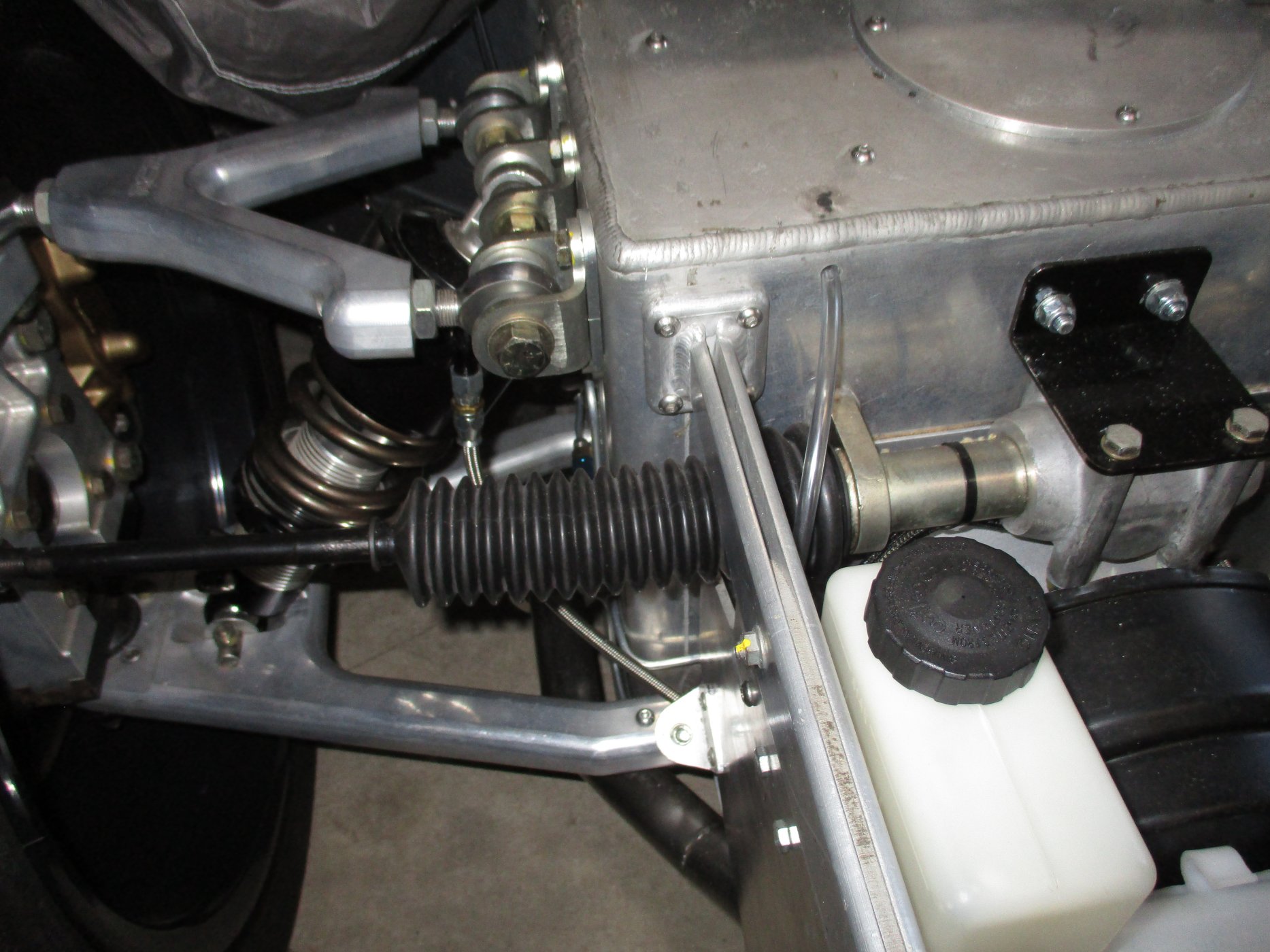

Not sure if these will work, but they fit the Unisteer Rack that I have. My car was delivered in 2019.
visually that looks similar - 3 large bellows and then a bunch of smaller ones .... if nobody has ever replaced their boots before this might just end up being a guess-and-buy-and-see type thing

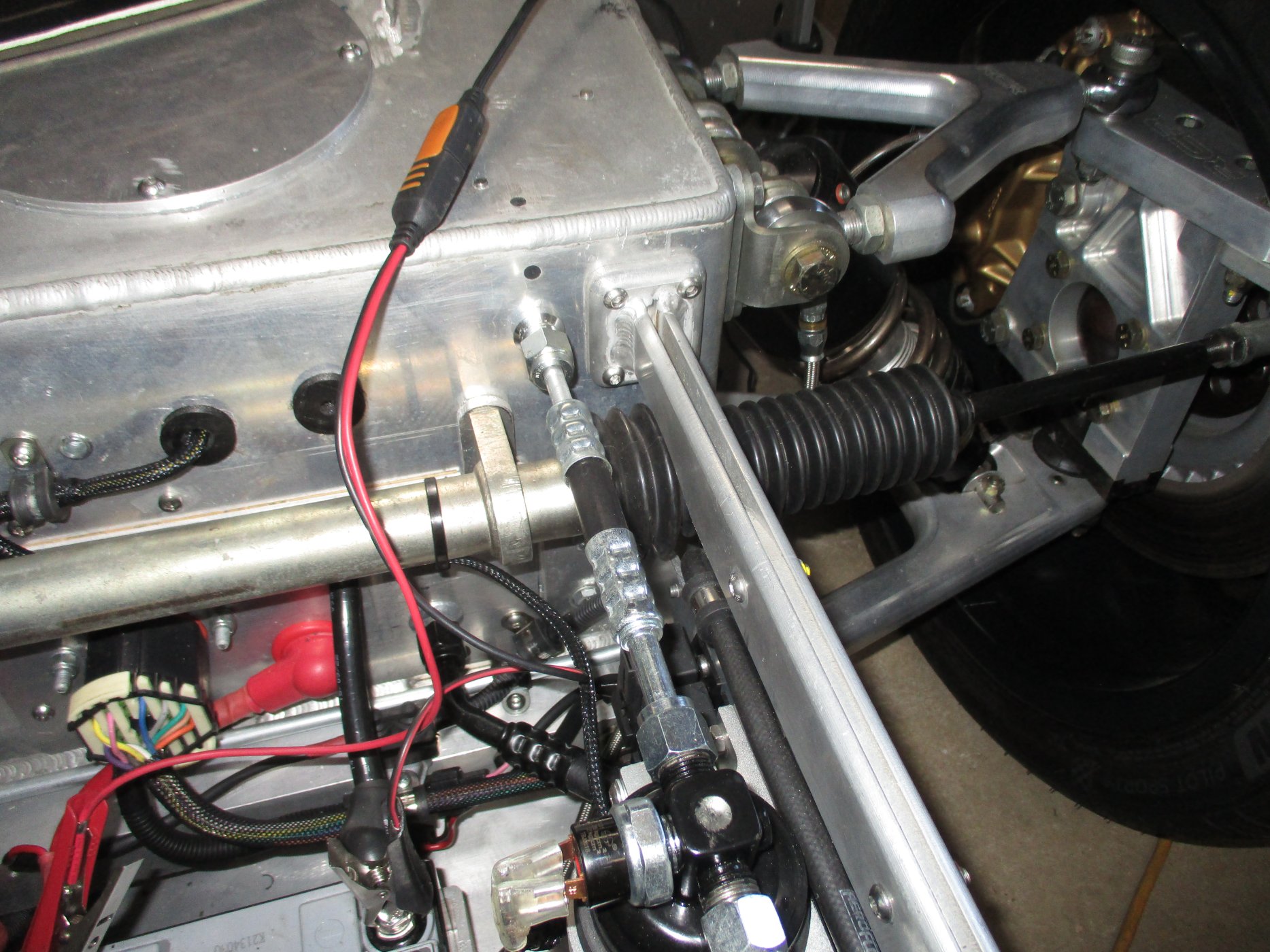

Murray from Australia ordered these and I believe they fit, but not sure if he has the identical rack you have or I have.
Correct - I ordered part number that Joel supplied - They work just fine

After closer inspection I found several small tears in multiple bellows ... my car's not high mileage (~3,000 miles since 2008) so if you have an original Maval rack you might want to check yours.
The part above - Unisteer 620270 - fits close enough ... it's about one and a half bellows longer than the original so the inner bellow sometimes bunches up against the zip tie holding it on the rack ... might cause wear in the bellow over time but i suppose it's no worse wear than the bellows rubbing against themselves as you turn the rack

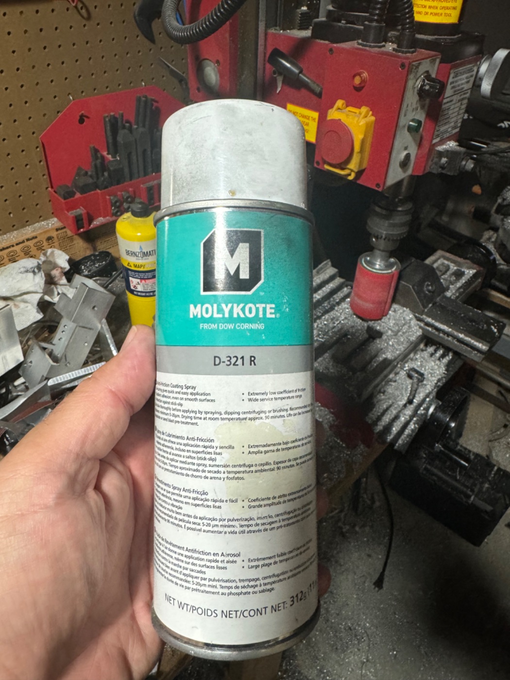

Alex, the dune buggy crowd sprays a dry lube on the CV boots. Maybe applying this to the steering rack will help avoid tears. I have a can of this and sprayed my CV boots so going to apply it to the steering rack boots..
