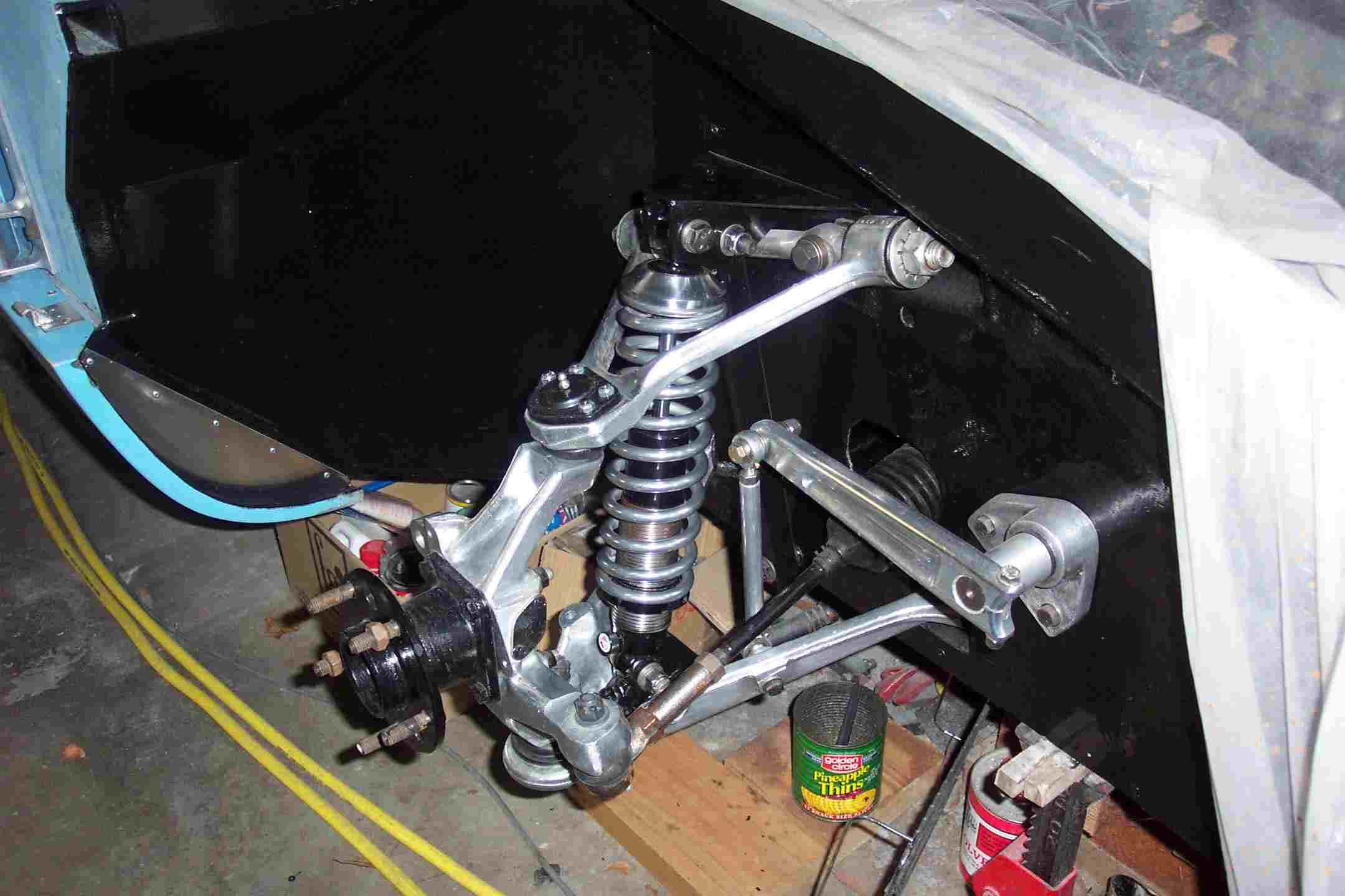

Charlie - a shot of the front :
I have them from vintage Wheels and i believe that Trago also makes them. It's the bolt spacing that is the important measure. I believe it is 4.25 soacing with .5 bolte 5 pin.

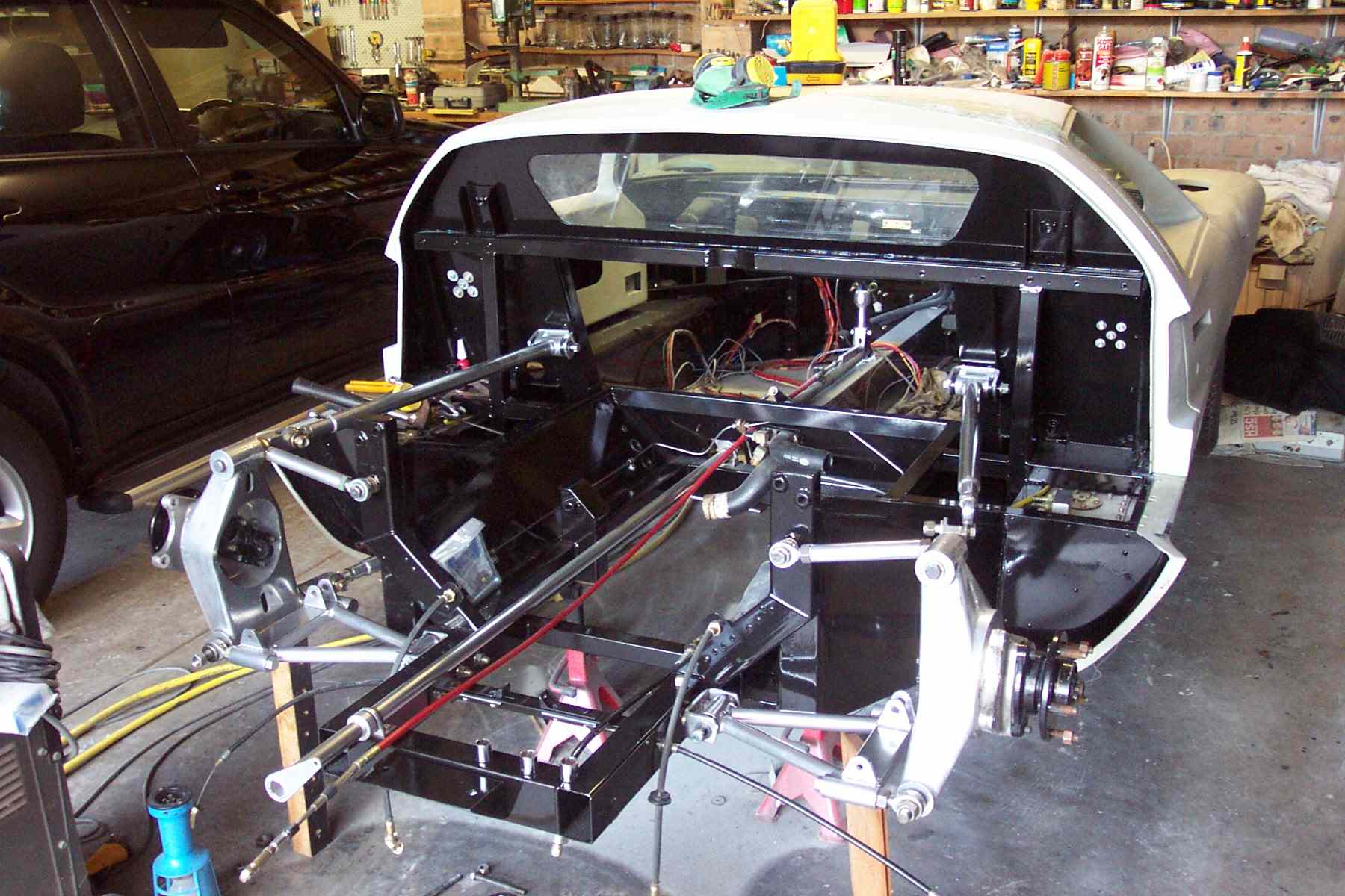

Charlie, one of the DRB agents in the US is Forum member Bill Bayard.
You migh also want to look at the rest of the rear DRB setup - lower a-arm, top control arm, bolts & clevis for each. That way, you end up with a pre-designed "outboard" setup, & all you have to do is mount the control/a-arms/trailing arms.
