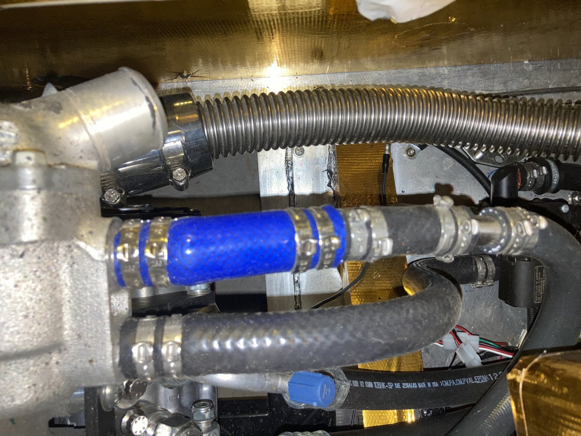

Kyle:
I could not find the specific part number, I just ordered the cheapest silicone hose for the size I needed, I believe i found it at summit. Here is a picture , on the right side I needed an small (purple section and then an adopter for a smaller size and then a T connection, hopefully the picture helps you

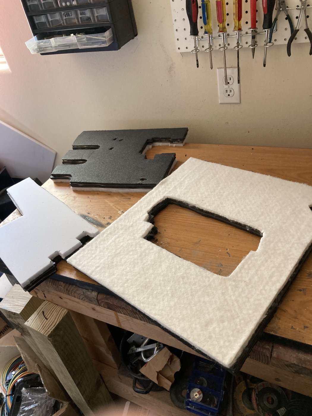

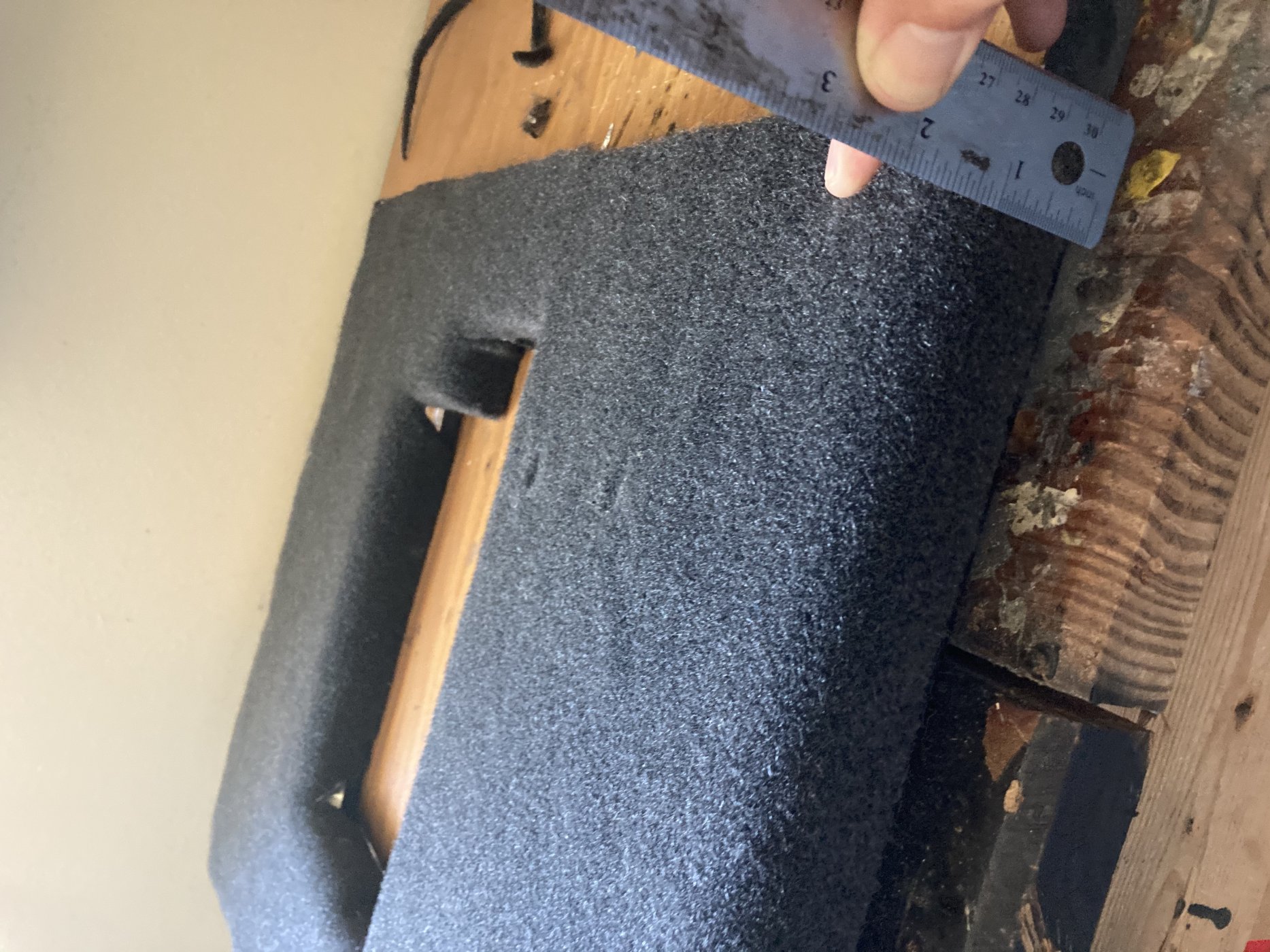

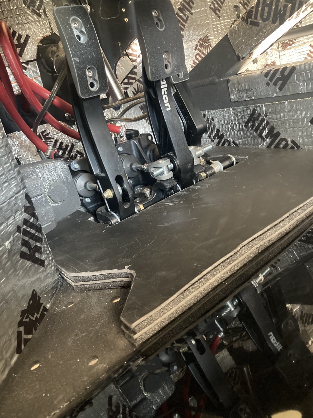

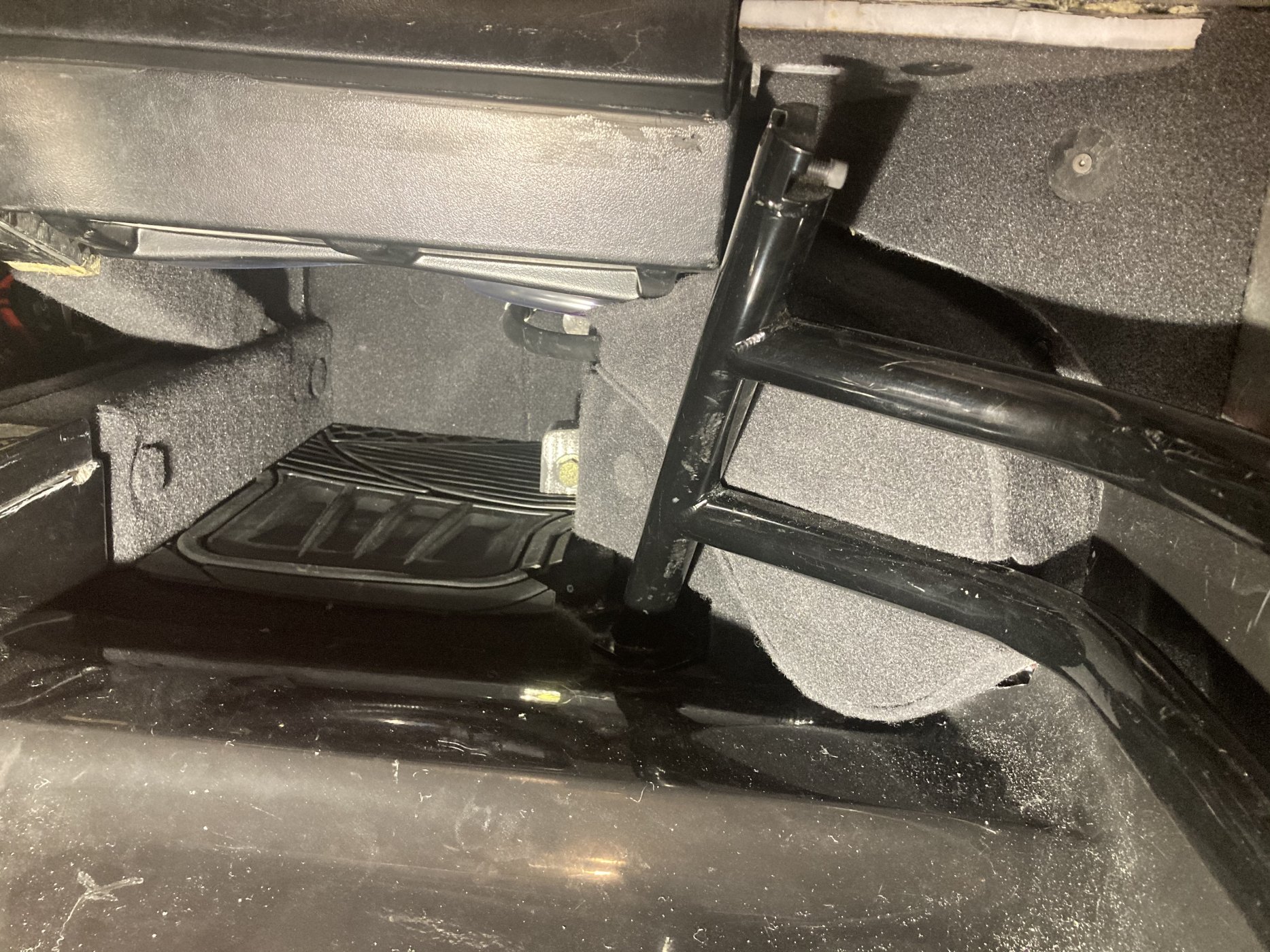

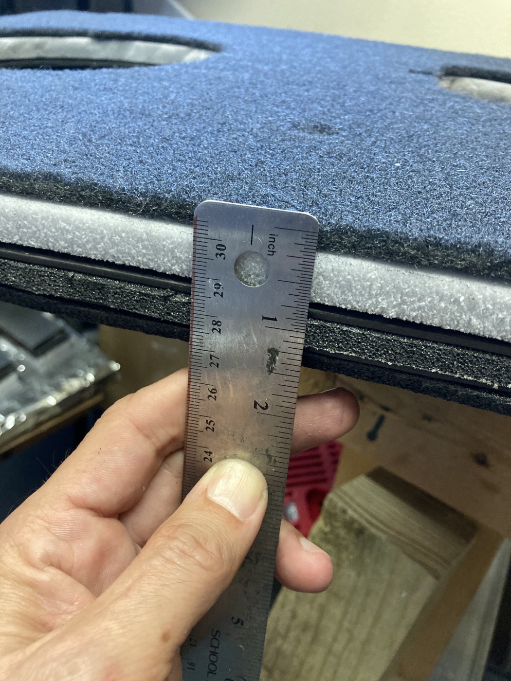

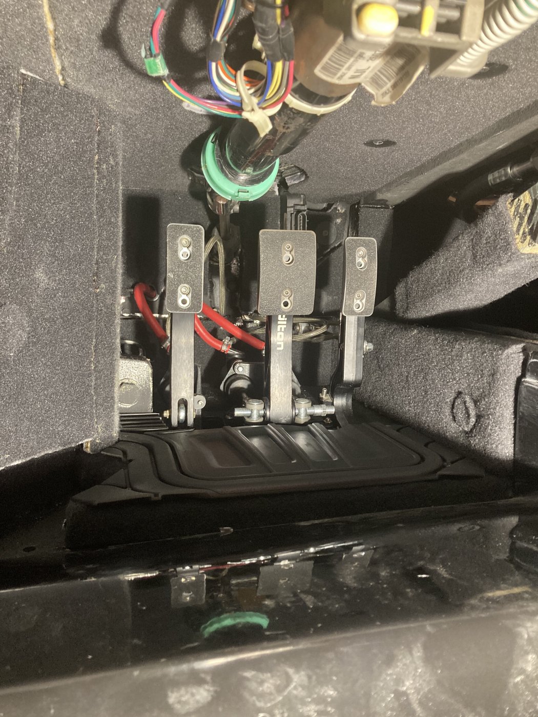

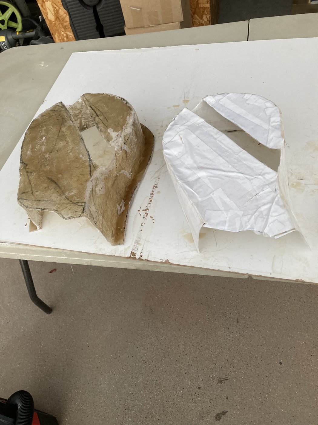

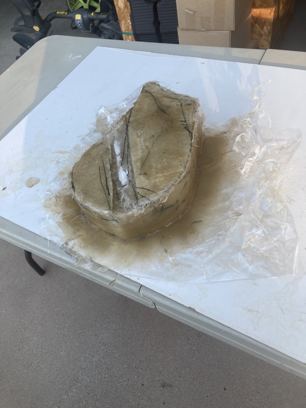

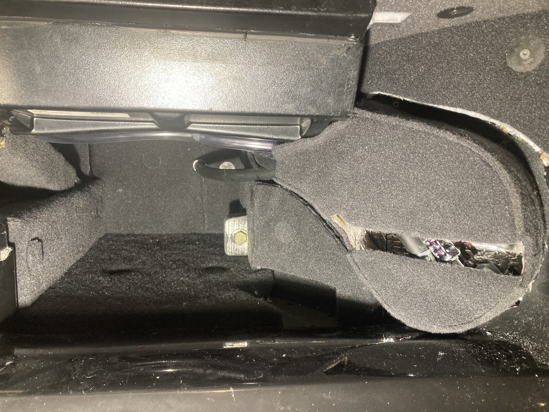

So I have been tied up inside the footboxes for a while, I wanted to finish the insulation and final finish , I had to make about 20 panels , made of two layers of 1/8" mass loaded vinyl , 2 layers of 1/4" closed cell foam , 3/8" melamine foam and covered with carpeting. (about 1 1/2 inch thick) That on top of lizard skin spray and 80 mil kilmat (the stuff is awesome and super easy to cut and self stick )

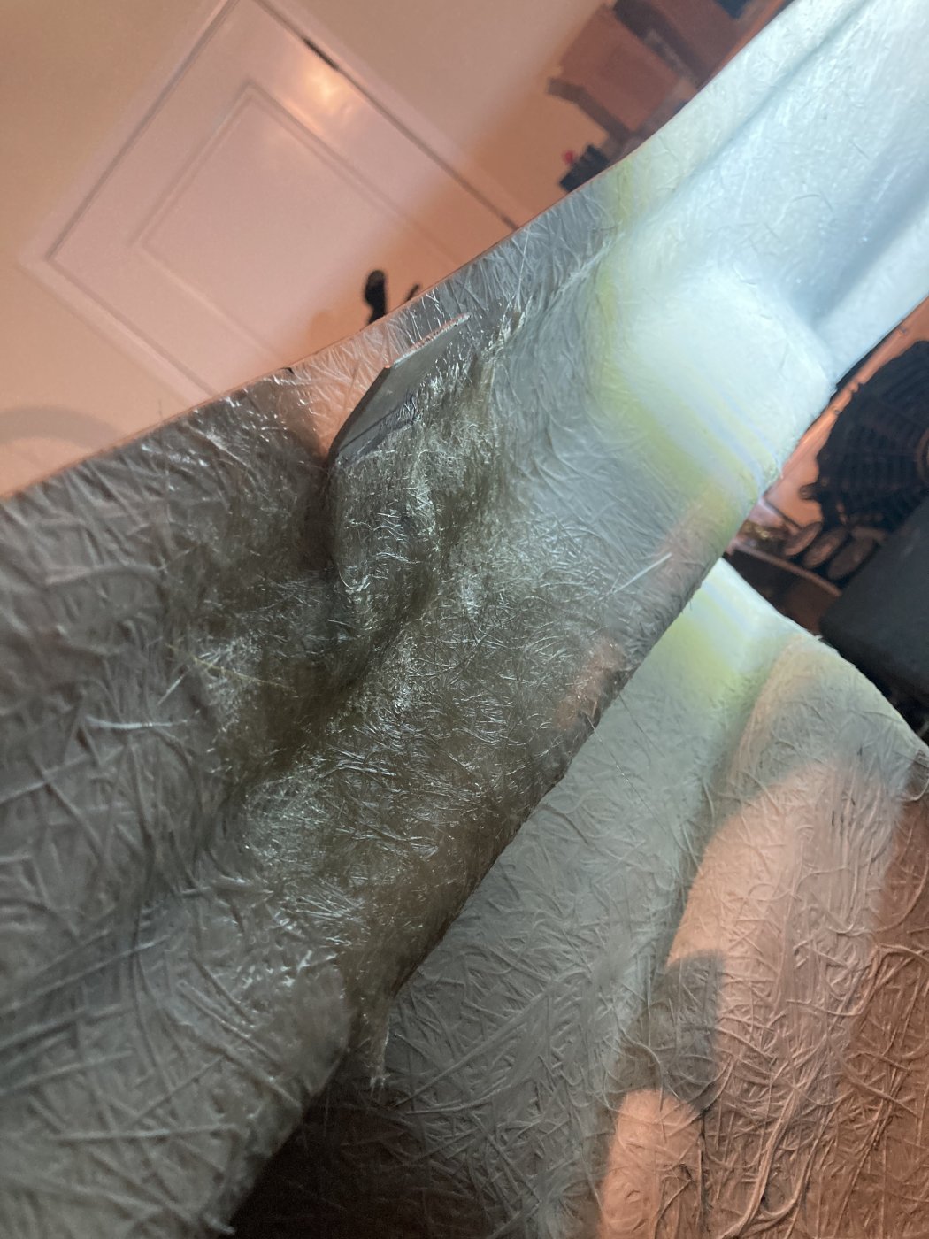

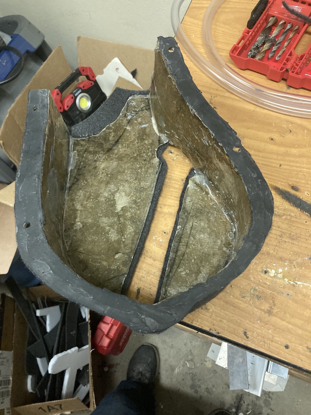

Probably reached the point of diminishing returns but I want great sound and temperature insulation. I had to make a fiberglass cover for all a/c and heater hoses inside the passenger footbox. I also added rubber mats to the floor.

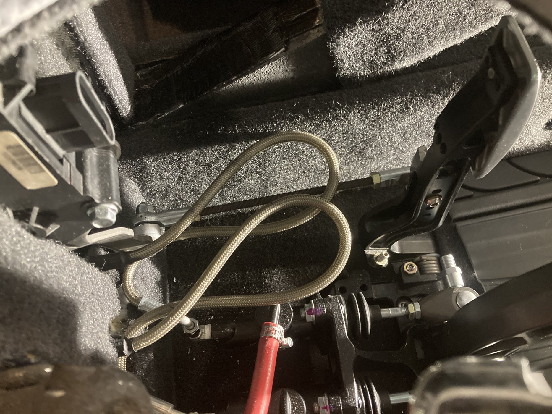

I had to reposition the drive by wire electronic throttle , the bracket that came with it was not good at all, had a horrible angle and poor pedal travel. Positioning it on the back wall is perfect. (thanks Cam for the tip ) Will start alignment and tub and spider final fitment tomorrow .

here is the repositioning of the electronic throttle control on the back wall instead of the bracket provided by RCR

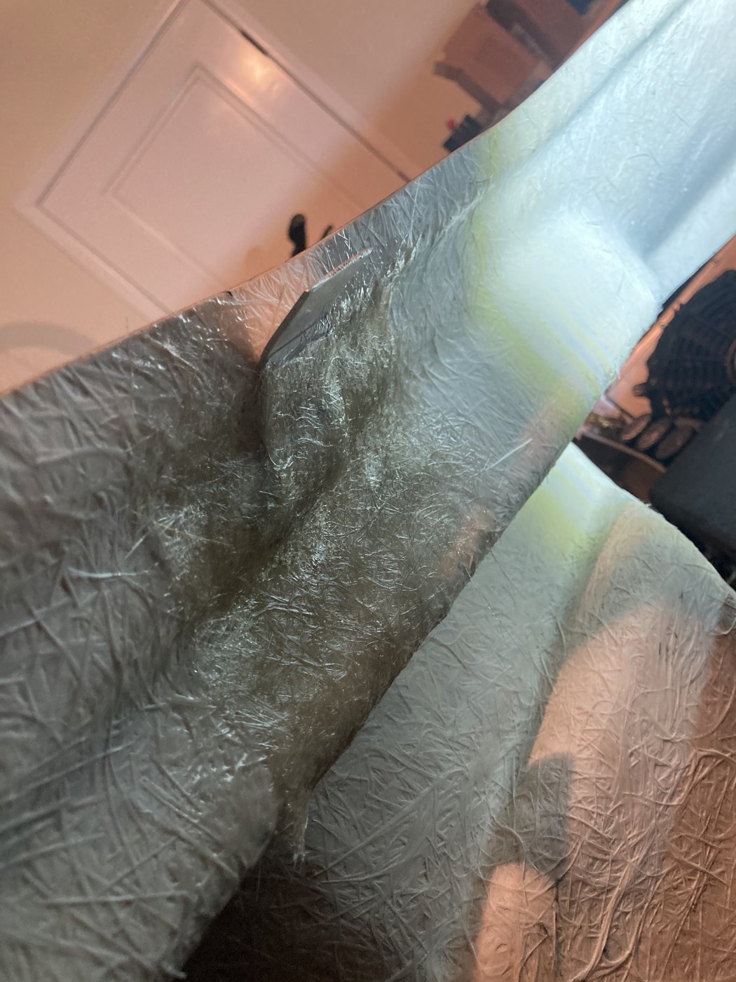

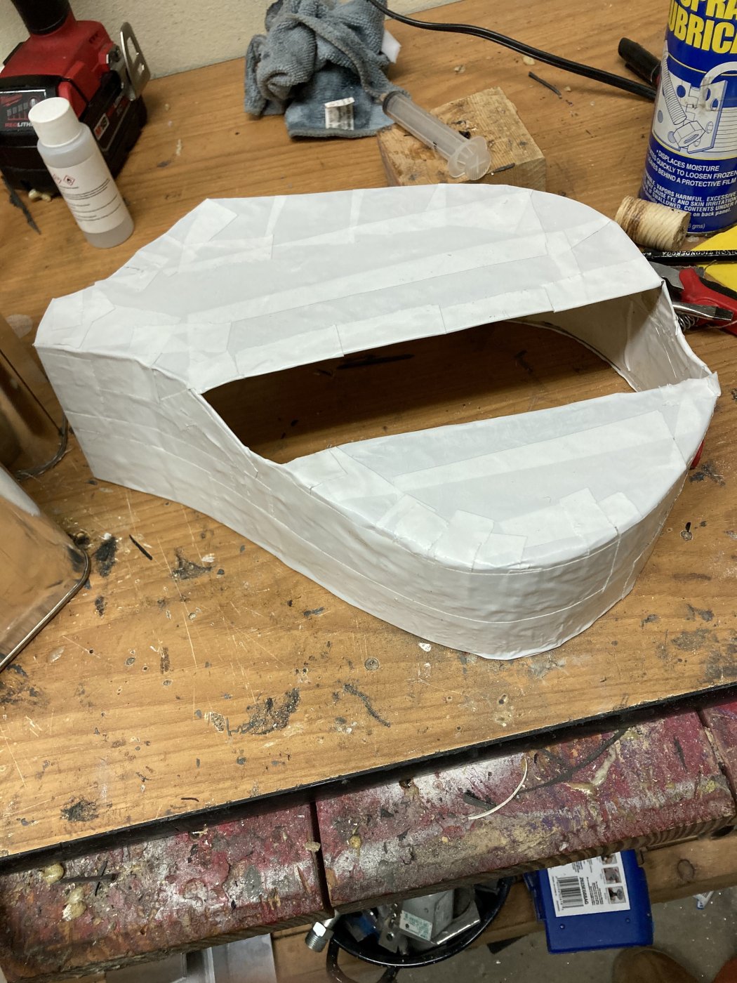

I also finished positioning the dashboard on to the spider using 3 aluminum brackets bonded with epoxy and reinforced with fiberglass

Hector, the foot-box came out really nice, good work! That is a serious amount of heat and sound deadening.
Thanks Joel, It may be overkill but I want to be able to drive in the West Texas heat comfortably. And want a nice stereo sound and be able to listen to my phone while the engine is running, not an easy thing to do in this car . I pan to drive it A LOT!! I do not like to own garage queens, never have, never will , cars are meant to be driven. And I hope this one will be no different. We shall see.

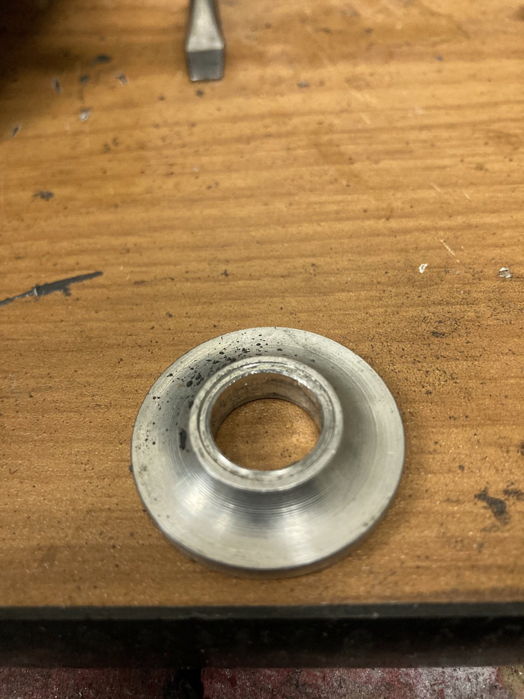

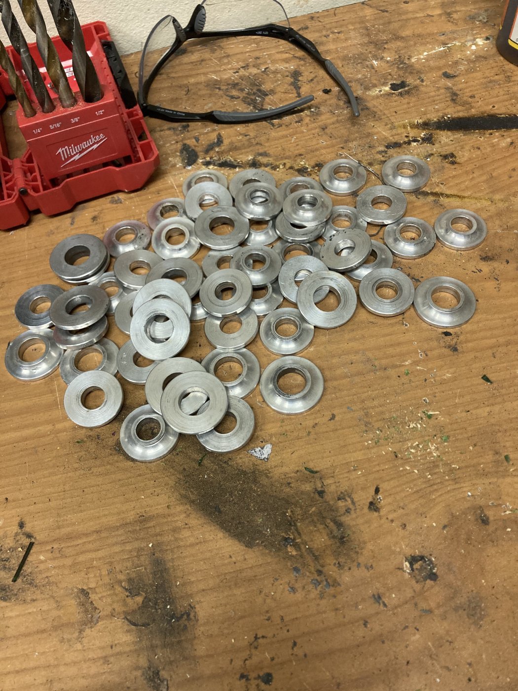

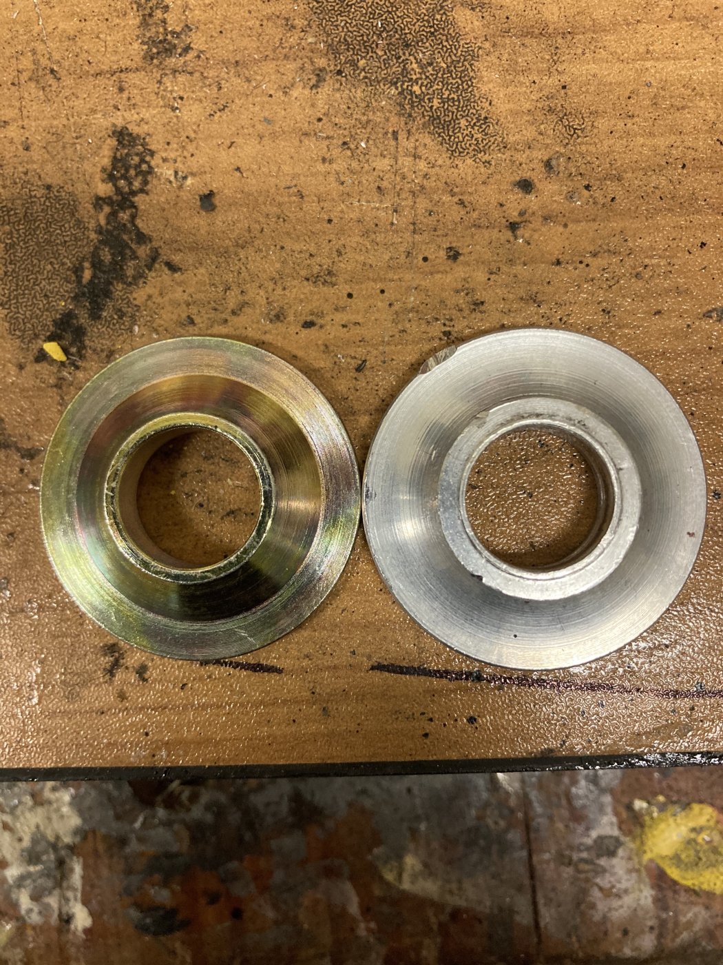

So the challenges continue, decided to replace all the aluminum safety heim joint washers with steel, (thanks Cam for the reminder) as you can see just during transport and assembly several of them were damaged already. So this is the third time I completely disassemble the entire suspension. 3 difference safety washer sizes, 1/2, 5/8 and 3/4, I think the final count was 62 and the spacer washers had to be of different thickness. Quite a project. I also added anti seize to all the bolts , as some of the aluminum washers got gouged and stuck.

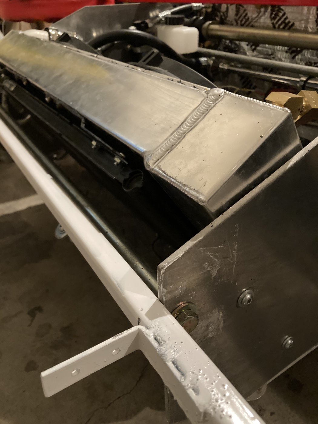

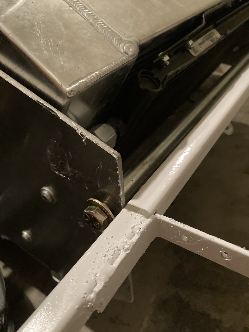

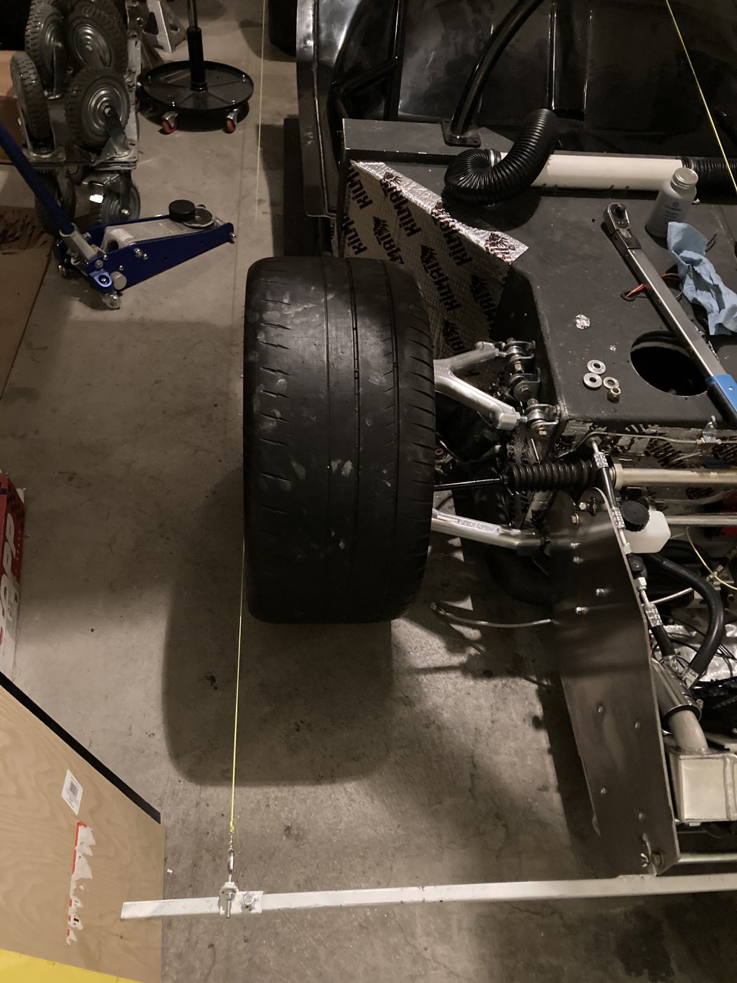

While finalizing the alignment using Howard's jig, I realized the front end assembly that holds the radiators is about an inch lower on the passenger side, which will create clearance issues as well as body fitment problems. I don't know if it was mounted lower on one side or it is bent.
Has anybody encountered this problem? Just another road block I guess.
Hi Hector, where did you order yours from? I could not find the 3/4” steel safety washers where I ordered my others from.
Hector,
Ken Roberts ran into this and mine was off as well. Check out Ken’s post #793 where it is discussed. My chassis holes were just marked and pilot holes drilled and I had to adjust the height to even it out before I drilled the holes.
