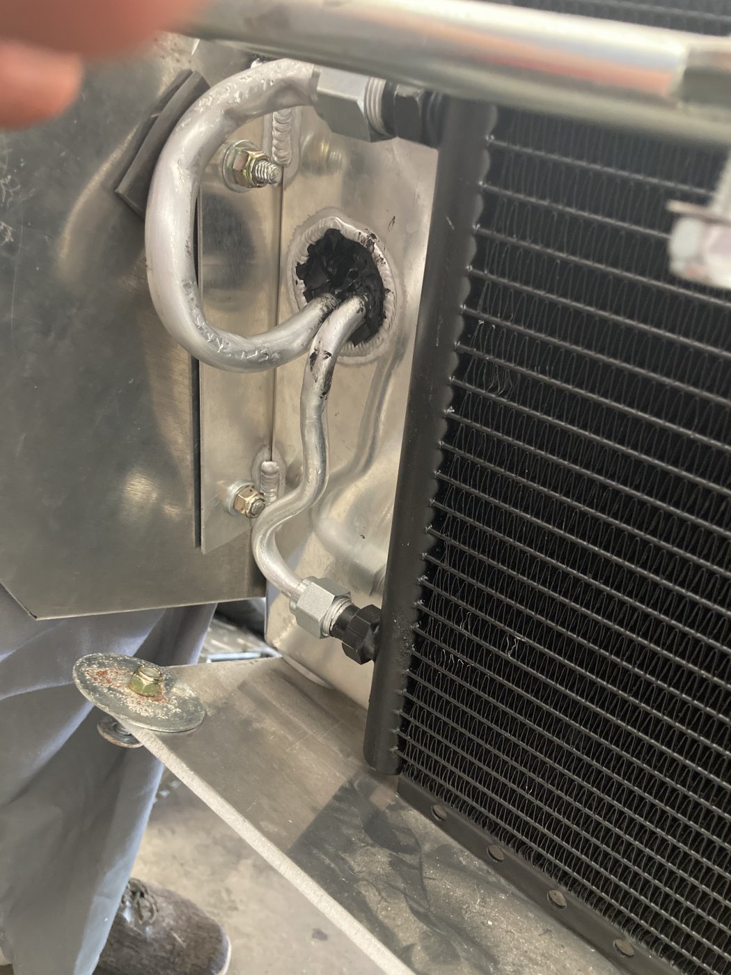

Ha e a question for you. Was wondering what the white material is between the fitting and the condenser? Is that Teflon tape? Is that standard practice for Vintage Air AC Fittings?
If so, is it the really thin stuff? I know Home Depot sells blue, red, and black where blue is the thinnest and black is much thicker.
Joel:
I believe is Teflon tape, came with the condenser and I did not bother to remove it. These are O ring fittings so the sealing is done with the o rings I don't think the Teflon is necessary at all . I did not use Teflon in any of the other a/c line fittings. However I used new O rings and lubricated them very well with the lube provided by vintage air (a set of rings was 3 dollars) used a ziplock bag full of oil and gave a bath to all the rings and kept them there until used, I discarded all the ones that came with the fittings. Fingers crossed. Hope I am right . Thanks for the observation though, you really do your homework well. Keep up the good work.

Thanks Hector, I appreciate the info.

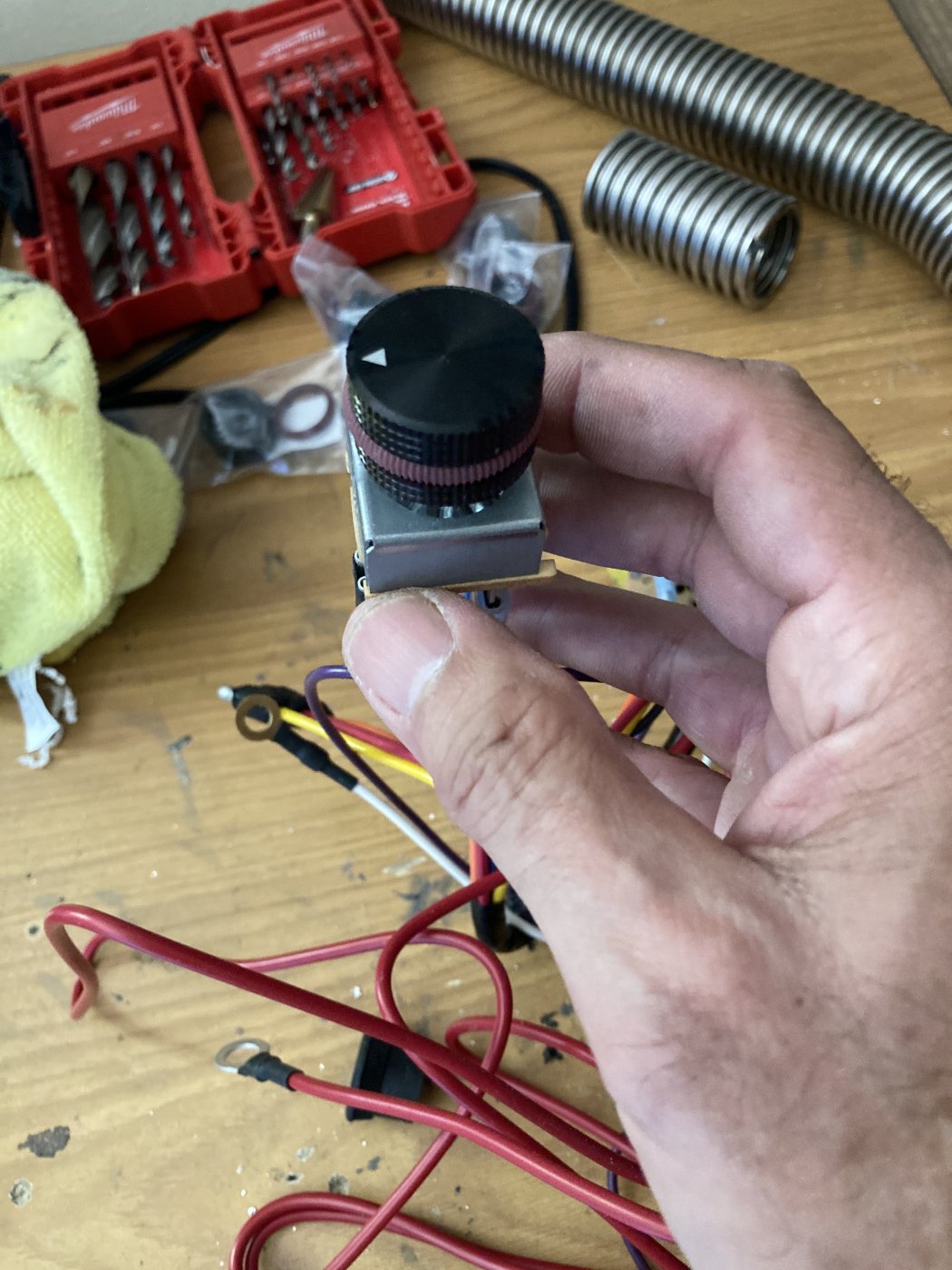

Found these great anodized aluminum knobs on some electronics website had to drill the back a little, but they work
Finally got all the a/c wiring figured out , a HUGE thanks to Dan Carter for all the diagrams, will not use the blue wires from the trinity switch and will use an invert mini, so that I can use it with the infiniti box system. Also got the master cell programmed to run both fans

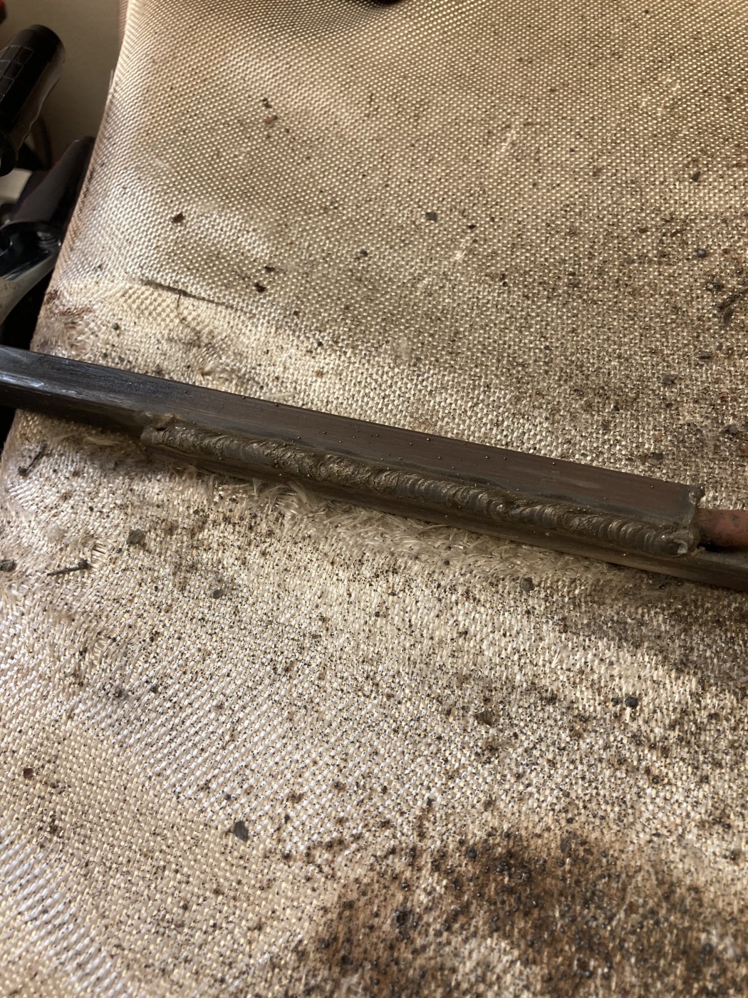

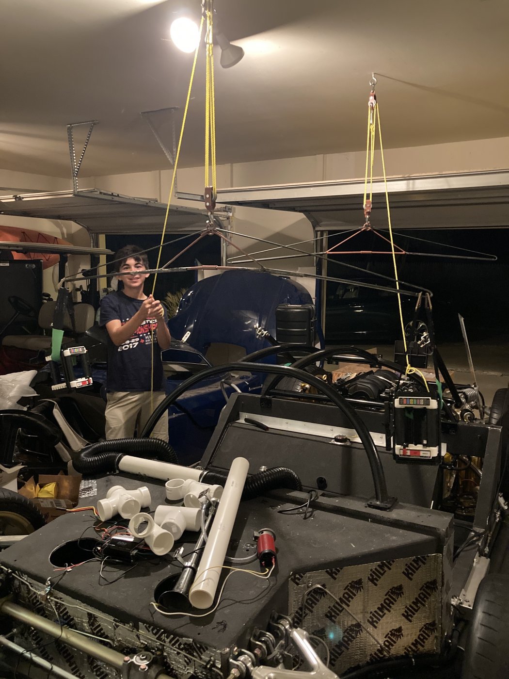

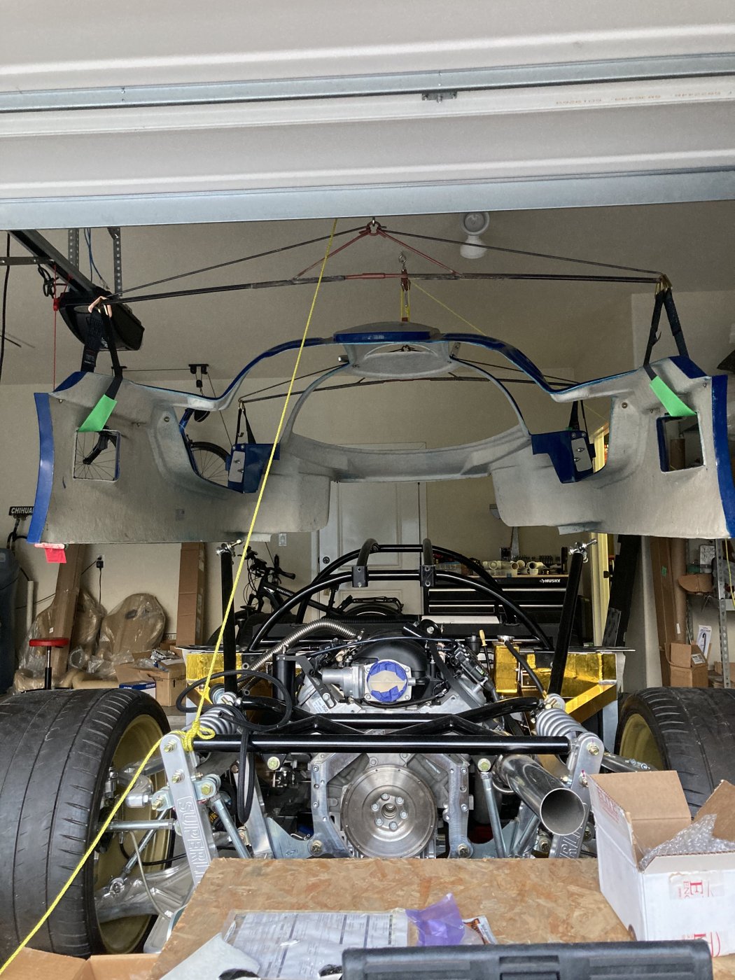

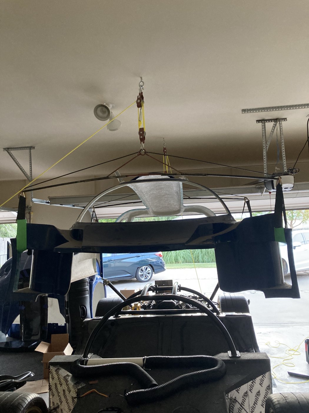

Had to find a way to lift the spider to make more room and also to put it on and off to measure and fit the dashboard and a/c venting system .
Used a $15 harbor freight game hoist ( as in deer) with extender wires so that the lift points would be right over the corner vents for lifting without much side stresses.
Had not touched a welder in 30 years, not too bad I think!! but feel free to point otherwise .
Tested it with two 40lb dumbbells I figure the spider is about 100 lbs , so close to a 2x safety factor of sorts. Again not the prettiest, but functional .

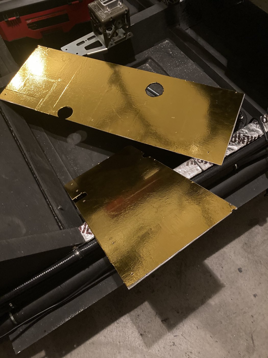

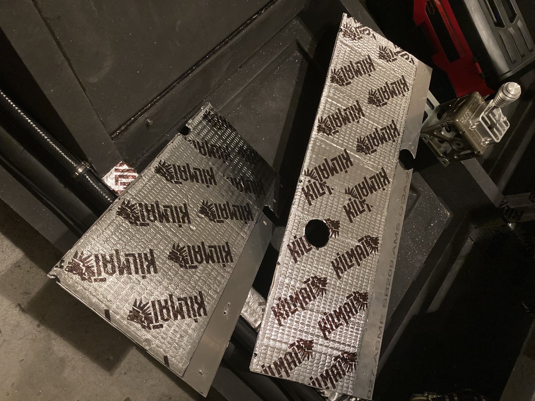

Fabricated the lower part of closeout panels posterior to fuel tank, absolute PIA with engine in place, should have done it a long time ago, needed opening for the fuel tank filler hose, the clutch cables and the fuel lines.
anyway all done, will add a couple of layers of insulation in addition to the gold tape and the kilmat, making my own luxury liner pro with 1/8" mass loaded vinyl plus 1/4" closed cell foam. Will also use melamine foam under carpeting. Thanks to Cam for all the sound and temp insulation pearls.

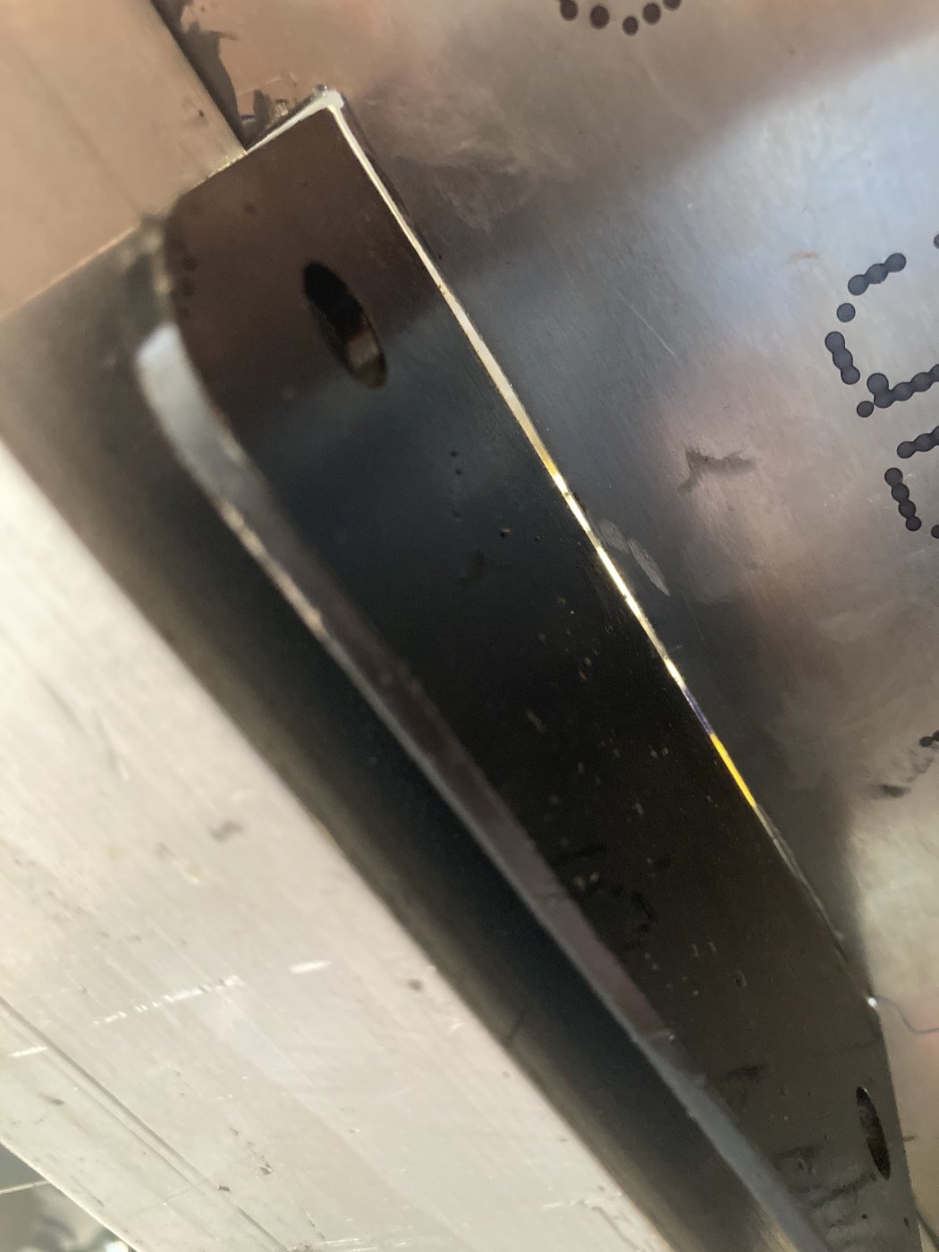

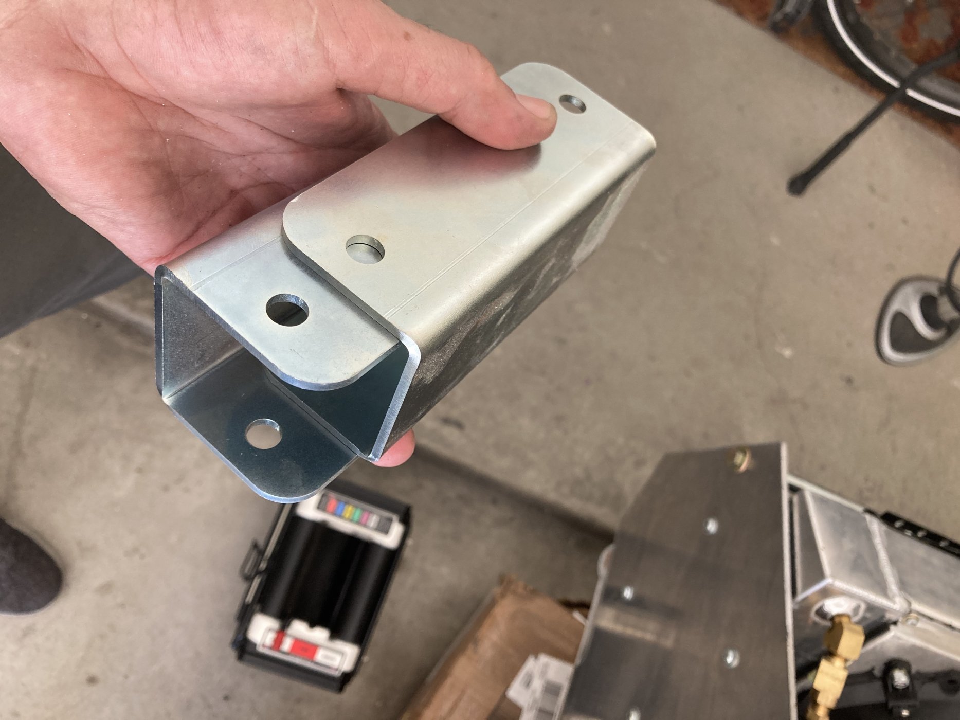

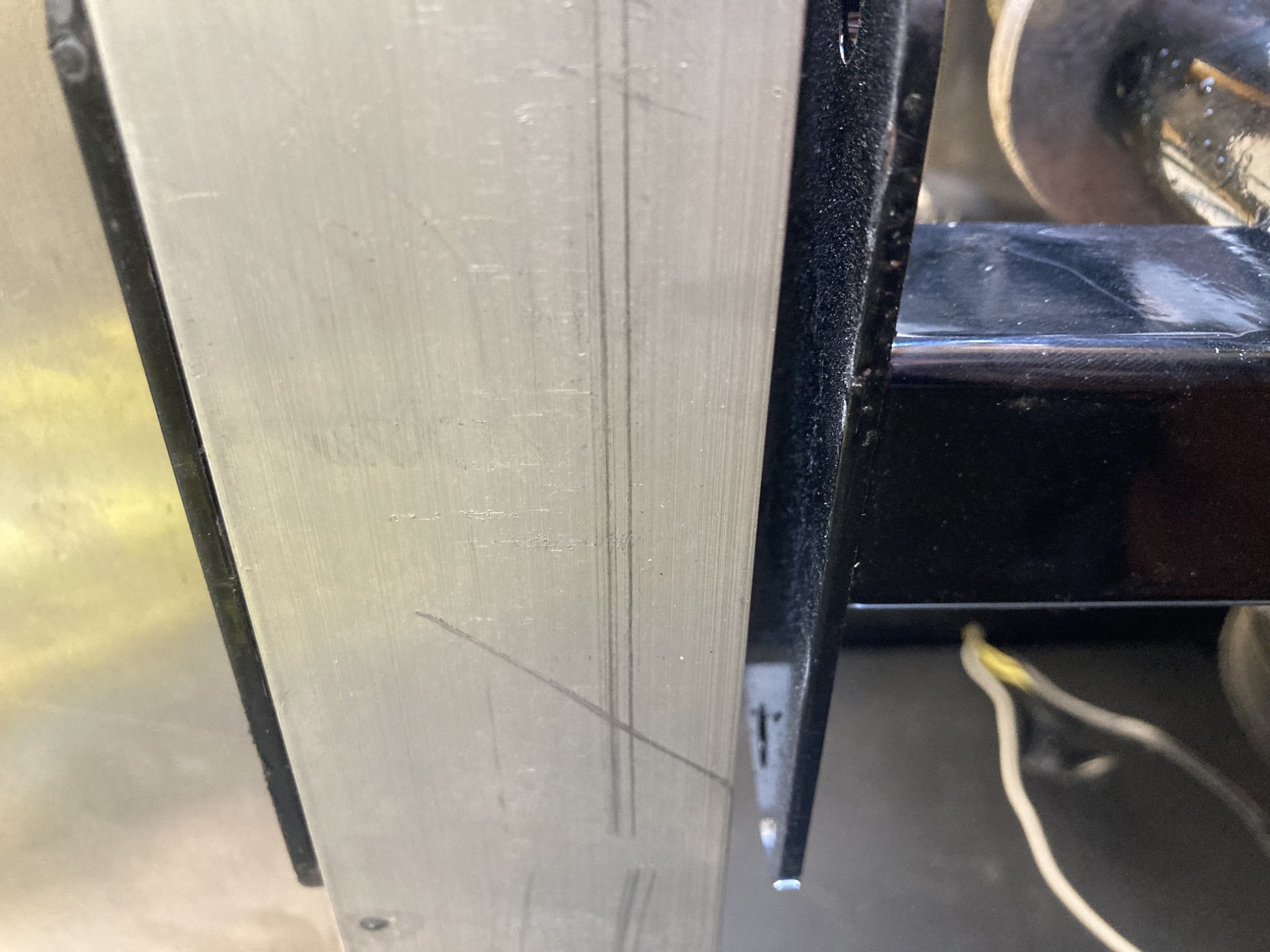

Wanted to install the lower part of the motor mount brackets, come to find out they are off center and there is no way to move the engine without major modifications to the front brackets. Fran assembled the engine prior to transport. So I am going to add spacer and bolts and not the bottom brackets, it will take a hell of a jump to shear the bolts off.

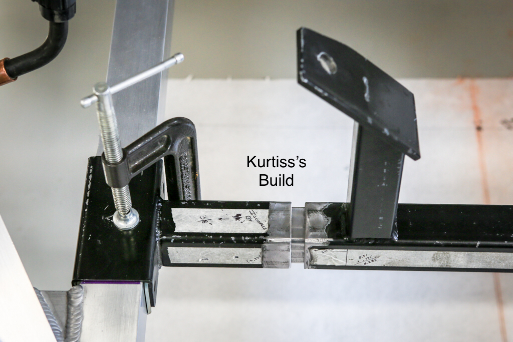

Hector, my front engine mount looks like it had a similar problem. That is the mount was a good 1/8”-1/4” too narrow and there was no room for the lower brackets. I wound up fabricating my own since the LT4 engine mounts have a different geometry than the LS.
One thing you may want to do is take it out and widen the bracket a bit.
Take a look at Kurtiss’s GT-R build page twenty five, he did a nice mod on his front engine mount to change the centering of his engine.
Here is one of his pics..

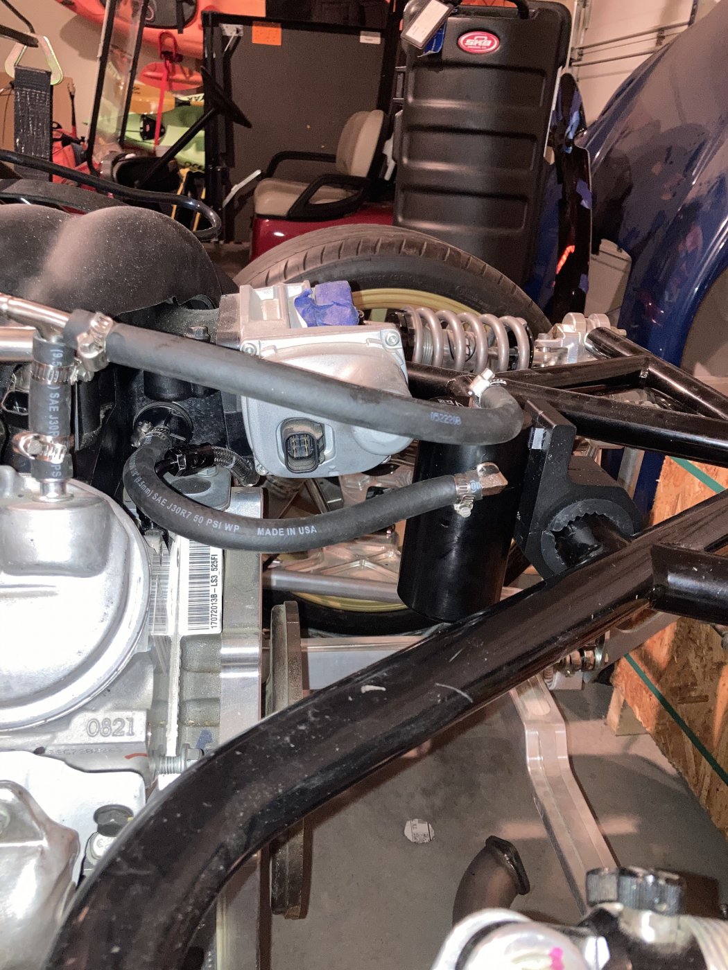

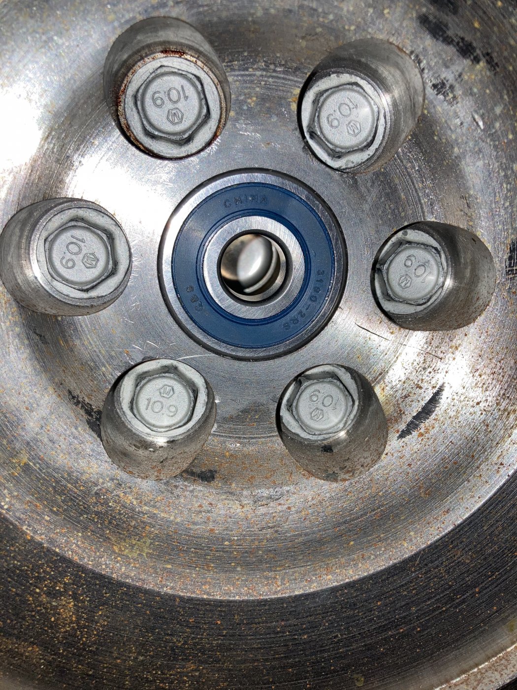

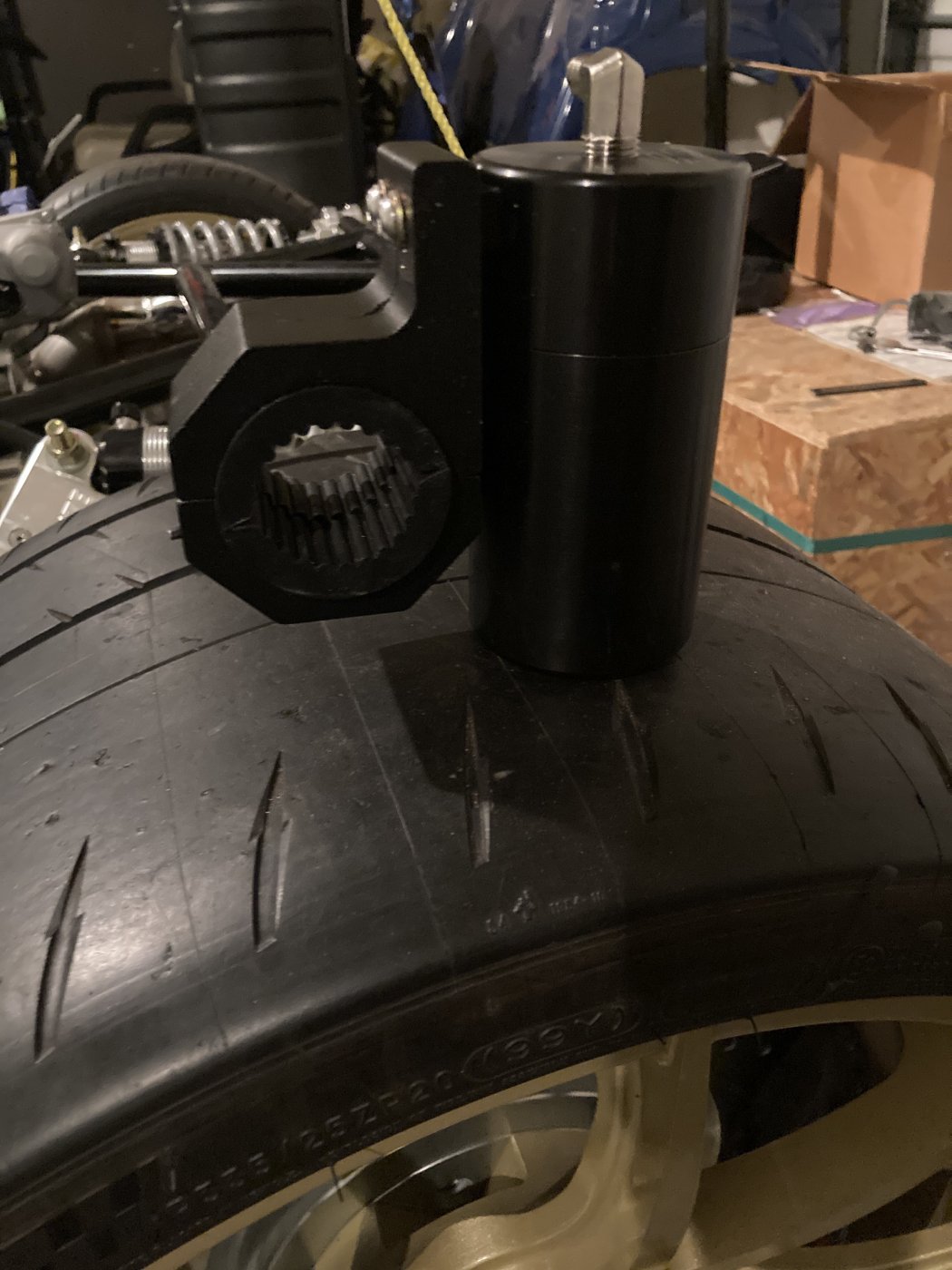

have been stuck figuring out and gathering electrical components, I felt the need to accomplish some task, so I pressed the pilot bearing, very happy that it fits nice and tight, major relief.

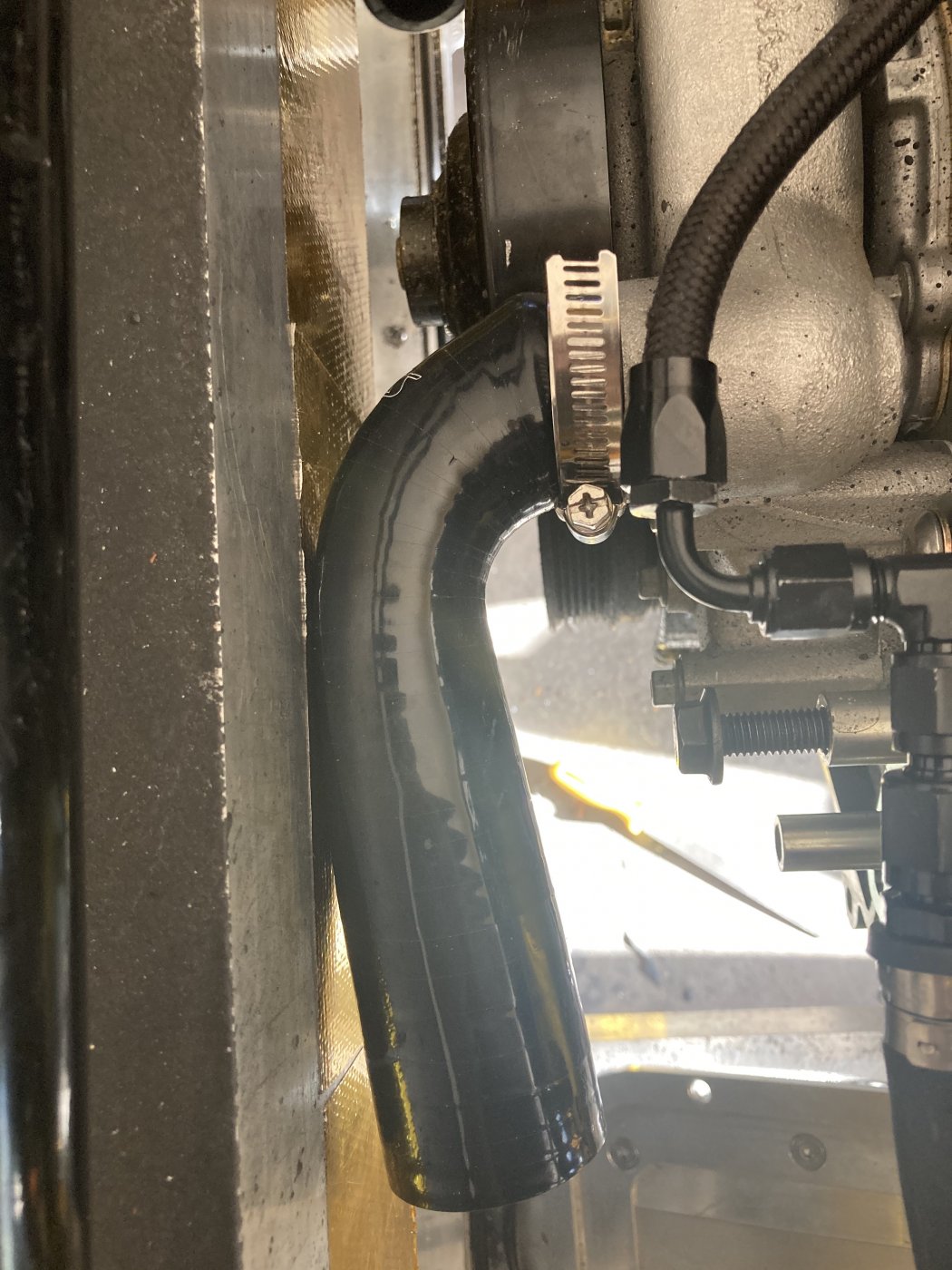

I also followed Cams lead on the PVC oil catch can on the dirty side , found a nice set of brackets to fit over the rear support bar. Very happy how it turned out , needed to use bigger screws, rethread the can, modify the holes on the brackets and trim the rubber a bit.
I did not have the right size oetiker clamps, so worm clamps will have to do for now. Now I feel better I accomplished a task. Keep on.
