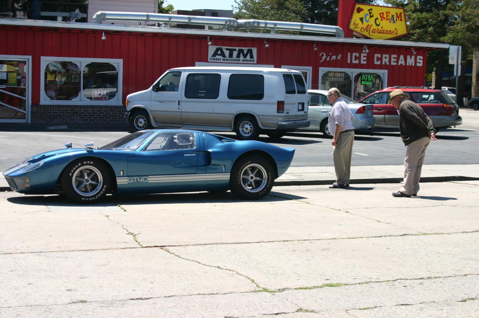

I have one of the early CAV GT40's and I have always felt that the rear end was a bit to high. Does anybody else have the same car that can give me an idea of a nice height from the rear quarter to the ground?

Sean, the rear of the car in your pic seems unusually high. You may want to see if there is a spring collar adjustment on the rear shocks and take some of the tension out of the rear shock springs. Of course make sure it doesn't let your tires contact the inside of your fender well in full compression.

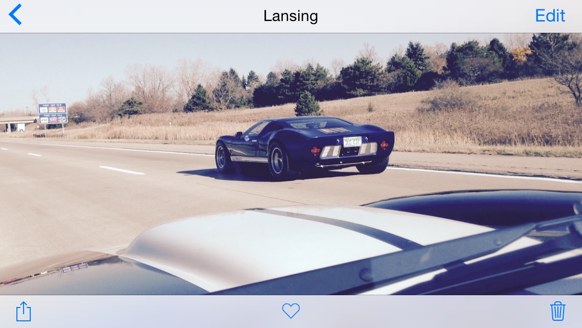

For what it's worth, here is CAV #04 for comparison.

Sean, I don't know about the ride height but those two dudes eyeballing your car are priceless!
"Ya know Earl, I've seen some ass in my time but what'ya have to say about this one?"
I own #08 and think you should be able to raise the spring seats to lower the rear. Just count the same number of turns each side if you don't have wheel scales.
