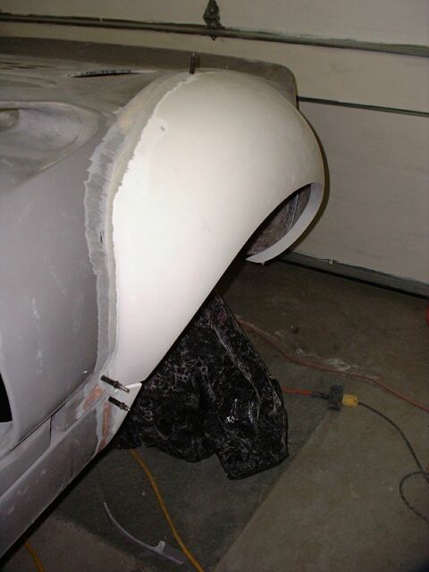

Here we have test fitted the fender flare, temporarily held it in place with three clecos, used a sharpie to mark the outline of the part on the rear clip, drilled holes from the inside out to define the location of internal bulkheads, and used a jigsaw to cut the old part out of the car.

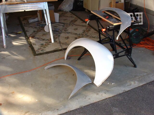

Here's a comparison of the fender flare we cut out and the new Gulf flare.

After some sanding of the opening in the rear clip to neaten things up, we put the flares back on with clecos and some body putty. After the putty dried we removed the clecos and Bill went to work with more sanding in preparation for fiberglassing. Note how bill has feathered the edge of the flare where it meets the rear clip; he has also "dished out" the rear clip such that there is a shallow trough at the flare-clip junction into which fiberglass mat will be laid.

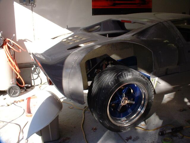

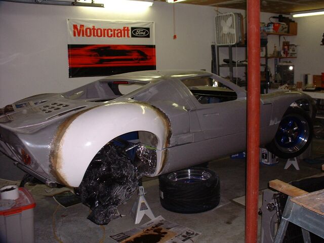

And this is the result of our day's work, after Bill had laid up the exterior fiberglass. He used torn strips of mat cloth and vinyl ester resin. He also wetted the mat cloth on cardboard and placed the wetted strips onto the car, rather than wetting dry strips on the car. I've done fiberglass work before, but I learned a lot from Bill.

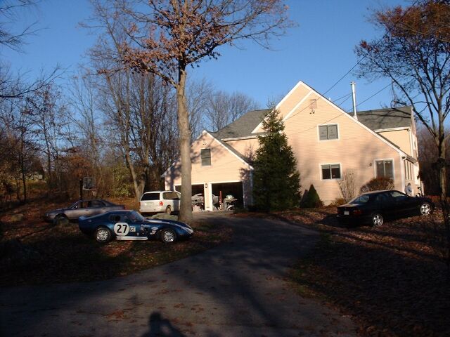

Remember that Daytona coupe I told you about, and how Bill is the guy who did the molds for FFR? Well, here's a picture of Bill's car in my yard. We kept the nice cars (Bill's Daytona coupe and my M3) well away from the garage because we kicked up a serious amount of fiberglass dust. I was able to relate to Bill a trick that Hershal Byrd taught us here on the forum...the use of a leaf blower to clean out a dusty garage in a hurry. /ubbthreads/images/graemlins/laugh.gif Now I'm going to go use that blower to get rid of a few million leaves in my yard. No GT40 for me today!
