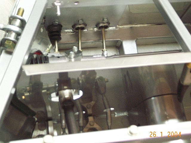

Thanks Mark, The pedals are tilton # TIL 72-6422A. I had to cut the back of the mount off and also had to separate brake & clutch so I could move them closer together. I purchased my car when Robert offered just body & frame along with glass, fuel tanks, & suspension. I wish I could have purchased the complete kit but I wanted to start on the build rather than save longer for the complete kit. It really hurt to cut the rack & master cyl. mount
out but I like the dual cyl. with the balance bar adjuster witch will be mounted behind the shifter.
Simon
http://racecareng.com/RCE/index.php?action=3&UID=2003120910263964.12.97.6&part_no=TIL72-6422A

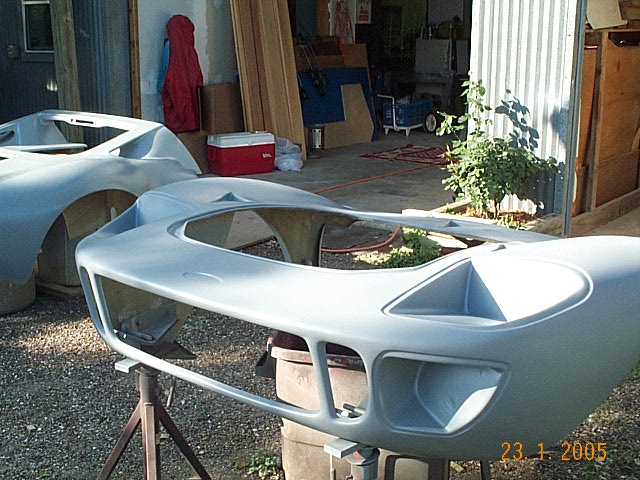

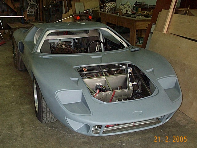

After lots of sanding I finally got two coats of primer on last week, just two more to go. /ubbthreads/images/graemlins/mad.gif

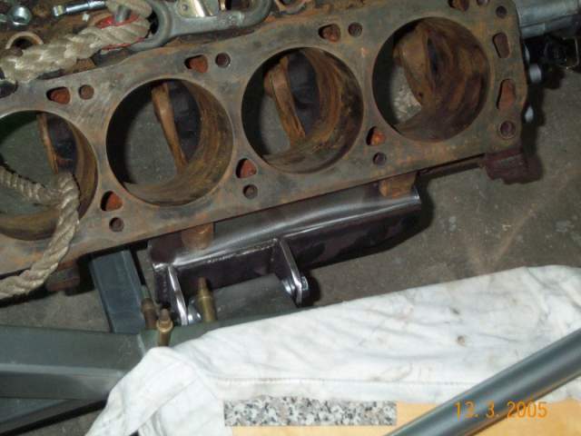

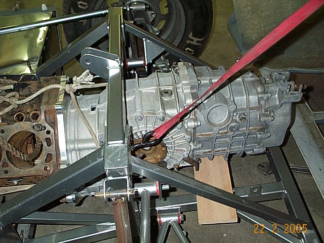

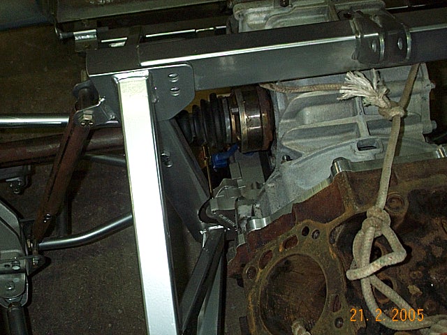

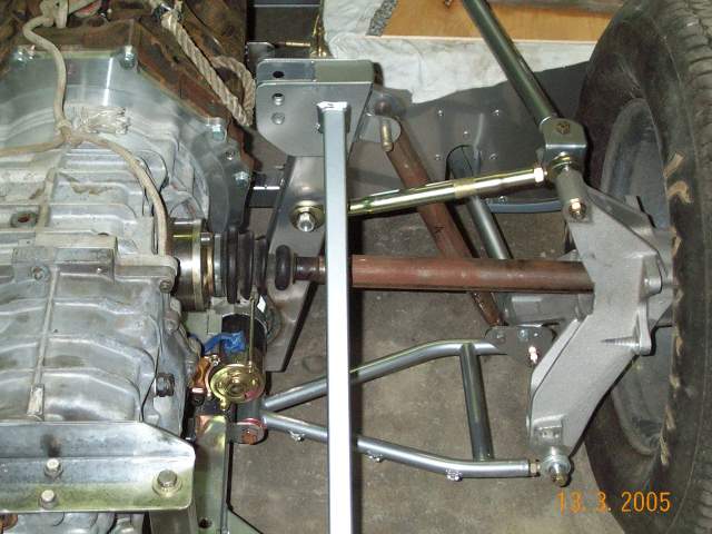

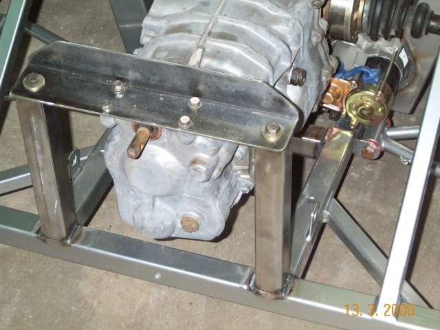

Installing the G50/50 will require some frame modifications for starter clearance.
Notch for starter plated and new upper control arms to clear axles.

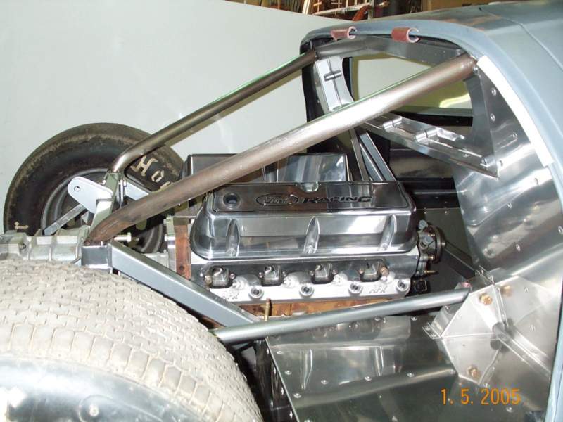

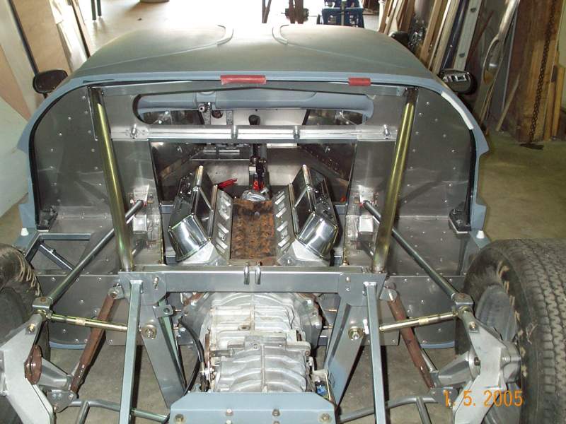

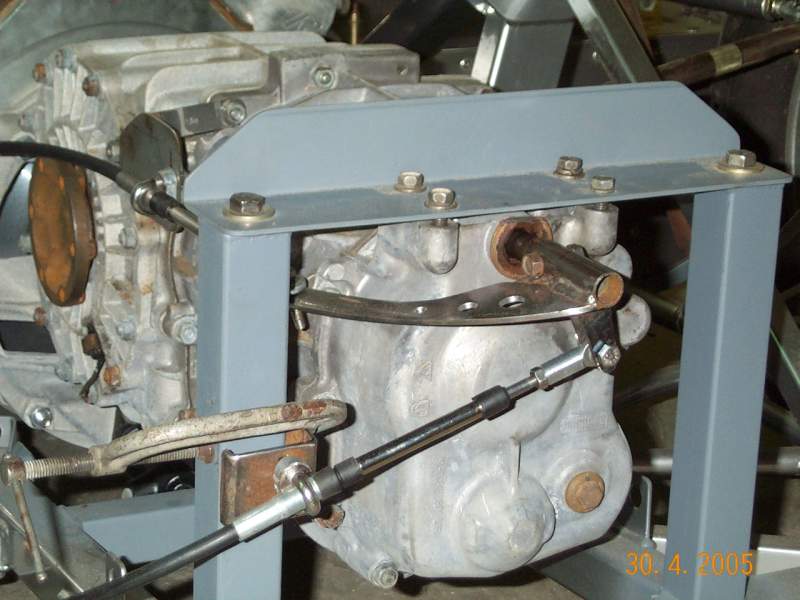

Shifter is almost finished and seems to shift nice, used 43 series morse cables. Engine should be finished this week, 347 roller, AFR 205 heads, Eagle forged crank, h-beam rods,internally balanced. Next project will be the headers, have lots of Burns ss tube and collectors but unfortunately most of it is to big, going with 1-3/4".
Simon
