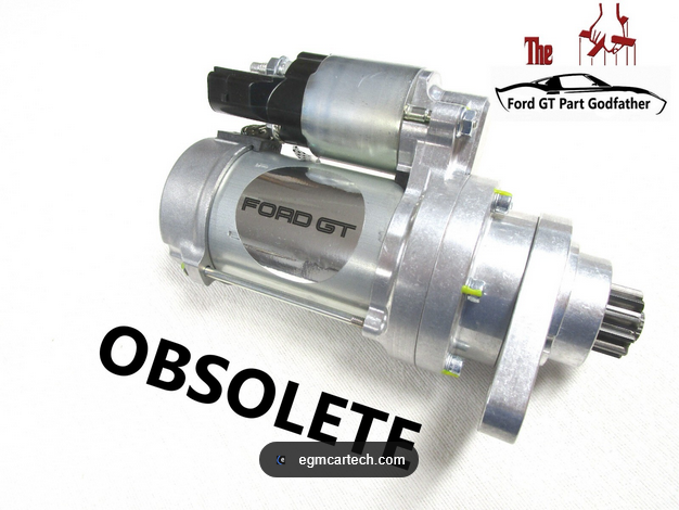

Also, I think it was Ken that found the correct starter motor connector.

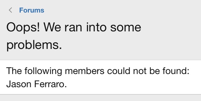

Jason’s current site is here. His build log is still on the forum also.
As Phil stated, put in JFerraro. Then include Ricardo in the search box. There are two pages of posts from Jason from about 2010-2013 about the Ricardo and his issues. His original website had much more and better information, but it appears it is not available anymore.
