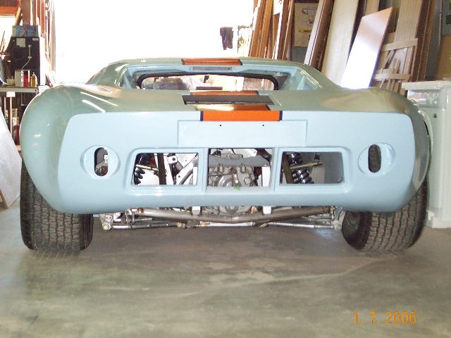

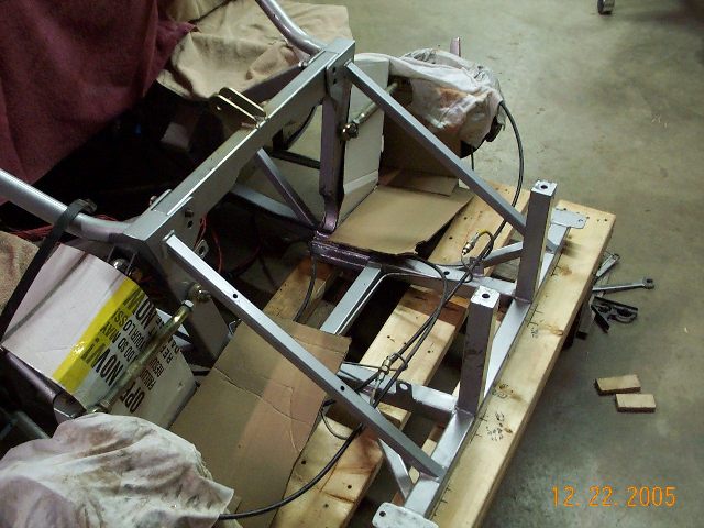

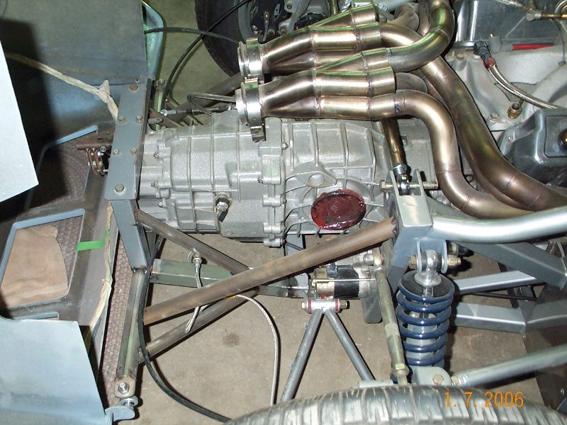

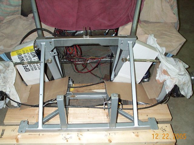

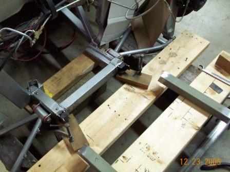

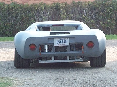

Mark, your right, I already made the modification to accept the G50/50. I just didn't like the square tube hanging down that low so I raised it and installed two 1/2" rod ends at either end, makes adjusting the body much easier.
Simon
Great job Simon , the "push bar" has been haunting me and I was thinking of doing a similar thing. It sure cleans up the back of the car in your picture . Regards, Dan
Thanks Dan, No more equalizer hitch. I just picked up the paint so I better get busy.

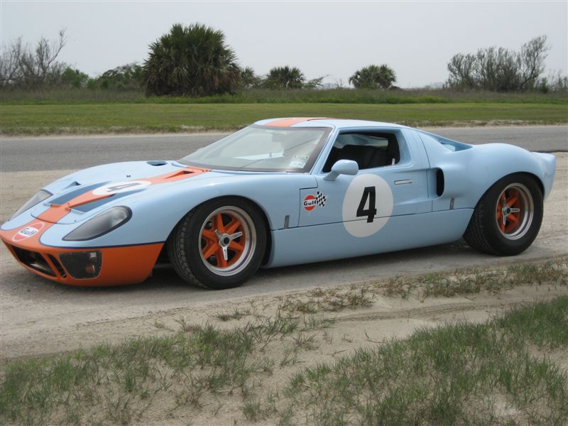

Still not quite finished yet but went for a drive yesterday. /ubbthreads/images/graemlins/banana.gif
/ubbthreads/images/graemlins/driving.gif
Simon

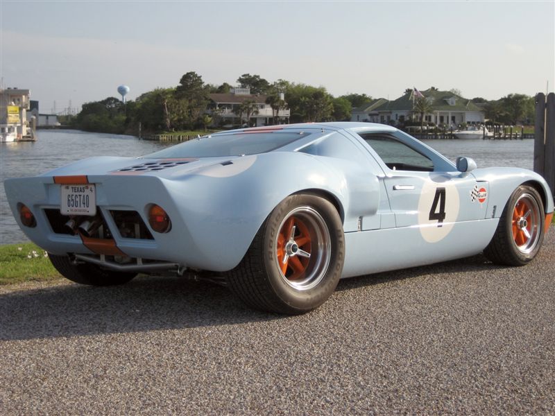

I want to thank Bob Lacy with Vintage wheels for for a great product. I wish everyone was as pleasant to do business with.
Simon
Beautiful car Simon. Nothing beats the Gulf cars for me.
Set nice and low.
Any problems with scraping road surfaces?
What clearances are you running?
Thanks John,
I have to tell you that when I started this dream several years ago I said that my car would never be painted the Gulf colors. But as time went on every time I looked at one it just excited me more than any other color.
As for the ride height, I started with 4" on the front and 4.5" rear but the springs seem to have settled some so will raise her up some more. It did bottom out a couple times on the front which is now at 3.5".
Mark, I still have to finish some of the interior, fire system and would like to find the side windows with hardware.
Simon
