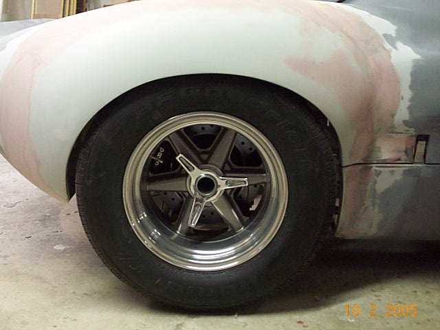

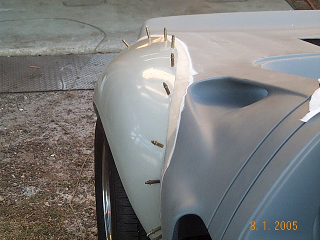

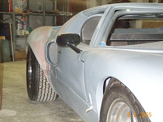

S Simon Jan 9, 2005 #65 Installed wheel flares this weekend. /ubbthreads/images/graemlins/cool.gif Attachments 49986-Flares1-08-05003.jpg 96 KB · Views: 723

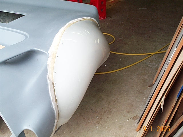

S Simon Jan 9, 2005 #67 Used pop rivets to hold flares till glass kicked off. Attachments 49989-Flares1-08-05009.jpg 96 KB · Views: 596

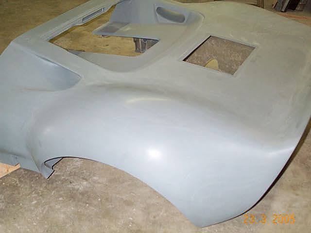

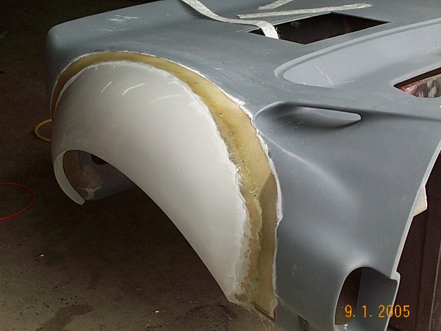

S Simon Jan 9, 2005 #68 Feathered edges and glassed seam. Strange, everyone that came by today didn't stay long. /ubbthreads/images/graemlins/blush.gif Attachments 49990-Flares1-08-05010.jpg 96 KB · Views: 608

S Simon Feb 8, 2005 #69 Finished the flairs about 3 weeks ago, want to get some primer on but it just keeps raining. /ubbthreads/images/graemlins/confused.gif Attachments 51901-Nostril2-8-05013.jpg 96 KB · Views: 630

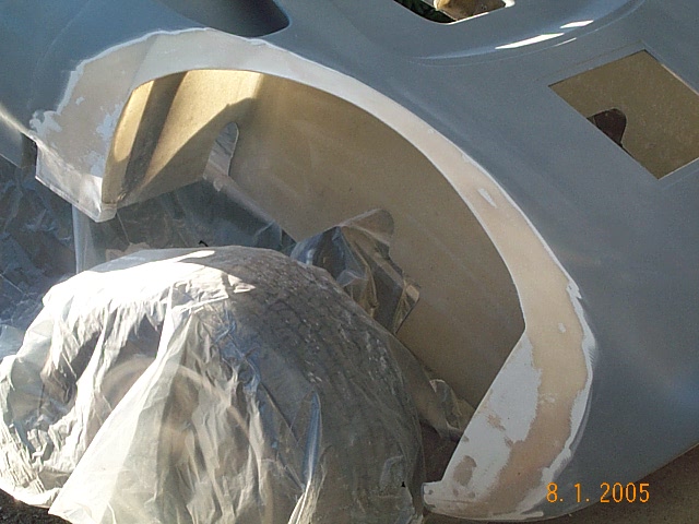

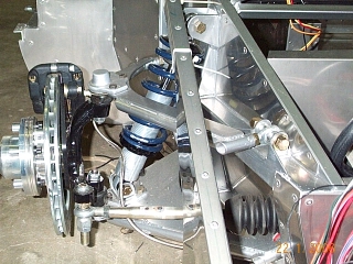

S Simon Feb 8, 2005 #70 More glassing& sanding. Attachments 51902-Nostril2-8-05010.jpg 64 KB · Views: 611

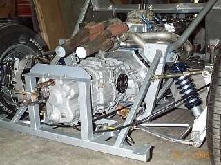

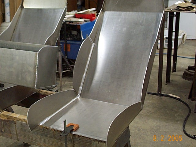

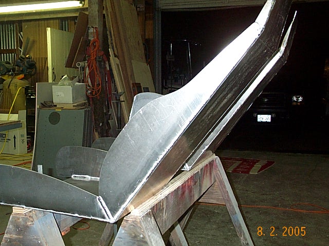

S Simon Feb 8, 2005 #71 Started on the seats last night. Just a few more pieces and welding. Attachments 51903-Nostril2-8-05007.jpg 64 KB · Views: 634
F Bill Bayard Feb 9, 2005 #73 Simon, Could you throw a completed seat on a scale, when they're done? I'm curious about weight...fiberglass vs. aluminum. Thanks! Bill

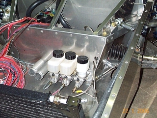

B Bill D Feb 9, 2005 #74 Simon- Your car looks great, and progressing nicely. How big a wheel/tire can you fit in the rear with the Gulf flares? Thanks Bill D
S Simon Feb 10, 2005 #75 Bill, Finished the seats tonight and they weight 12 lbs. I made them out of the 1/8" marine grade alum. that I had left over from the floor pan.

S Simon Feb 10, 2005 #76 Bill D, I have 10"x15" vintage wheels with 295/50/15. I think with the right offset or backspace you could probably get 12" to fit. Simon Attachments 52058-2-10-05006.jpg 64 KB · Views: 625

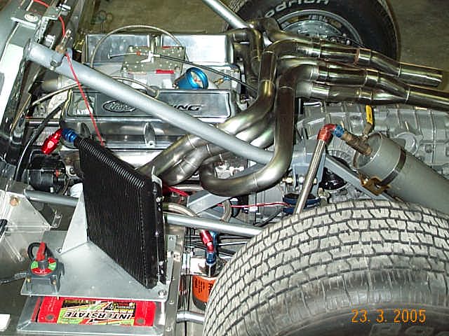

S Simon Mar 23, 2005 #79 We are off to Kentucky, Chicago and on to see family in StCatharines Ontario. Will have to wait to fire the engine up when we get back. Attachments 54663-3-23-05003.jpg 64 KB · Views: 643
