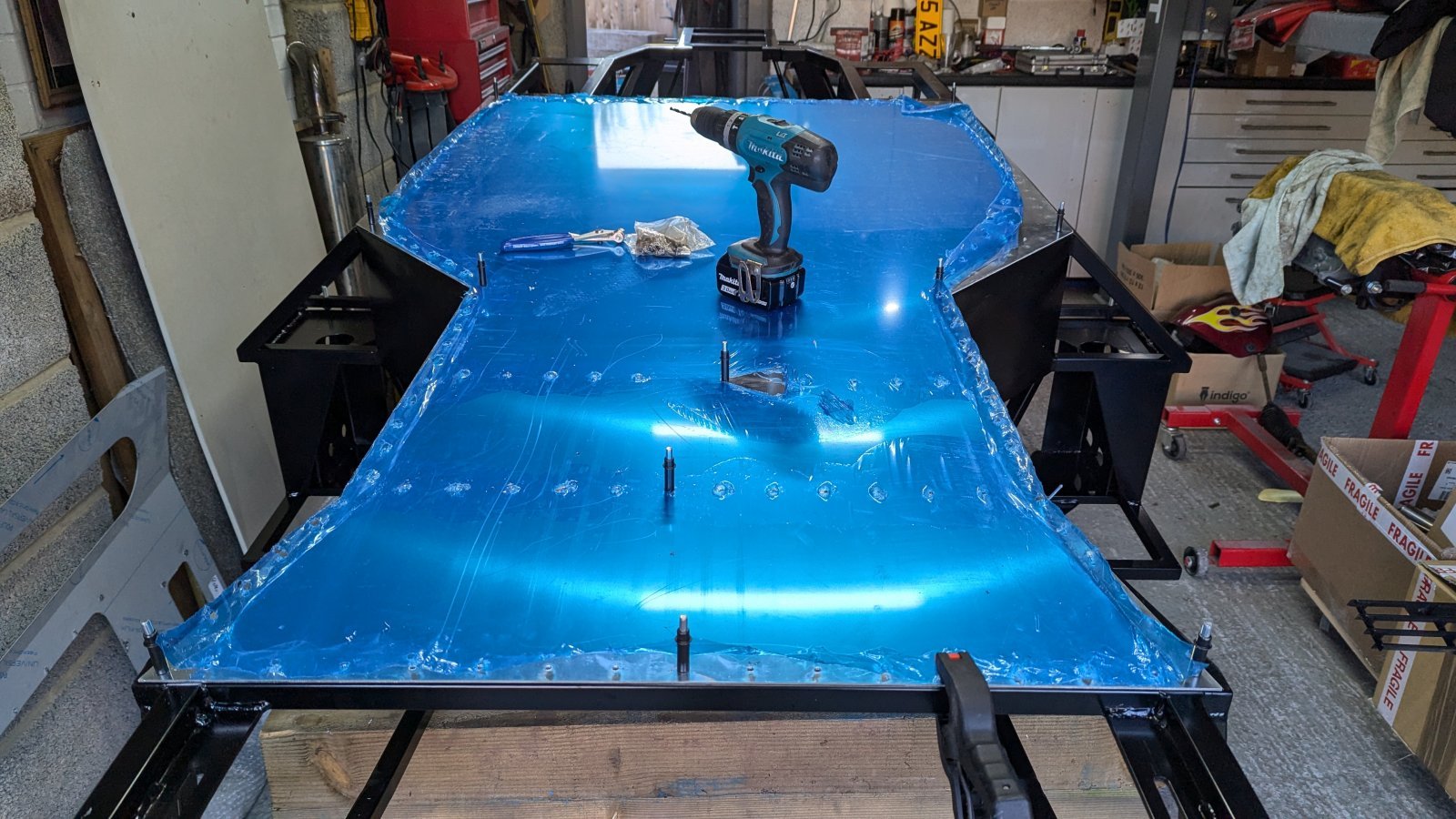

Anyway, I finally managed to make a start on the new project. The first job is to fit the floor. In order to do this I had to turn the chassis upside down. Luckily my son was around to help me again. However, we both agreed the that it was somehow much heavier than before! Anyway, all done and time to mark out and drill all the holes.
I'm going to take it off tomorrow and be-burr everything. I'm probably not going to fit it permanently yet. I suspect I may need to add one or two inspection hatches for the coolant pipes that run down the centre of the car. I can fit the floor later in the build but it'll be easier to make any necessary modifications with it off the car.
At least all the holes will be ready when it is time to fit.

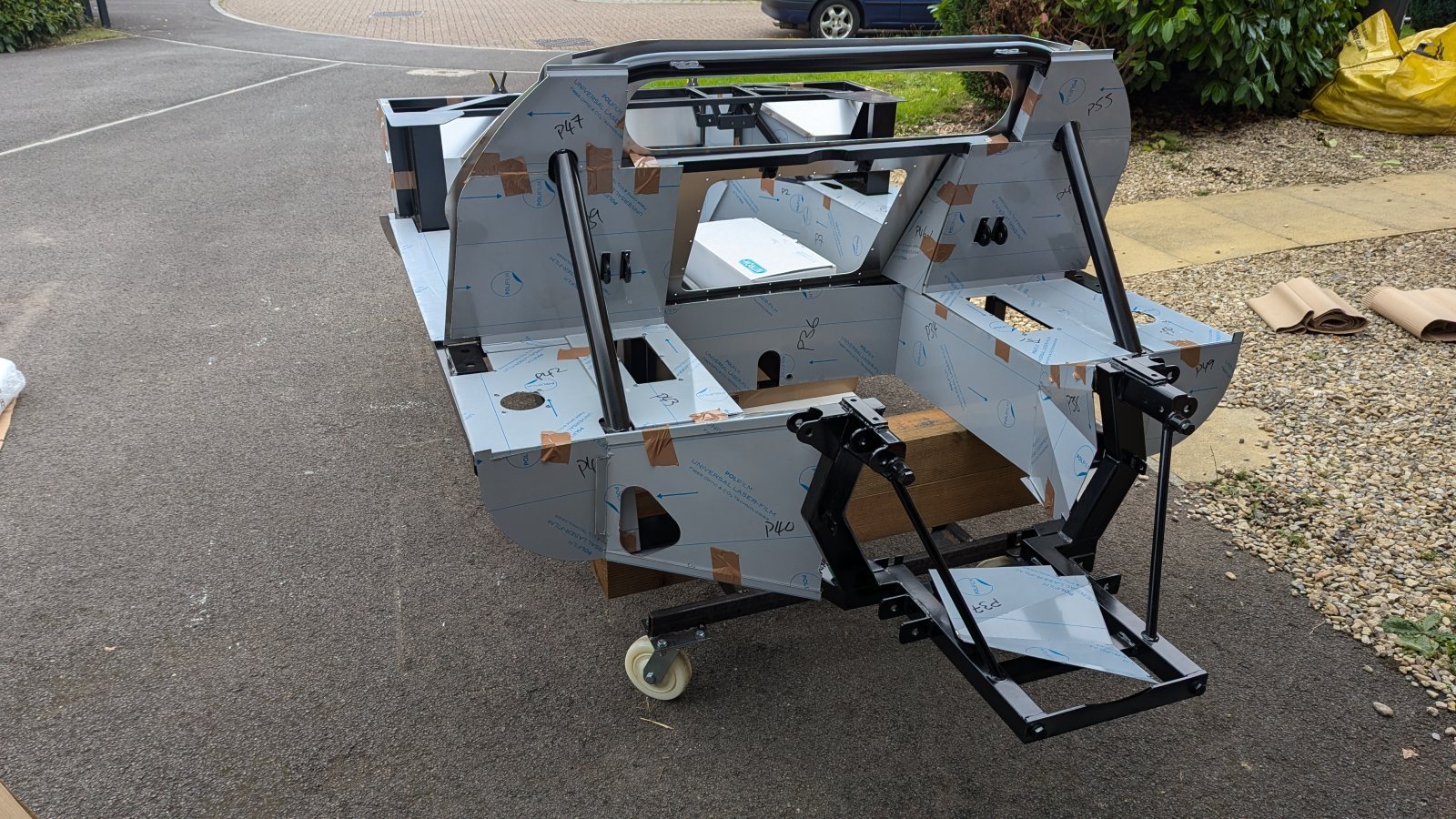

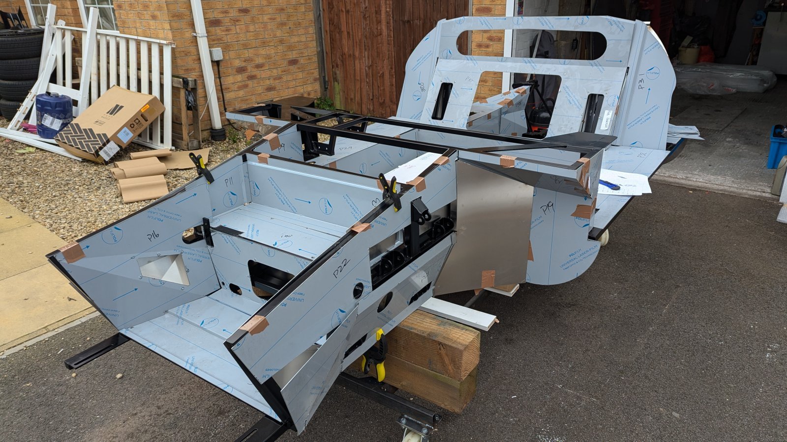

I manage to make some more progress on the car.
I finished drilling all the holes for the floor, removed it, be-burred and sprayed some rust protector into the holes to protect the inside of the chassis. My son was called in once more and we managed to turn the chassis over again.

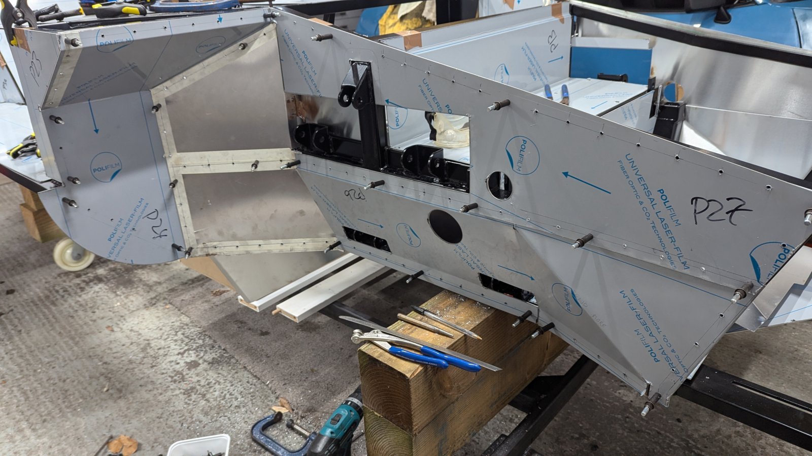

I have spent the afternoon trial fitting dozens of panels. What fun trying to work out which strange shaped aluminium panel went where on the chassis (no instructions)! Some of the panels fit well but many will require fettling and re-shaping. I've just taped them on for now. My plan is to work my way around the car over the next few weeks working on one section at a time to make sure all the interlocking panels fit together correctly. I'll then drill fixing holes and Cleco pin everything on. Like the floor, I may decide not to permanently fix the panels just yet, but we'll see.
Sorry, it has been ages since I last updated this build log.

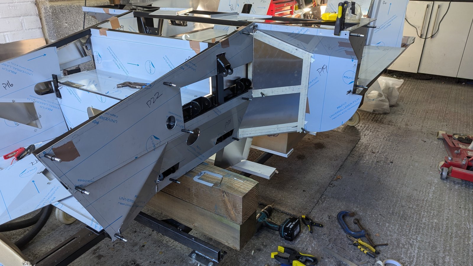

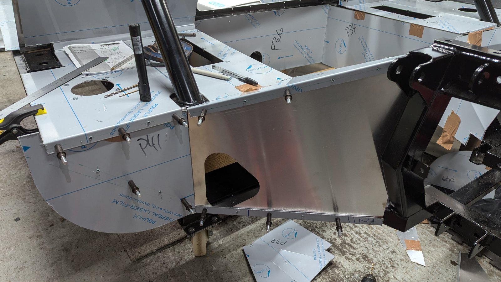

I have been trying to get the panels on the OSF of the car marked out and fitted. The panels in this corner all fit together and overlap. It requires working in a sequence otherwise they won't fit. Each requires small modifications to line up correctly. I've held everything on with clecos for now. I still have to drill most of the rivet holes.

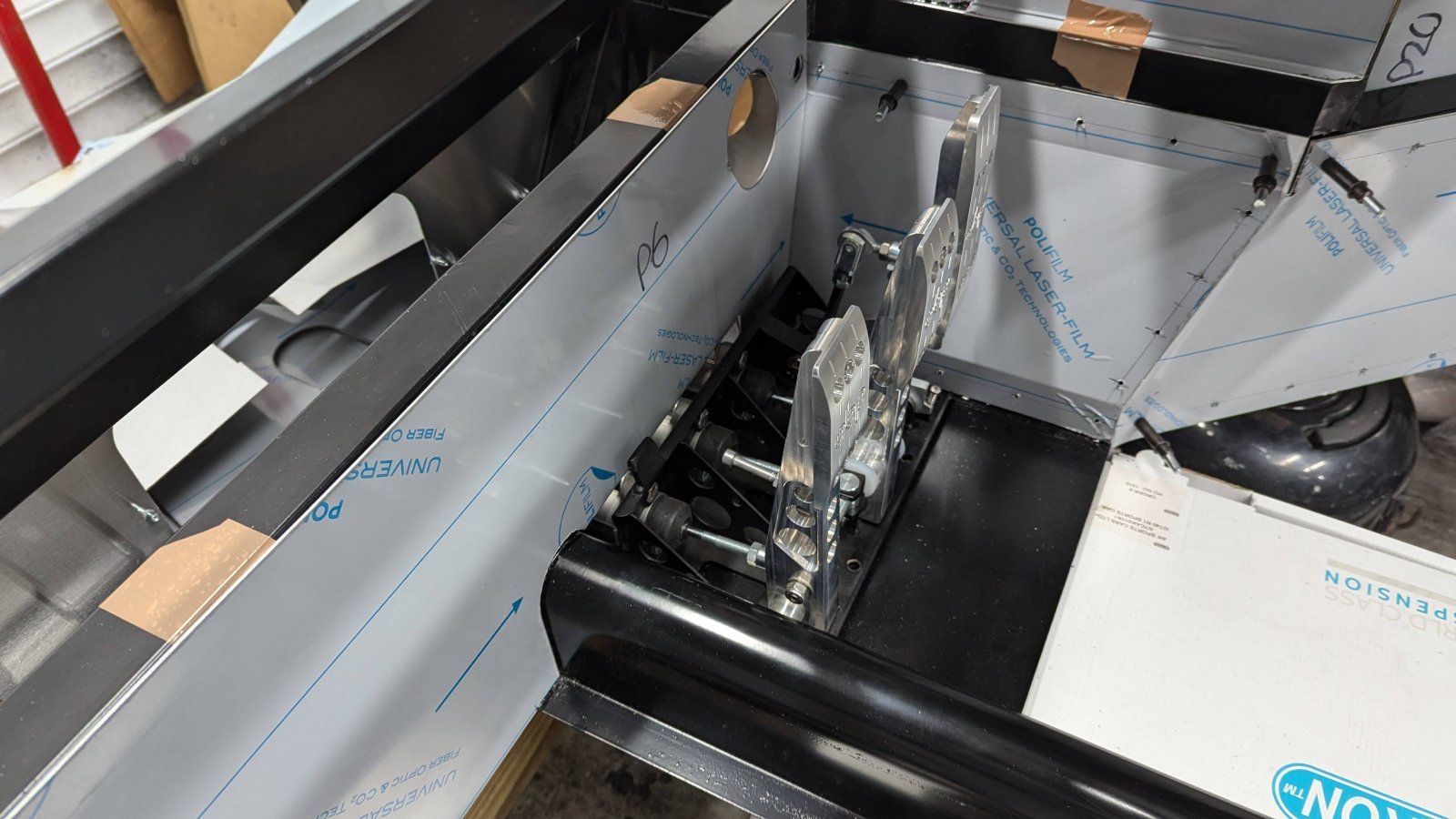

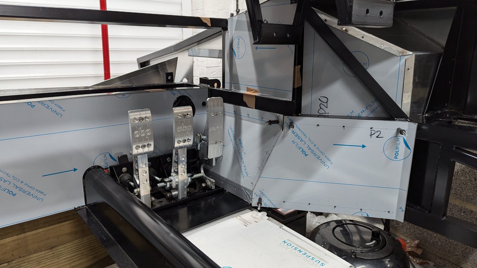

I have modified the area in front of the pedals. I got AK to make a change to the chassis in this location which allows me to mount the pedal box 75mm further forward. In the new position, the pedals still have full travel which will be important for the IVA.

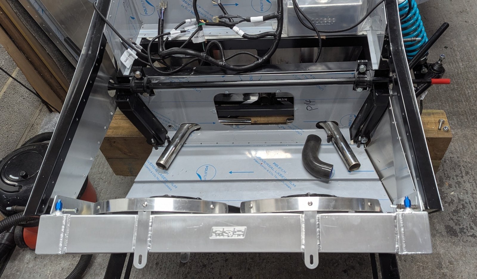

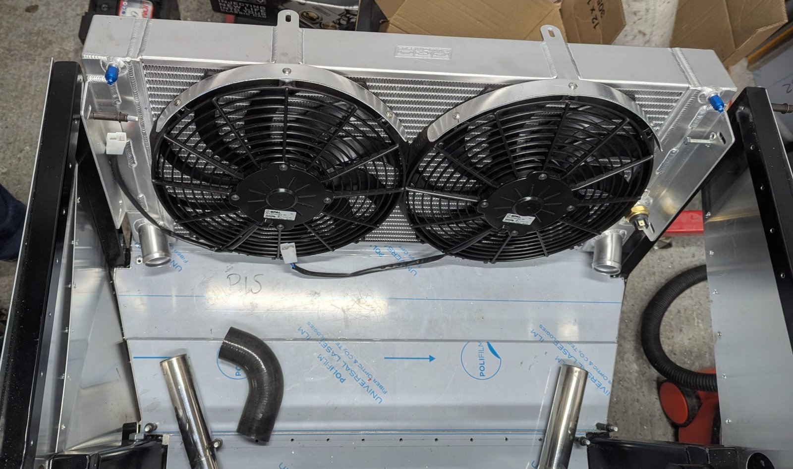

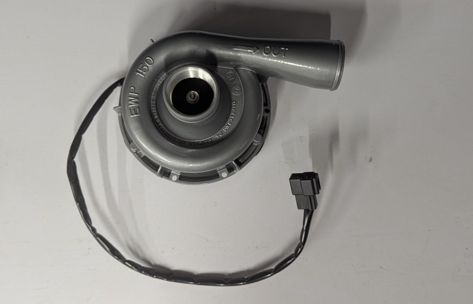

I will be using an electric water pump located at the front of the car. The pump is controlled by its own ECU which also controls the radiator fans. My engine will not use a thermostat. Instead, during warm-up, the water pump cycles, on for a few seconds then off for a few seconds. The duration of each on or off period is determined by the ECU. The pump and fans can, if required, also run when the engine is off to reduce heat soak.
I am also looking at feeds to and from the cockpit heater to be taken off the coolant circuit at the front of the vehicle (either side of the radiator). This will remove the need to run additional coolant pipes down the length of the car from the engine.

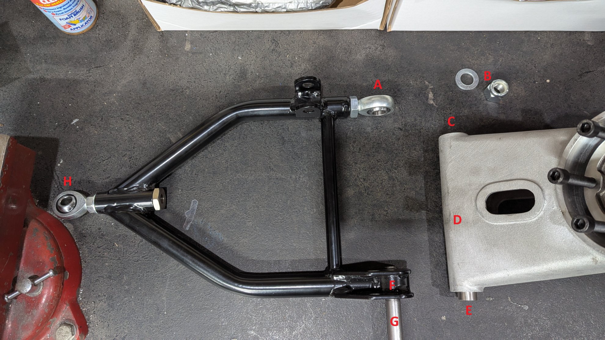

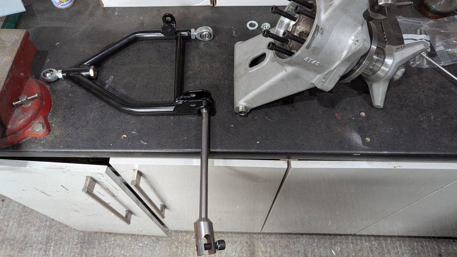

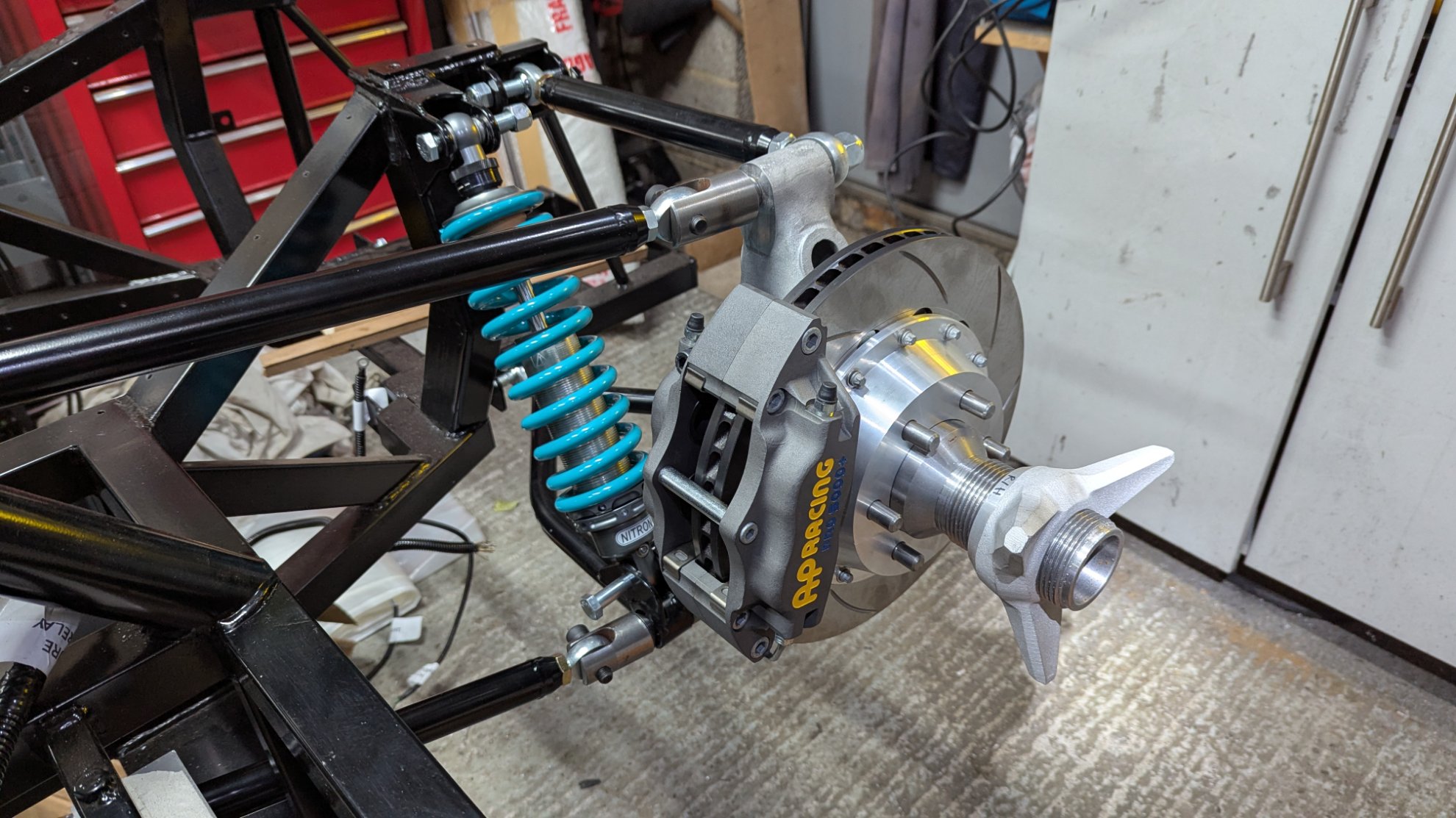

I have been having some fun assembling the rear suspension on the car.
In the picture you can see the NS rear hub assembly and the lower wishbone. Just to explain: -
- The wishbone is attached to the chassis at Point H.
- The rear hub/upright is attached to the wishbone with bar G.
- Bar G goes through a spherical bearing inside the wishbone at Point F.
- There is a bush located in a machined recess inside the hub at Point E (visible) and another at Point C.
- There is a hole bored all the way through the hub D which has a smaller diameter than the bush recesses.
- Once through the hub, Bar G goes through the spherical bearing A and is finally secured using Nut and Washer B.
Got all that!!? :p

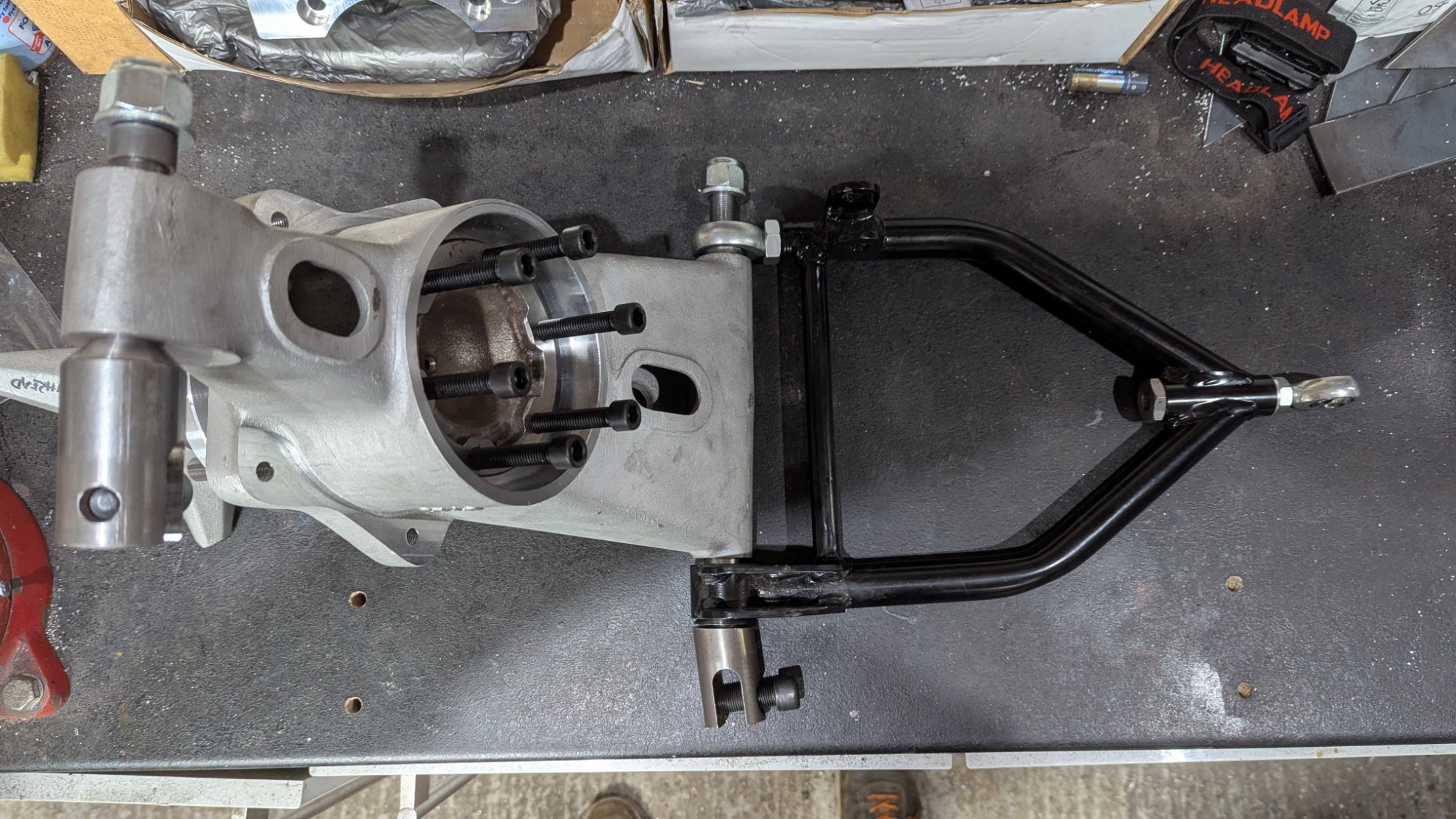

The problem I had was Bar G wouldn't fit through F. It is close though. Nothing that a little work with some Emery paper couldn't solve.
Here is a view zoomed out a bit.

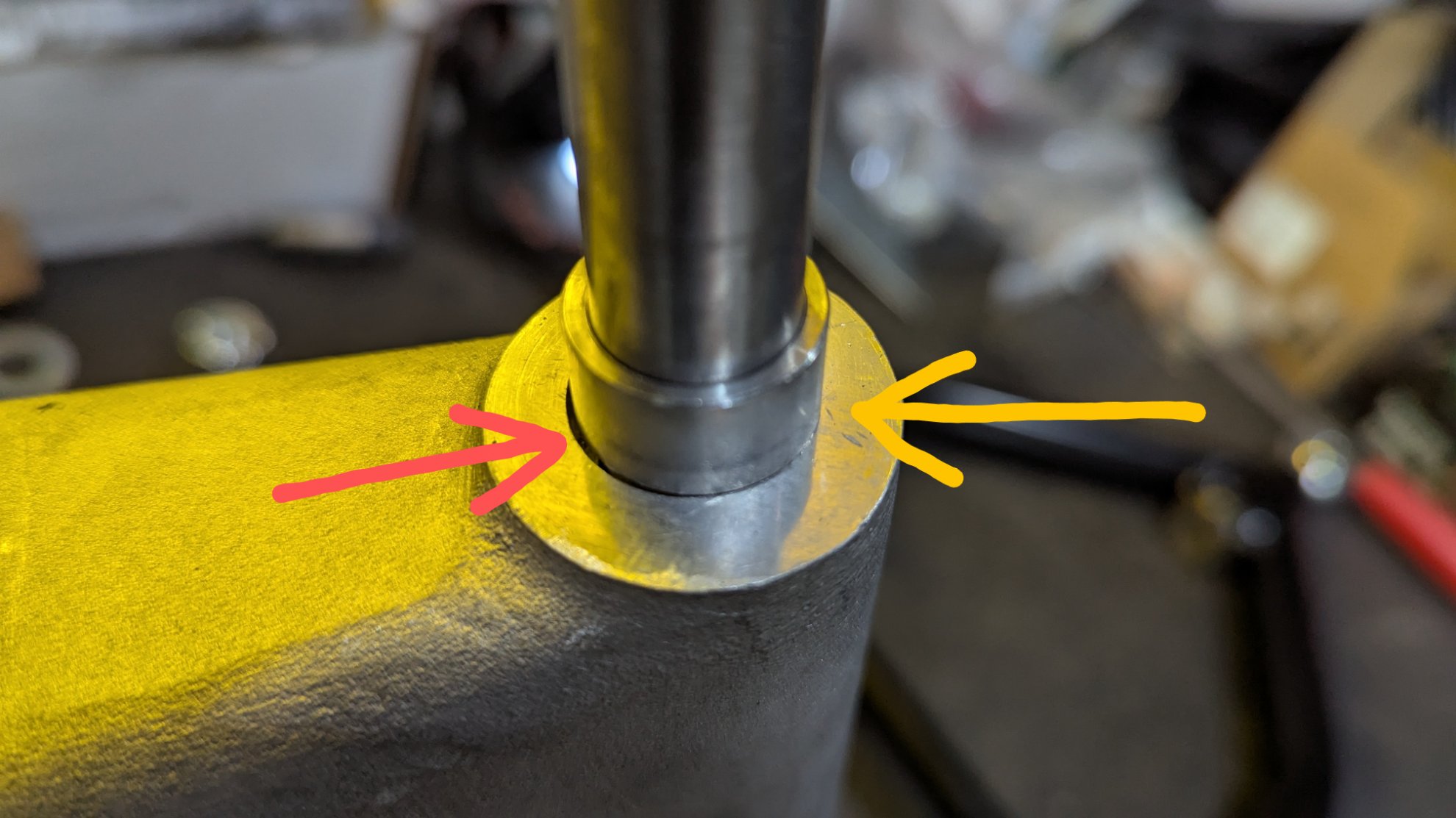

What I found next was although the bar would go all the way through the hub without the bushes fitted. However, if I fitted the bushes E and C (as required) and then tried, then the bar jams about halfway through. There were two reasons....
Firstly, the recess for the bush and the hole all the way through the hub, were not quite concentric. As you can see in the photo below, there is a gap on one side (red arrow) and an overlap on the other side (yellow arrow). This was only at Bush E. Bush C was perfectly concentric.

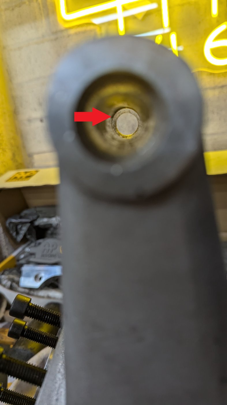

The other thing I found was the hole bored all the way through the hub must have been cut from either side. Where they met in the middle was not perfectly aligned. It was very, very close but enough to jam the bar due to the offset from the bush at E. Here is a photo.
Sorry, about the quality. I struggled to get my phone to focus at the right point. You can just see the issue at the red arrow.
In the end, I managed to solve the problem by slightly opening up the hole all the way through the hub. I was careful not to touch the area where the two bushes fit as this is how the rear hub is precisely located. However, the exact diameter of the hole through the hub is not important so long as it is less than the bush mount point.
Ideally, I should have used a reamer to open it up slightly. As I don't have a suitable one, I got a bar of a smaller diameter than the hole, cut a slot in it and attached some Emery cloth. I attached that to an electric drill and ran it up and down in the hole a few times. It quickly did the trick and I was able to fully assemble the parts.

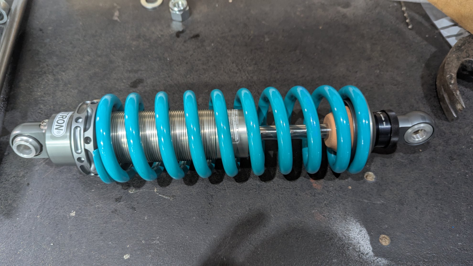

The next task was to fit the assembly to the car. This went OK with one small problem. The bushes in the end of the damper were too wide for the slot in the lower wishbone.
This was actually very easy to resolve.
The bushes in the other end of the damper were narrow enough. Nitron say I can mount them upside down if necessary. In fact, doing this actually reduces the unsprung weight in the suspension.
However, it didn't look right to me. Swapping the bushes is really easy. They come in two halves and can be knocked out with a suitable drift.
Finally, I test fitted everything on the chassis.
The hubs have provision for knock on wheels. The threads are handed; right hand thread on the nearside, left hand thread on the offside of the car.
I have added the brakes too. I need a separate caliper for the handbrake - watch this space. ;)
