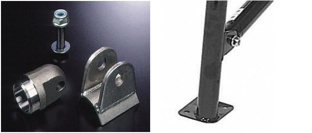

As promised here are some pics of my cage for consideration. My head at all times cannot reach any of the bars, nor are they near any body parts. You will notice that the rear bars will be behind the seats side edges
This support piece is done with a regular bolt and nyloc. The bolt head is ground down to ft into a slight recess under the leather so it doesn't show.
