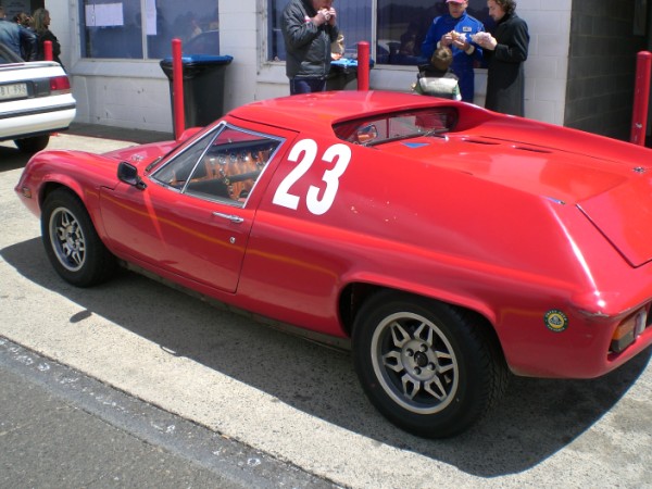

Ok so what am I doing at the track in my Lotus Europa and not Gt40.
Well firstly it is a Lotus club track day and 2nd, they only allow noise levels at 75db. Pretty hard for the GT40 to keep the noise down to that level. So here is my rational. The Europa has the same driveline layout as the 40 and I'm hoping to be able to use it as a guide for driving the 40 better. The handling is a bit too sloppy at the moment but I can feel similarities in the handling of the 2 cars. I forced the cable shifter a bit too hard on Saturday and broke it, but luckily was able to repair. Lap times are 20 secs slower than the 40 but am hoping to get Europa down by another 10 secs.I'll pass on more
info as I improve the handling.
Ross

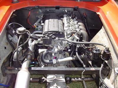

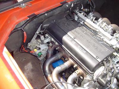

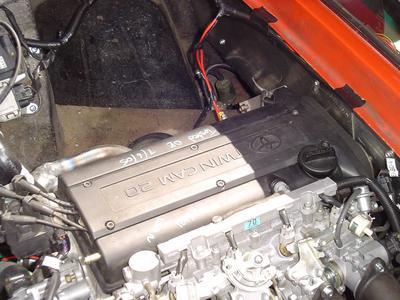

Pics as requested
Ross Nicol
Sorry Ken forgot to answer your question.You are right early Europas had an 80hp Renault motor (wow) and later cars had the twin cam.This car of mine had the Renault and it was blown and in pieces. I decided it was a better boat anchor so in went the Toyota which has 165hp and revs to the sky.

Dalton- I do love the contrast between the GT40 (the Brute) and Lotus Europa (light weight lady).
Dave L- how is the progress on your Europa? I have some suspension work to do on mine. These cars are a work in progress as you probably know owning more than one Lotus.
Jos- nice to make your aquaintance, I'll pass on the photos as I have a lot already, thanks for the offer.
FRP guy- I've replaced the stub axles with BMW units 2002 model. Also disc brakes on the rear. I was only taking the revs to 7000 on the track day but have found out the Toyota makes power right up to 7800 and redline is at 8200. I'll have to get a rev counter that goes up that high. I hope the transaxle input shaft can handle these revs. I don't think the Toyota motor has enough torque to be a problem.

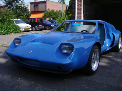

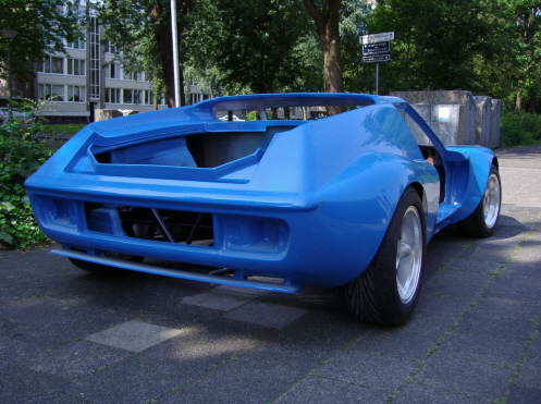

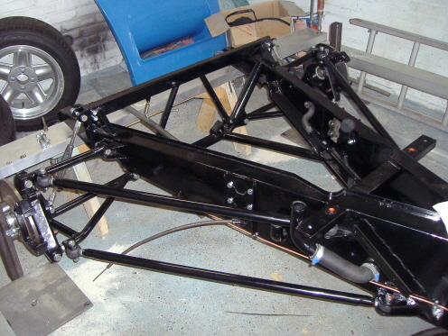

hi ross, nice to see more people race there europa's I am building a banks 62 europa (poor man's gt40) 210hp 7800 red line hope it will fly too one day, did my own chassis and suspention (more like a gt40 at the rear) ng3 box and esprit bearings/brakes

hub's, arm's, chassis, all an diy job
hope you like the pic's
greetings rick

Ross Nicol
Hi Rick
I'm not sold on the square headlights yet, they will grow on me, but the rear end is superb looking.The chassis is great too and how long is that lower trailing arm. I did help a guy over here who had painted his green, had a v6
Vauxhall motor in it with a strange aftermarket computer I tried to help him get going but wasn't very user friendly.I think he probably replaced it with a Motec computer as Motec is based here in Melbourne. In fact I was at a meeting with the CEO of Motec last night.
Keep up the good work.Now shouldn't that car be orange Rick?
