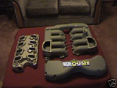

I haven't been able to take measurements yet, but I think I now have to solution for the problem of getting enough air into a high RPM Dart based engine. I have just purchased a Rousch '94/'95 Cobra intake. Here are some pictures

Lynn,
If you are looking for max power on a large engine, you might also want to take a look at the EFI Spyder intake manifold from Coast High Performance. It uses an Edelbrock Victor Jr. modified for use with EFI and has a very good reputation with racers.
Here is the link: http://www.coasthigh.com/Fuel%20Injection/spyder.htm
Click on Products at the top of the page to see more.
You can use one of my intakes, Craig Hassler has one on his 347 that made 617 HP at 9200rpm. Dart block, Oliver billet rods and crank, ported AFR205 heads, VCP stack intake, mechanical roller cam, shaft mounted rockers.

The engine that I plan to build will be a 302 with as light a rotating mass as I can afford and the same with the valve train. There are some kits out now that will let you run shaft mount rockers even on heads that say "No Shaftmount." I have had a couple of suggestions on custom cams and I already have a guy near Charlotte who builds NASCAR engines who I going to do the final honing on the Dart block and put it together for me. This is phase III for the car and will be done over time to spread the cost out. But this intake was kind of like the G50/50: not something you run across every day and I wanted to grab it while it was available. It was about 1/5 of the cost of your type of outfit Wayne. I like the look of the stack injection and the flow, but I like the ability of measuring the airflow on this intake and running a MAF system. Another thing is that if I decide I want to play with a turbo it will cake to hook up on this intake. The other option, the dual plane carb type manifold with and EFI elbow on it just doesn't suite my liking. Heads will be AFR 185 or equivalent (ported 165s w/bigger valves.) Phase II will be AFR 165s, GT40 shortened intake and a FRP X303 cam on a stock block. I am going to put in some Keith Blacks to try a set of Edlebrock Performer RPM heads with the 2.02I/1.6E valves just to see what the dyno numbers look like between them and the AFRs. Both sets have been milled to give ~10:1.

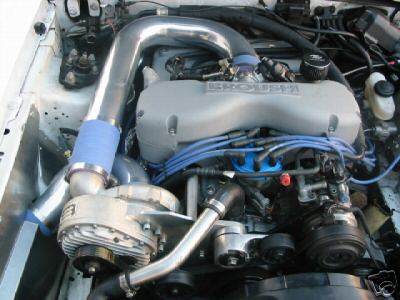

Sounds like you have quite a motor planned for phase 3. If you do turbo it, please post some pictures, I would love to see the layout.
