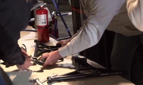

Was wondering why they used their own LCA. Here is a pic of it.
attachment.php
That was the LCA that broke on the SL-"Eagle". The video shows clearly that is the car it came from. Doesn't look like anything Fran puts out, that's for sure.
Correct...
The crew chief wanted to run the car lower and the way they chose to do so was with a lower control arm of their own design and manufacture.
Unfortunately one broke and another was damaged during an "incident" with another car....the car was obviously working pretty darn well as it was bloody fast and running very strongly even with their issues.
