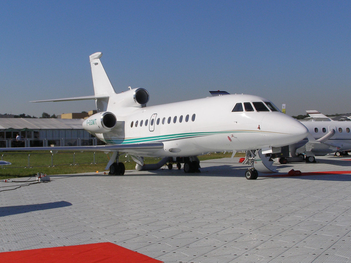

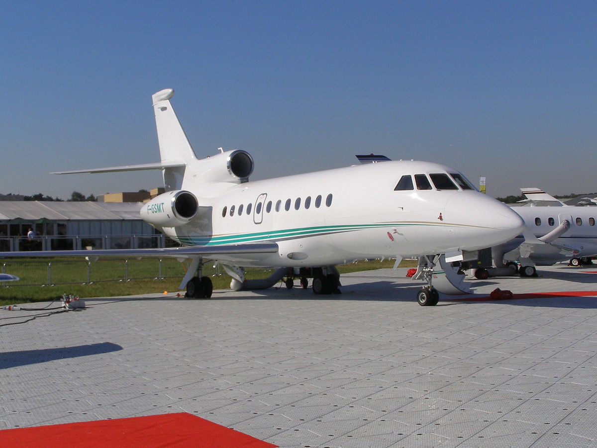

What you describe Larry is exactly how the Main and Nose LG wheels are attached on the 65,000lb Falcon 900LX I Crew chief. The axles and wheel nuts have multiple holes to ensure hole alignment at torque up with multiple sets of wheels and nuts. The Allen screws are steel with a steel locknut. A thread file would easily clean up the axle threads
If you modded your car this way you’d never have to worry about a wheel exiting the car while driving!
