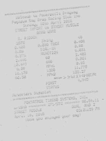

Paul got it pretty much bang on! I'm 'quick' but not 'very quick', 11.770 @132.27 mph, nevertheless got four wins out of four runs.
First three runs were in Lane 1 at about 12.1 and 130 mph but there was remains of an oil clean up from a blown trans at about 100m and I had to get out of it momentarily each time as it got very sideways.
The last run I managed to get Lane 2 and got the best time as the car stayed straight. It doesn't hook up very well compared to regular drag competitors but seems to go not too bad once it gets rolling. Have posted the actual time slip below. Here's what it says in case you can't read it
0.000 TREE--- .400
DIAL IN------- 0.00
REACTION---- 0.031
60 -----------2.402
660---------- 8.061
MPH1-------- 0.00
1320------- 11.770
MPH2----- 132.27
= = > >WINNER
FIRST ------4.945
STATUS
Autostart Disabled
Went out to have fun and didn't bother to alter the circuit race settings.
Only one gearchange, launched at about 4000 rpm in second had to control a bit of wheelspin, hit third at about 95mph and went through the traps almost on the redline. Fluked out on the ratios I guess...
So that's drag racing, been there done that, cross it off the list!
Thanks everybody for the advice.
Russ Noble
Some how the actual time slip fell off the previous post

Congratulations Russ! :thumbsup:
Back when I used to run my dragster I used to characterize drag racing as;
Hour upon hour of boredom, punctuated with moments of sheer terror..
Glad to hear that it went well for you!

Nice one Russ - :thumbsup:
I'd say that was a great result and certainly upheld the '40' flag....
Best Roy's 40 managed was an 11.8s at 132mph although that was on a road at Brighton Speed Trials and not on a prepared surface - although we did have slicks on.
