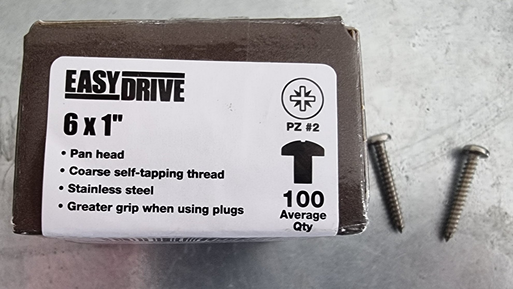

Just started to fix my hard brake lines to the chassis running from front to back, I thought I would use these Stainless Steel self tappers but I have had two where the thread has gone either installing or removing and when thread goes they are very difficult to remove
I've tried a slightly bigger drill but then they are too loose
They just dont seem very strong
I can't go much bigger as these are going in a double pipe clip in the centre
Is Stainless just to soft?
Any suggestions please for UK Type and Source?
Thank you

My thoughts. The self-drilling screws work okay. IMHO, the hole that is drilled with these is slightly too large to promote a tight enough thread to allow good torque with the fastener in thin sheet (or aluminum sheet). The original self-tapping screws on the first post, work great, IF the right pilot hole size is drilled. So, I like the originally posted screws for thin-gauge sheet metal, and the self drilling for thick-gauge sheet, or steel tubing. With that said, SS fasteners nearly always gall in the original post, whereas a good plain steel screw usually survives the thread creation process.
