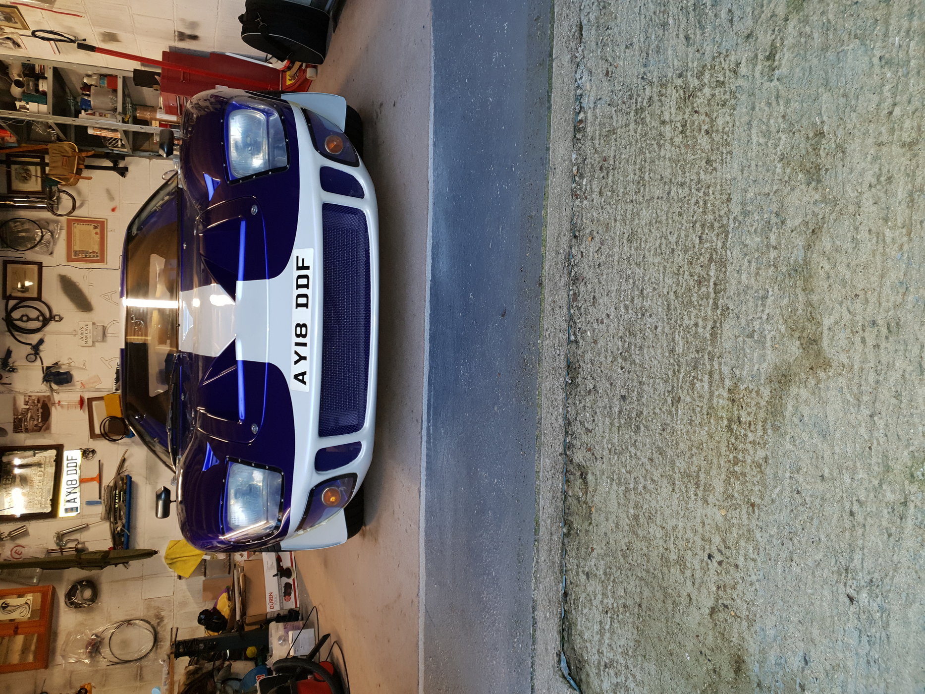

Hi All i have fitted front Canards and at speed i can feel a difference . but just poodling about the front wants to go with road lines ruts and just doesnt feel right bit twitchy . What have you guys and gals set your front ends at .......... Any help would be great thanks ..
John.
