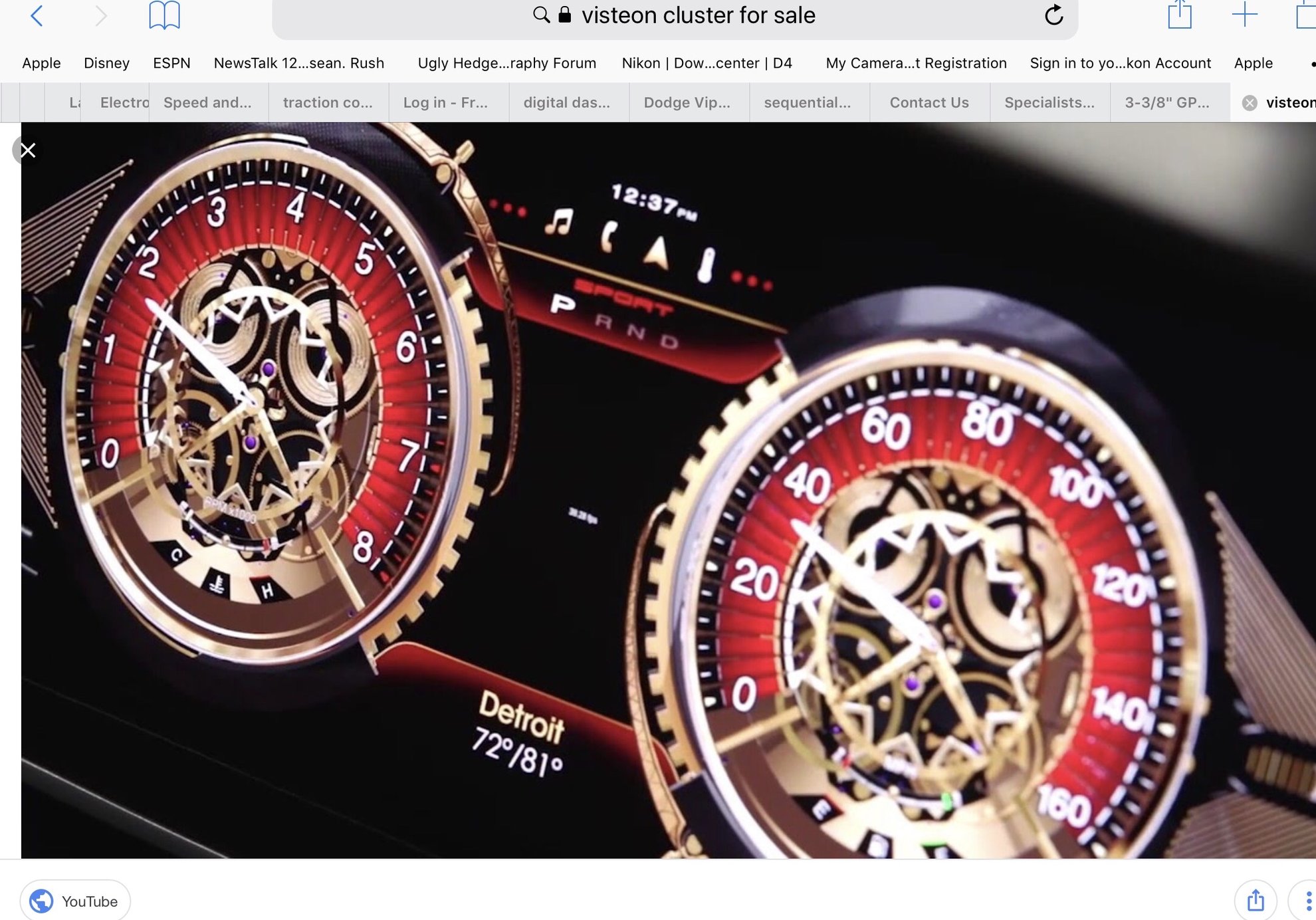

Interesting Del. So cool stuff there. I’m going to look into it. I’m. Currently working with a developer to make custom. 3D interactive gauges and infotainment center. My gage cluster will look like this. But retro fit to fit the slc.
I dig that, looking forward to seeing that in action!
