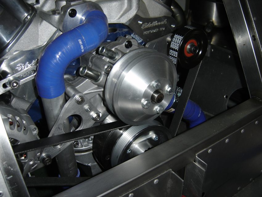

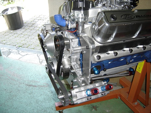

Bob,
I had a similar interrogation for a Ford 302/331, in a scratch-built MK1, not very different from a Tornado .
After investigation with mechanic and electric solutions, I finally decided for a FORD RACING cover + water pump : M - 8501 -A 50 .
I got it from Summit Racing ( Presently $ 195) , but it looks that any serious dealer have it ...
The main point is the reverse pump rotation direction ...
The second point is to find the right pulley , related to the harmonic balancer pulley you have; (I made both myself ...)
I am very satisfied with the result as the 302 is nested behind the bulkhead without any protuberance ....
René
