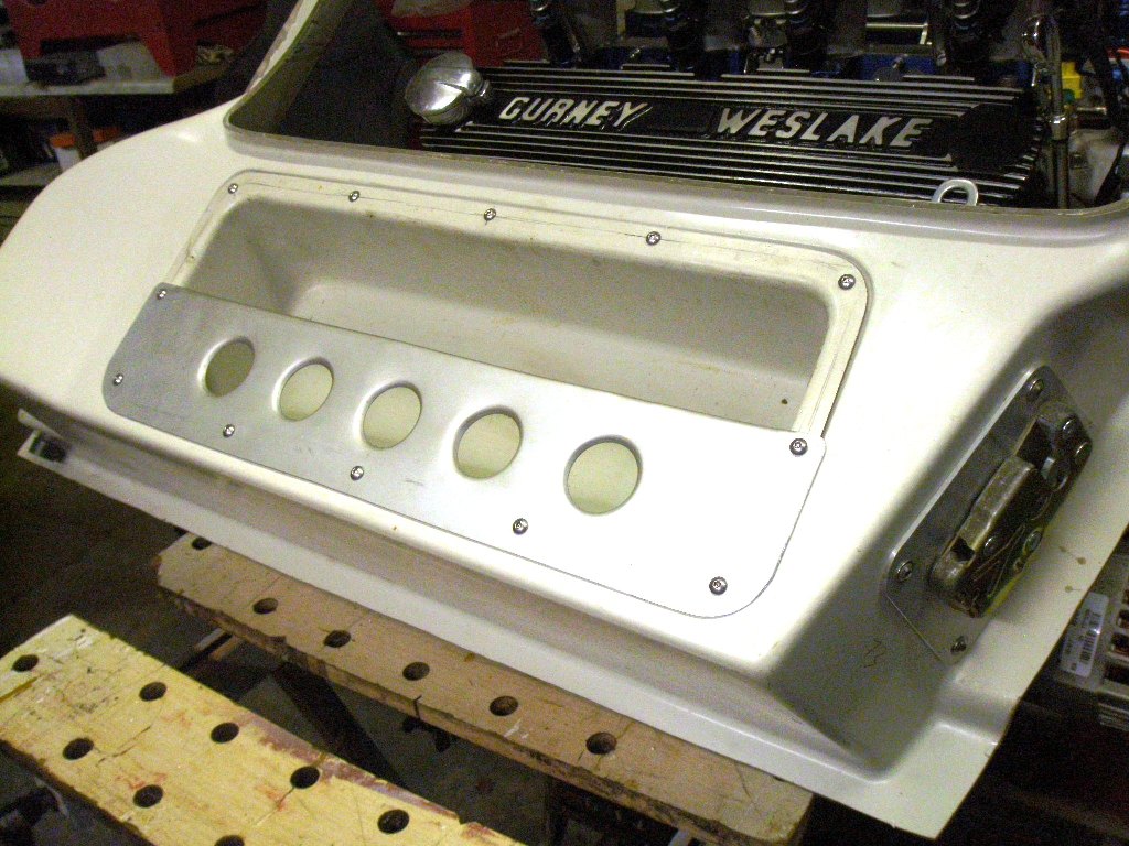

Hi Randy Just a thought would it be easier to sever the flanges from the box only in the offending areas and the re-bond them for the best fit ?????? Just thinking out loud. That may save a lot of work on the doors. Wally
RF door box picture. Wally

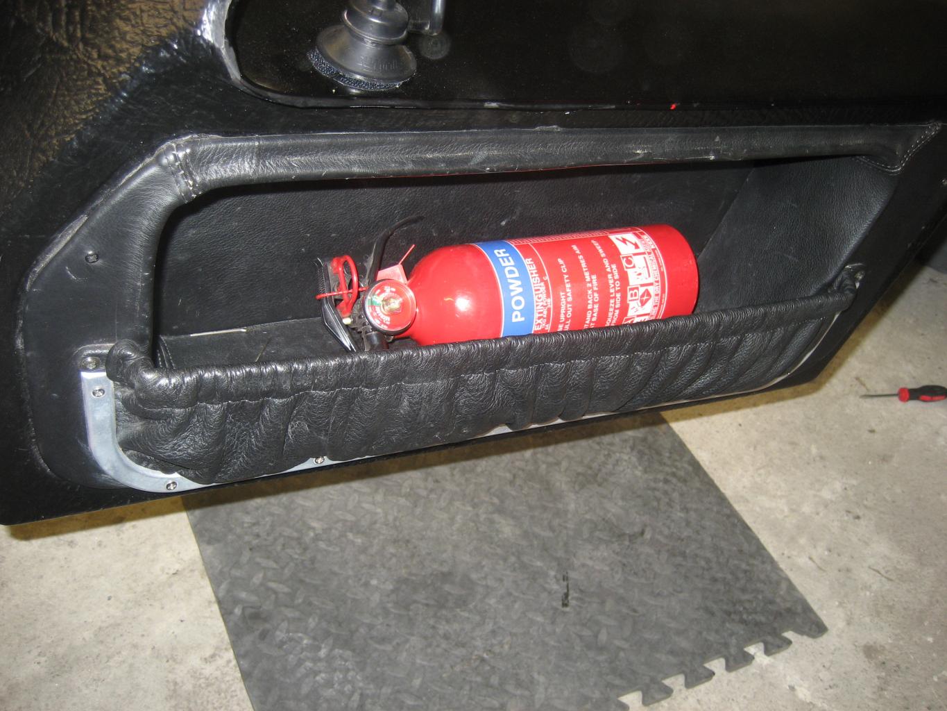

Finally found the pic I was looking for of my door pocket setup. There is an ali frame which is quite thick and strong and also serves as a good door pull handle. The thick leather pouch is then attached to this and to the door at the bottom by a wide U shaped ali frame. This creates a larger storage volume as it extends beyond the line of the door by a good 2". As storage is very limited in a 40 this is a valuable addition and I can get some large items in there as well as all the little bits and bobs you need to get to in a hurry.

Very nice Mike and quite period looking as well! :thumbsup:
Thanks for posting!
Hmmmm... Now how to leather wrap! :)
