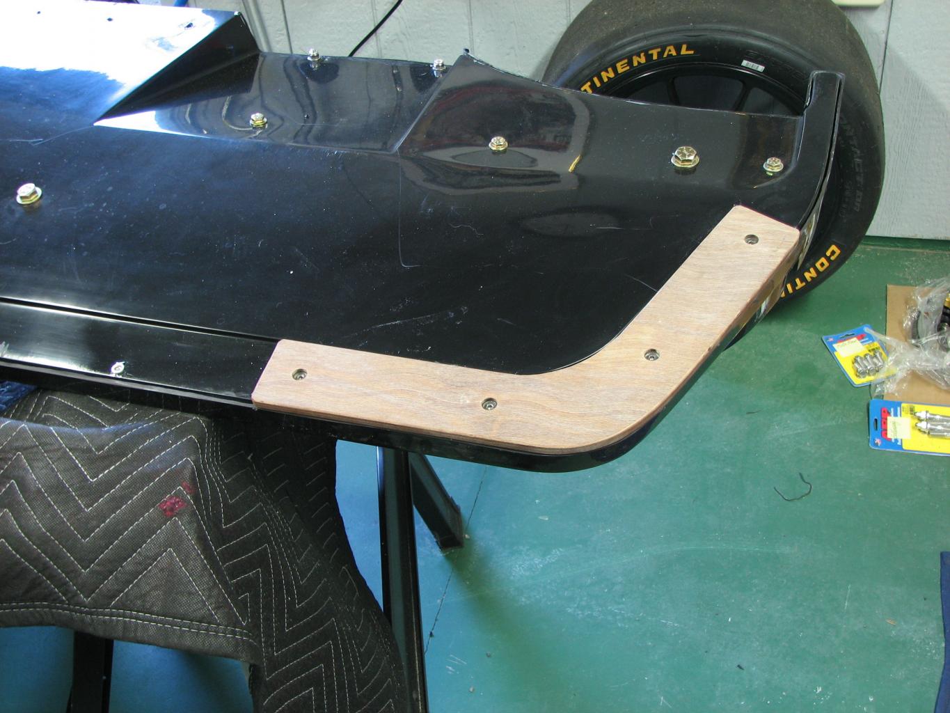

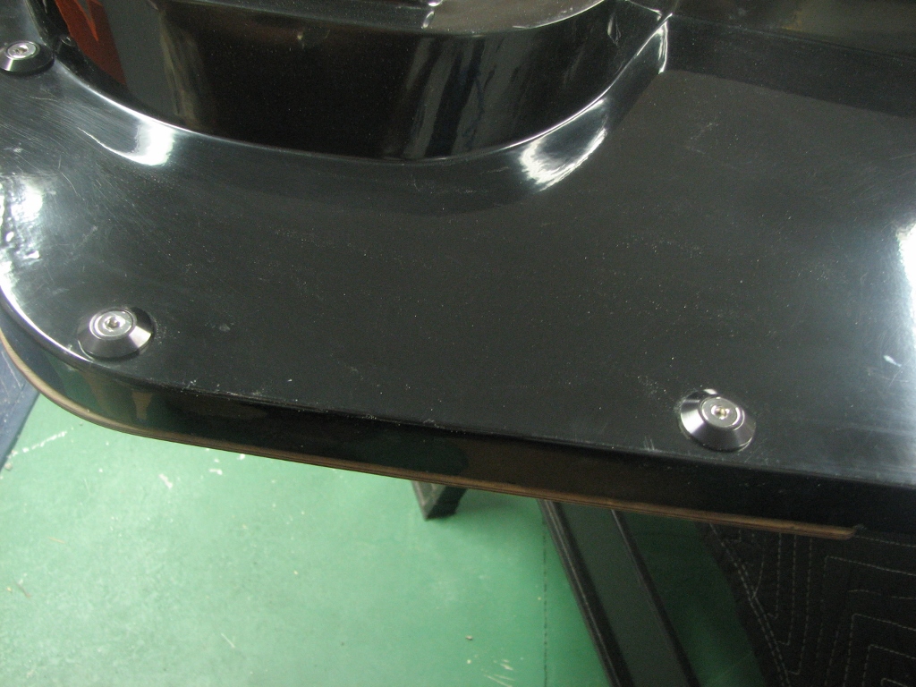

Jabroc Wood, 10mm thick, with SS flat-head allen bolts, recessed to the max. After this photo, I beveled the front edges 45-deg. on a router table.
Pegasus 6180-10-050x050.
Just my opinion, hope it helps.
David

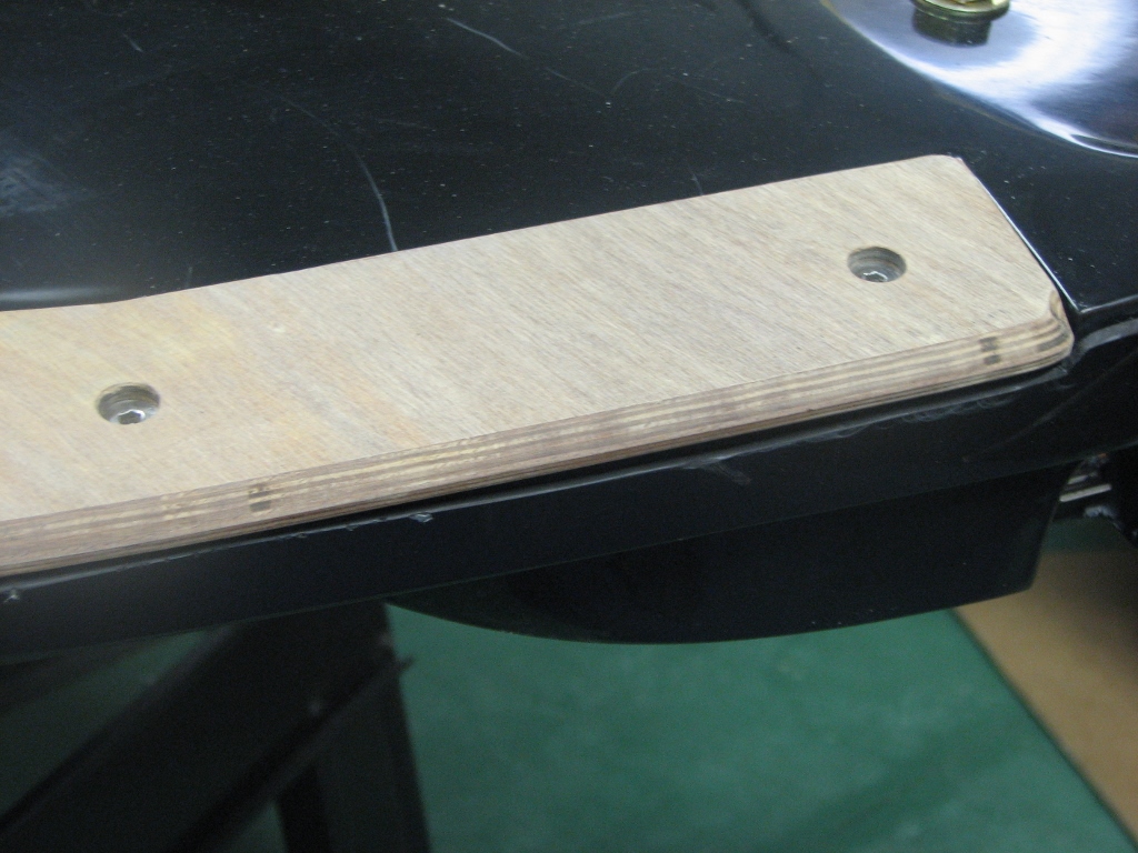

A photo of the 45-degree bevel I put on the front edge, and one from above:
No expert by any means, just tryin' to build another car and this is what I did.
David
