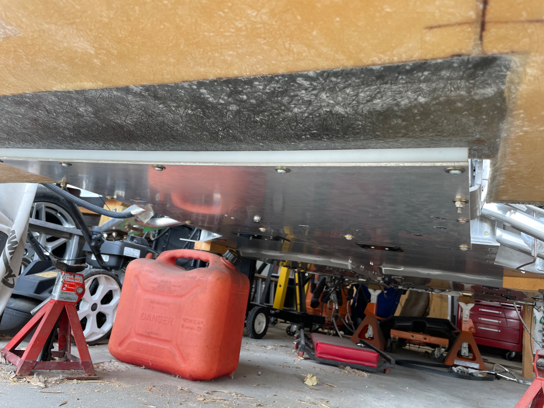

Quick question, does the center of body sit on top of the aluminum plate? When the car was delivered to me it had the carbon side sills sandwiched between the body and the aluminum plate. There was only half the hardware installed so taking it apart it looks like the side sill should go on the bottom of the plate and the body on the top which leads me to believe that there should be some type of backing plate on the body to thread into?
Sorry, I am just trying to make sense of what I was given. I searched but couldn't find any info on this particular subject.

It goes as follows:
Body on top of Aluminum
Side skirt under aluminum
Allan explains this in post #8 from this thread…
