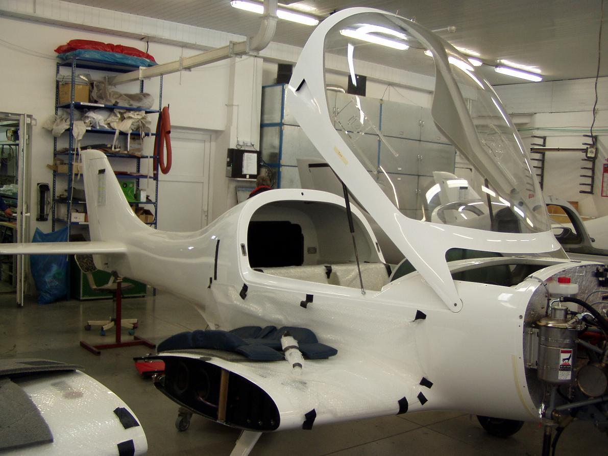

Hello
if this can give some idea ;
this is what I fit on both sides of my carbon ultralight canopy ( which is quite curved)
these where on my kit but I think they can be sourced at Mecaplex ( swizerland supplier ??)
