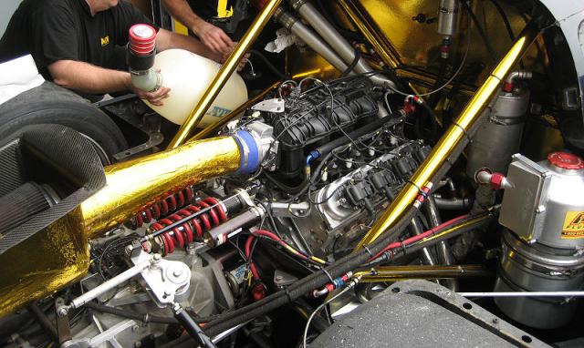

Just for fun....
LS engine (500HP rule restriction) in 2250lb mid-engine, 5 spd gearbox (rule restriction) = DP Pontiac
I know their is alot of high-tech there, but can't help but notice the similarities as well. Maybe Fran can gold-finish the rear tubular components? :shy:

Just for fun....
I bet the SL-C could run in GT2 or GT1 and surprise a lot of people :stunned:
What category do you see it in Fran?
...whats the advantage of gold? strength?
Not sure the gold tubing does anything (in difference to the gold foil heat shielding). But as a Radiologist, I like shiny high-tech stuff....so it sure looks purdy!
