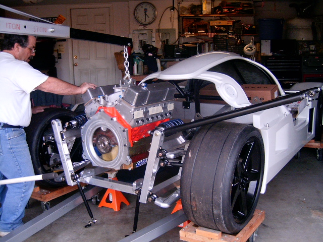

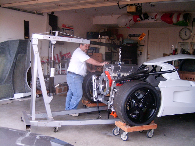

I started to trial fit the engine so here's a couple of pictures. So far there's plenty of clearance from the oil pan to the motor-mount cross brace underneath. The front of the motor to the chassis cross member is tight but I think I will be OK. I may decide to remove the shims I added to the water-pump so that I could get good pulley to pump clearance and then take a little material off the water-pump casting. This should gain me another 1/4" for a total of about 5/16" from the WP pulley to the chassis.
Other's who want to put a SBC in a SLC note: MUST use short water-pump and pulley set. Long pump is a no "way/no how" unless you have Fran notch the chassis. I didn't want to do that. I'll be OK with 1/4" or more clearance and with solid motor-mounts that should be enough.
Motor mounts supplied by Fran fitted right up as well as the adapterplate.
Next I need to add the gearbox and trial fit them both. More pictures then.

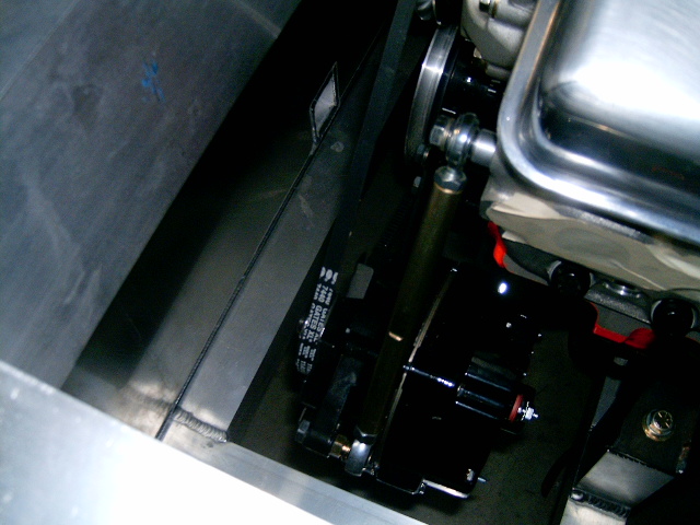

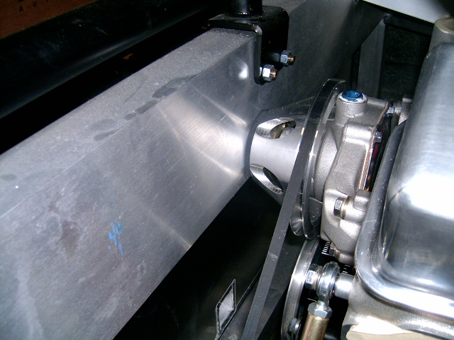

So here's a couple more. The engine is now located dead on the centerline of the car. I had to make a couple of changes to the water pump which meant I had to take it apart and turn down the shaft length about a 1/4 inch. I now have a solid 3/8" clearance to the front of the chassis in front of the water pump pulley. Nice and tight and as far forward as it will go.
The alternator fits real sweet and these cars have plenty of room for accessories like AC pumps etc. Lots of room to the right and left of the crank pulley. That's where I would mount things low and to the side of the crank pulley.

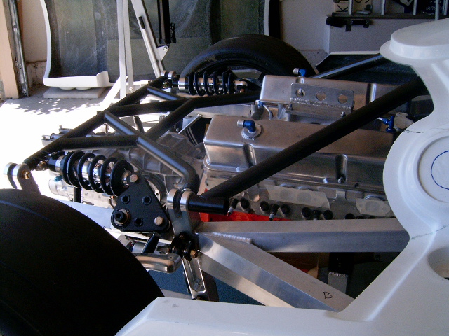

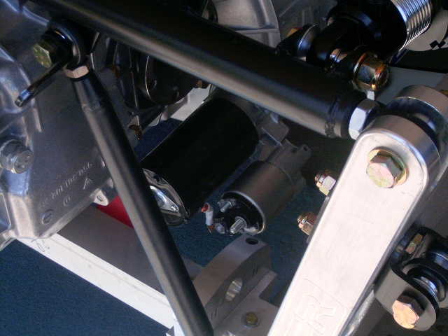

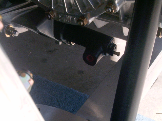

So now I have gotten the engine mated up to the gearbox and into the car. The help I got from this forum really helped me with the Porsche Clutch. I have never seen one up close so I had to ask someone. The someone like always was my friends on this forum. I have learned to come here first. It really saves a lot of time.
The fit is tight but within specs, so to speak. No extra room but none needed. One of the pictures shows that the starter fits right in its place and the other tight spot is the clutch slave cylinder. I suppose if there was more room it would only be wasted. Both can be removed with out taking anything else apart so, good enough is good enough. Given the close fit at the water pump pulley you have to admit that Fran got his sums right.
Next I intend to give the exhaust some thought and in the meantime run the coolant pipes and work out the rest of the coolant system. Then the brake pipes and the brake system.
As you can see, I like to install the big stuff that must be located in only one place and then fill in the remaining systems afterward. It's beginning to look like the best place to put the mufflers is out in the side-pod along side the motor with exhaust exits in front of the rear tires on each side. I would like to run them out the back but so far anyway it looks like a lot of extra work to no end. I will make up some cardboard mufflers and see how it looks. The idea is to use headers sort of like shorty headers but with the collector flange facing outboard instead of downward. Then run through the muffler and out the side. Straight forward and simple. Just like I like it.
