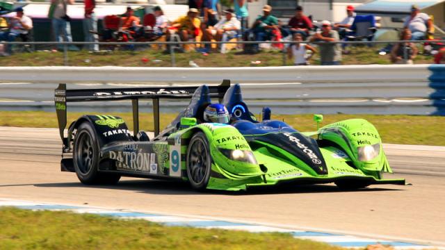

The green accents make me think of the Acura LMP2 car...
