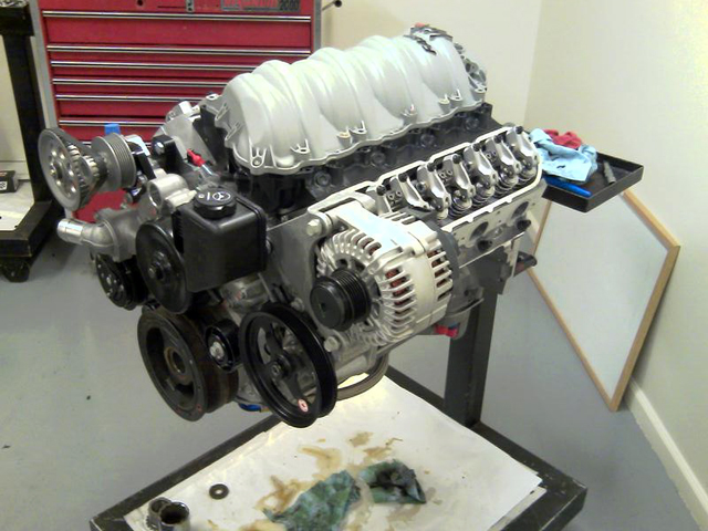

My engine is in CT (the correct lifters finally came) so I decided to post some anti-rotary pictures. These are my ALL-PRo Lsw Ls7 ported by Richard @ WCCH (West Coast Cylinder Head) with custom HKE spec Jesel rockers:
Roberto,
Love those Jesels! :thumbsup: Now you need to dress them up with some CF valve covers.....
You're moving right along. What's the color scheme?

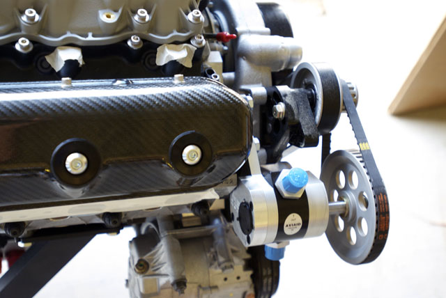

I don't know about you, but for the price ($$$$$$) Jenvey charges for the air boxes I'd be a bit upset with what they sent you - it looks like it is in desperate need of some wetsand&polishing, plus is that dents/thumbprints I see in it???? :/
Btw, take pics of the fitment, I'm really curious!
It's a good thing you went a different route. They are note perfect museum pieces, but they are very high quality and weigh about 3oz each. I like them.
Does Reverie make the air boxes for Jenvey or do they make their own?
I don't remember the name of their carbon guy, but they do not make the carbon themselves as I understand it. They mentioned it being outsourced when I spoke to them.
But ... but ... but ... the thumb prints in the mold. Ahhh, I can't take my eyes off of it! :lipsrsealed:
