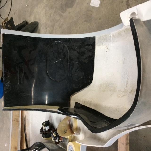

here is a front shot. Got to find a better shot of the rear. Do you have street tail or race tail. Takes some work on the street tail.
Under Bodywork/Modifications is a section titled "wheel well liners". There are 5 posts that I made which touch on the wheel well liners and the various modifications I made to them. Definitely takes some massaging to make work.
One additional comment - the rear vertical pieces are pretty flimsy, even after securing them to the bodywork. I would recommend shoring these up and making them stiffer. Maybe get a piece of cardboard and sandwich it with another layer of fiberglass to the RCR supplied piece.
