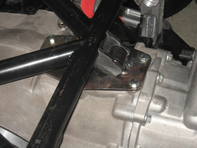

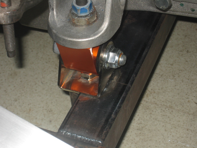

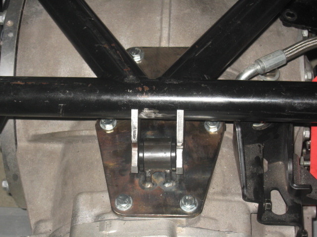

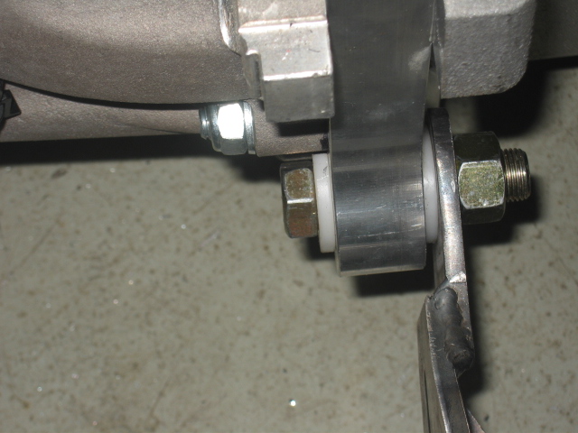

I could see using the Pfadt side mounts if the back of the engine and transmission wasn't hard mounted to the frame. It just seems silly to do the side engine mounts and then have the back of the engine hard mounted. Wouldn't that put extra stress on the back engine mounts?
I'm sure the rest of the drivetrain is not hard mounted. This my PFadt mounts, adapter plate and ricardo mounts
