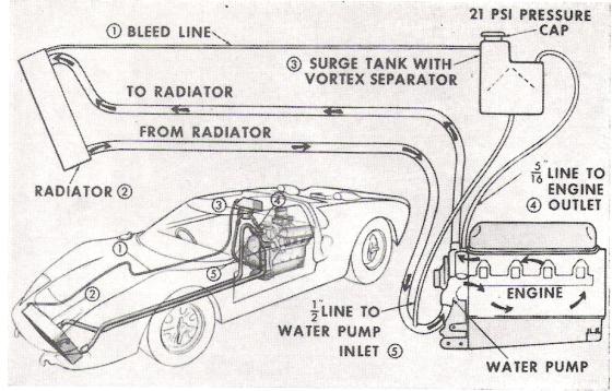

Wait a second... Bleeding would be automatic if there's a fitting at the top of the radiator tank as is my RCR40 Radiator and the original GT40 radiators..
Check this out..
