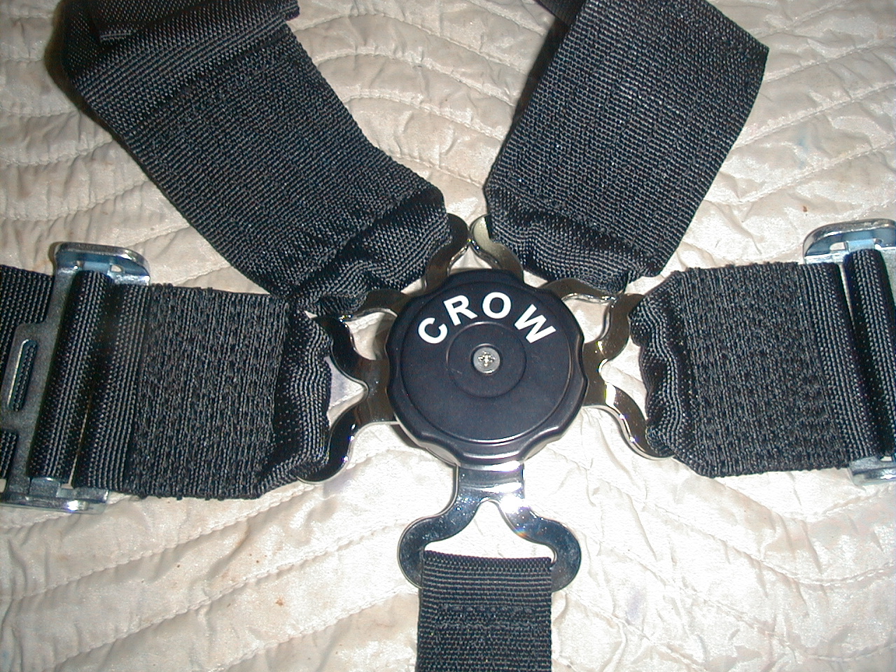

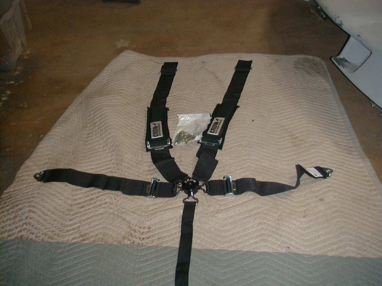

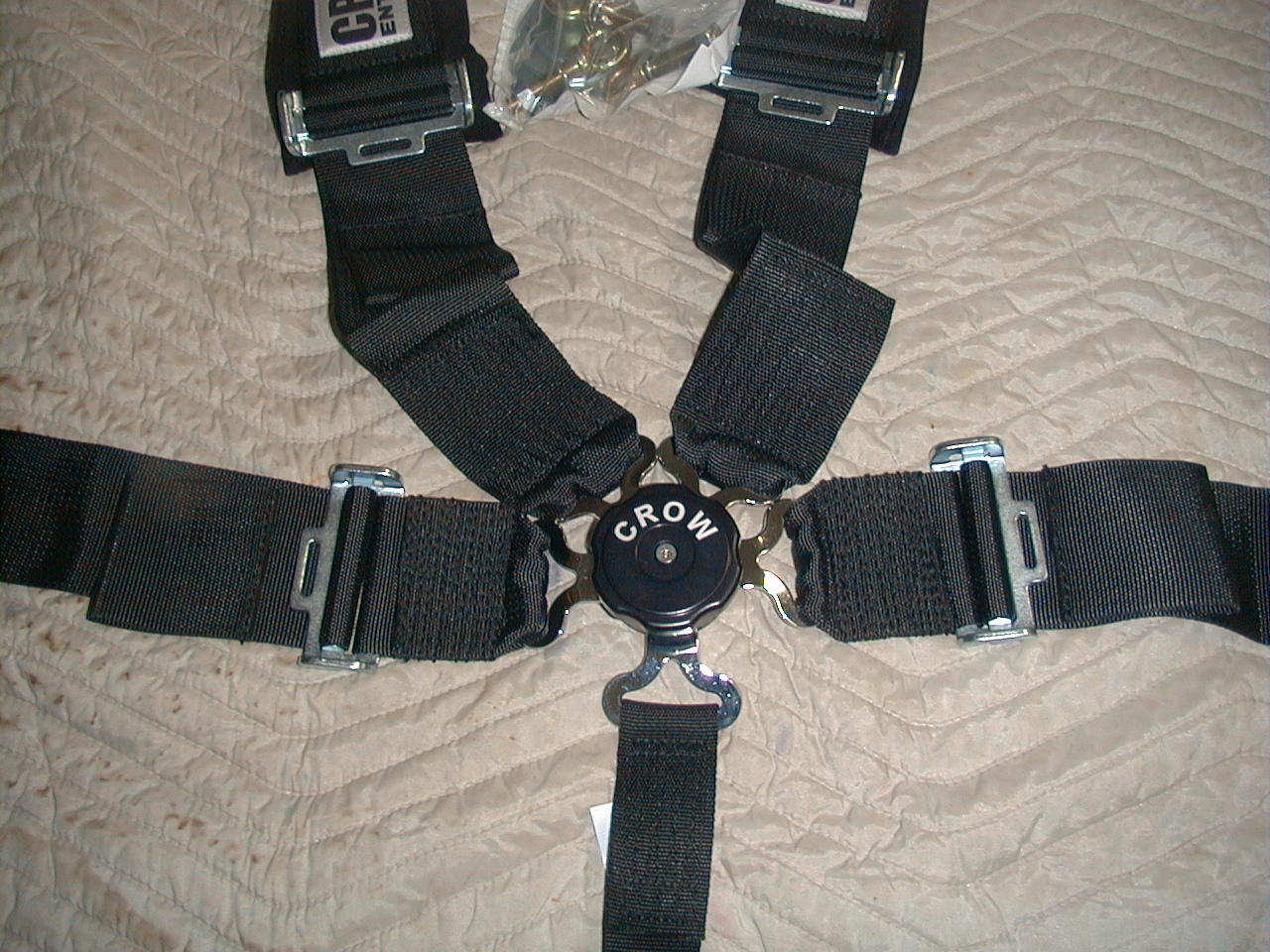

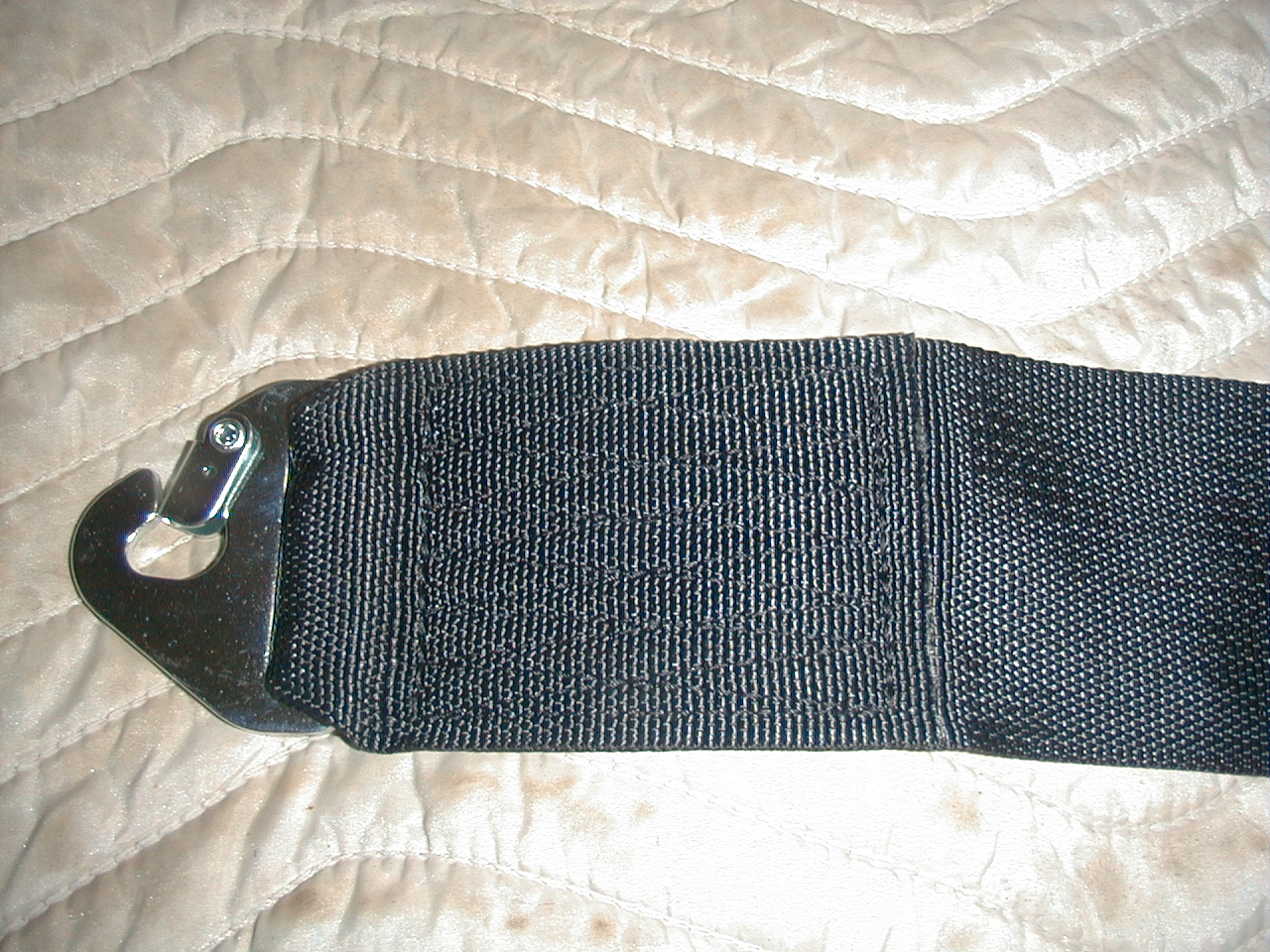

Some pics of my Crow harness.

VERY nice, Al. Do all 5 belts disconnect with a push on the central "button", or does each need to be disengaged individually?

I notice you are using the 5 point belt. Why did you opt for that as opposed to the 6 point? I understand that we are in a semi reclining position, and submarining is somewhat less of a problem, but I would think that a sudden stop would be rather painfull, and I am a bit too old to be singing soprano.
The 6 point to me is a better system because it wraps around the inside of the legs and in the event of a sudden stop, it actually supports the legs to the outside much like a repelling harness does. Which brings up the thought, that I have never seen a repelling harness with a single crotch strap!! Wonder why??

Doug, You turn the camlock and all or any of the attachments can be removed.

Bill, the six point uses one attachment point on the camlock so I can change it if I want to, and I might. The truth of the matter is that I was looking at the 5 point when I ordered and with ways of attachment, etc, filling my head I just plain spaced it. I think I will get the 6 point and send back the huevo crusher.
