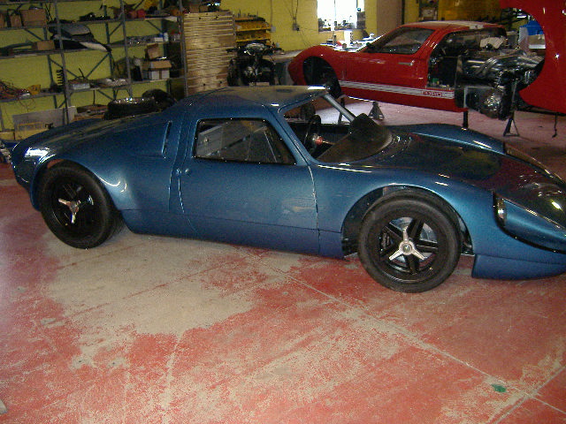

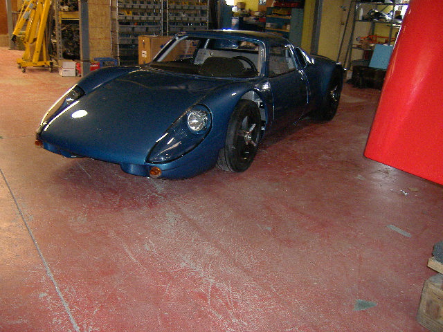

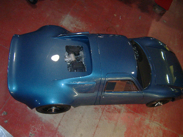

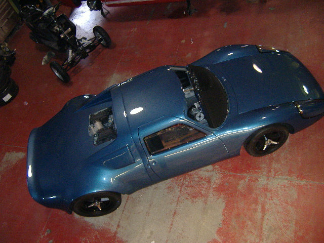

Yes we did discontinue them...in fact I sold our last inventory of windscreens to my buddies Kevin Hines and Chuck Beck
We built this car with a Boxster drivetrain and did our own Carrera 6 body panels, 917 style wheels too but maintained the original wheelbase
We build lots of custom cars and parts that we don't advertise as most owners like the one off exclusivity from time to time.
