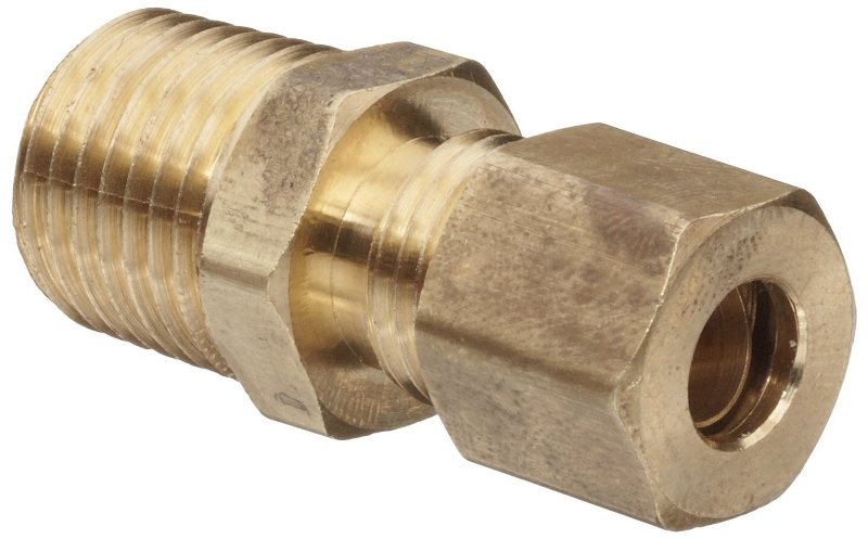

I'm ready to connect the Smiths Oil Pressure Gauge to the Roush engine. I need a fitting from the 0.19" OD nylon tubing to what I think is 1/4" NPT on the Roush oil port, near the fuel pump at front. I'm assuming it's one of those compression fittings with the mini brass sleeve and nut.
Most online vendors deal in fitting kits for 1/8" nylon tubing. 1/8" is smaller than I have attached to the gauge as delivered from SPF. I've measured it with a caliper.
I realize I could switch the plumbing to copper or another size. For now, I am hoping to just continue on this path.
Any thoughts?

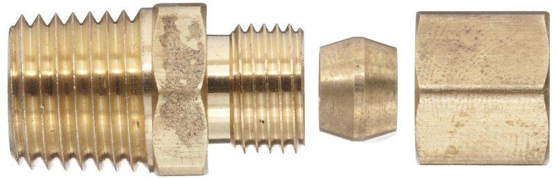

Thanks all. I found the fitting on Amazon. "Anderson Metals Brass Tube Fitting, Connector, 3/16" Compression x 1/4" Male Pipe". This mates the nylon tubing to the block perfectly, with no additional adapters.
