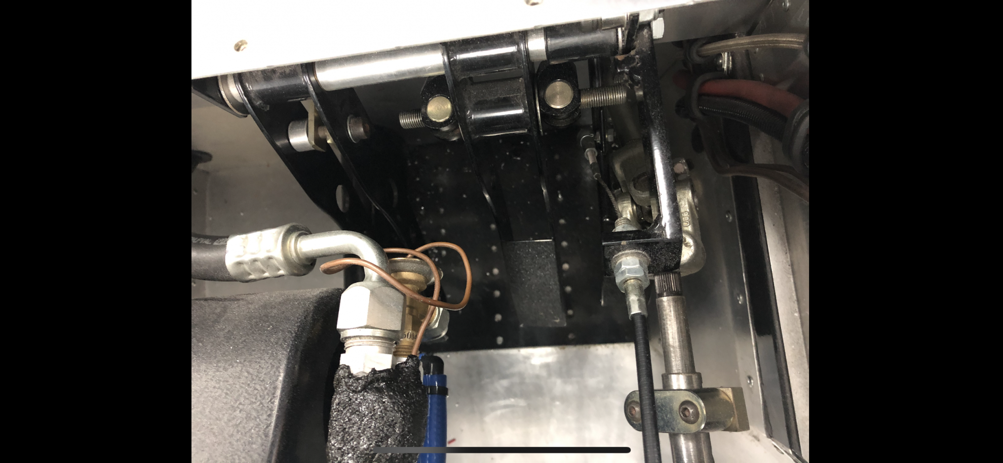

Hi Nick,
I have used the small (5-6”) supplied bracket that mounts the the pedal box to support mine. Seems to work just fine with the two springs at the carb end only.
I did slit it though to allow cable replacement,
Pictures below:

Hi Nick,
Pictures below:View attachment 125296
Hi Paul, thanks for the reply, that makes sense, unfortunately no bracket supplied with mine. Is it just secured to the pedal box via the one shaft bolt on the side?

I found a clip on clevid pin that worked better the homemade fitting to pedal.
Coulumn bracket
old photos, not like this anymore though
