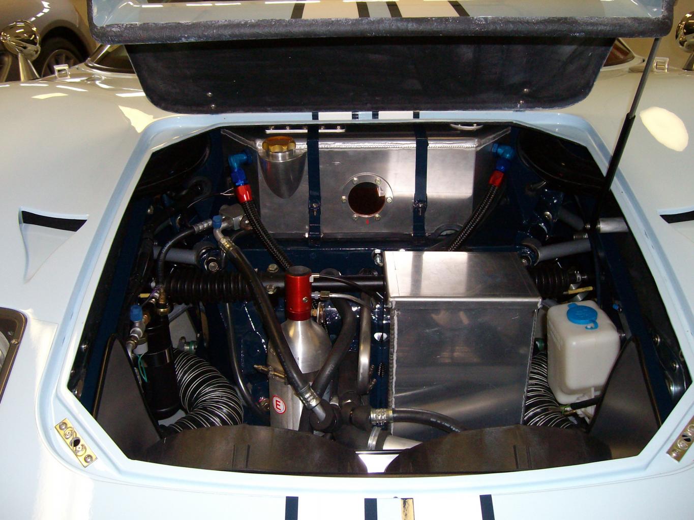

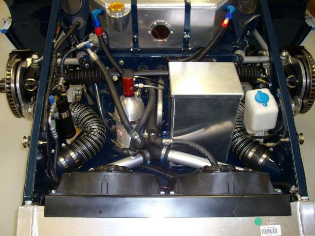

Hi, anyone have photos of the AC setup, hoses and aluminum covering box used in an SPF GT40. Any schematically drawn diagrams of how it all supposed to work would be great too. Do they use a known manufacturer AC and heater setup like vintage air or old air? I reached out to SPF but it being the weekend I figured I would try on this site too

The AC system SPF uses is custom built for them. The system is "two-piece with the AC evaporator under the dry sump cover and the heater inside under the IP.
I have some pictures I will post later.
That look like this
