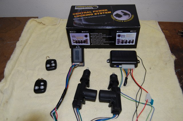

Many SPF owners aren’t concerned about the lack of door locks, but the thought of uninvited people trying out my seats or worse stealing them caused me to pursue keyless door locks. There are many web sites offering these. I chose slickcar.com and the Commando kit costs about $75. You get 2 actuators, a control module, a remote receiver, 2 remote transmitters, and wiring harnesses.
Hook up all the electrics outside the car so trial fits can be done. Instructions come with the kit, but I changed a few things. There are extra circuits for an alarm, starter interlock, and valet override. I deleted these. Basically both the remote receiver and control module need power and ground connections. Splice the blue pulse wire from the remote to the white control module wire. Ditto for the green pulse wire to the brown control module wire. Connect up the actuators and test their operation with a remote transmitter.

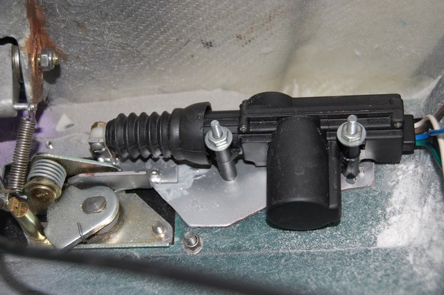

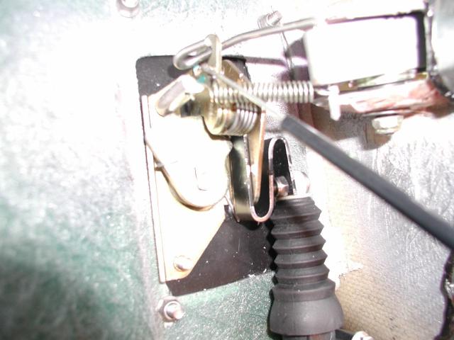

Remove the inner door panels on both sides. Photo B shows the door catch mechanism. The actuators are mounted on plates below this.

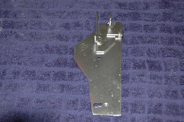

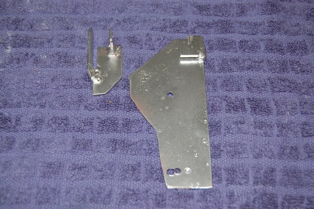

Fabricate a mounting plate and slider as shown in Photo C.
The slider is guided by a small tab welded on the mounting plate.

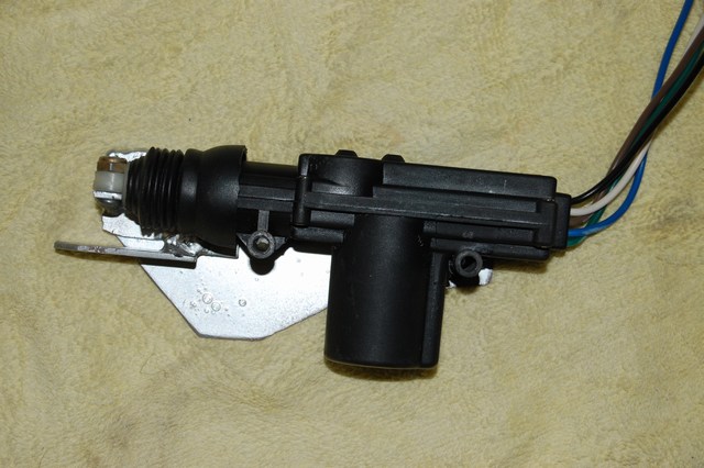

Photo E shows the actuator bolted to the slider mechanism.
Photo F shows the assembly bolted below the door catch mechanism.
This takes a lot of trial and error, but basically the slider needs to move upward enough to block the door catch from rotating outward on locking. It also needs to be able to slide downward enough to allow the door catch to rotate on unlocking. This is a travel of approximately 3/4". Drill thru the door and bolt the top mounting bolt on the actuator first. Test the action of the mechanism with the doors open turning the door catch by hand. Flair out the top of the slot on the slider even though the photo doesn’t show this. Get the angulations of the actuator right so there is no binding. After tests show smooth action drill and fasten the bottom bolt. Then repeat the tests with one door at a time closed.

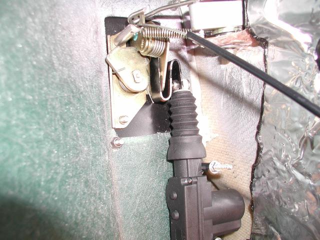

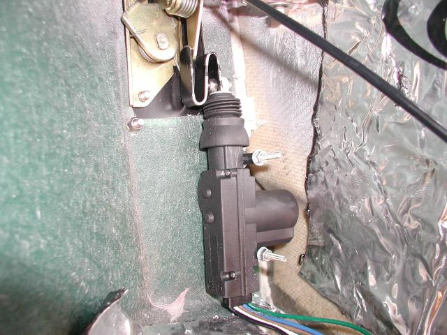

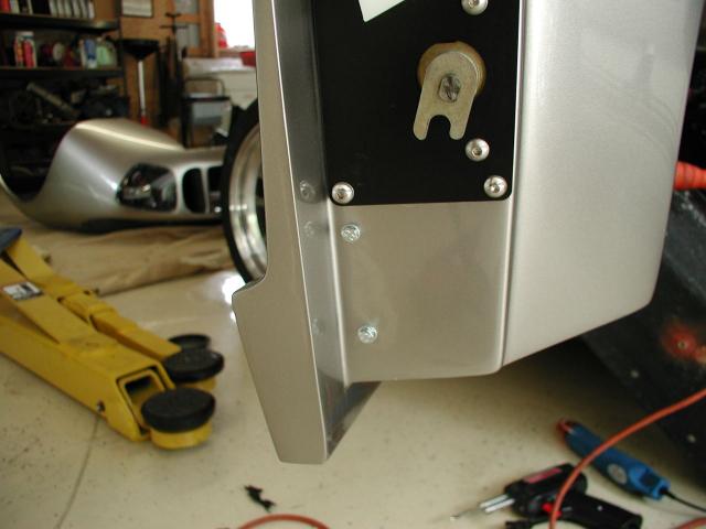

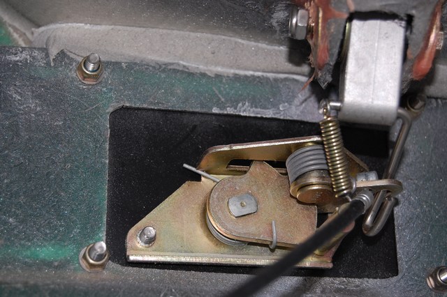

I bought the same setup that David shows above, but I made a simpler version of the adapter.
First picture shows what you see from the outside.
Second picture shows the lock deactivated.
Third picture shows the lock activated.
Fourth picture shows what happens when you try to open the door.
The door will not open, but it is 'unlatched' slightly. I believe David's setup must do this as well. You just have to push the door slightly to get it to 're-latch'. Works for me.
