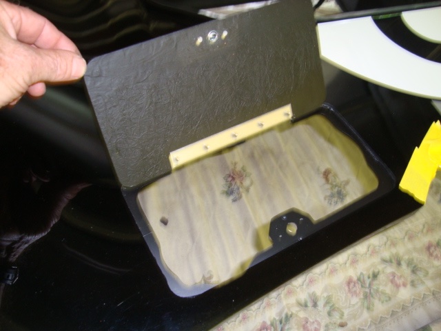

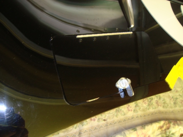

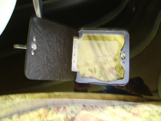

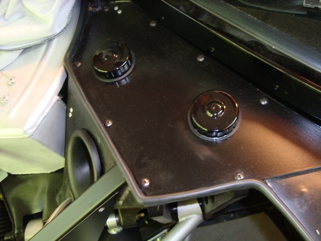

I moved the reserviors from the front A/C cover to the cowl. Made doors in the front clam for access. Was a bit nervous cutting without having to repaint. Raised the reservoirs some and used thin orings to the seal reservior can to cowl sheet metal plate.

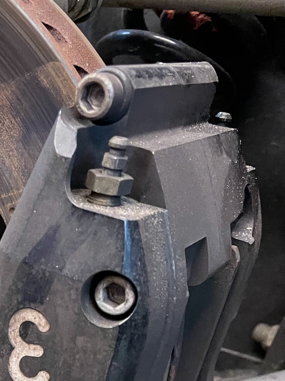

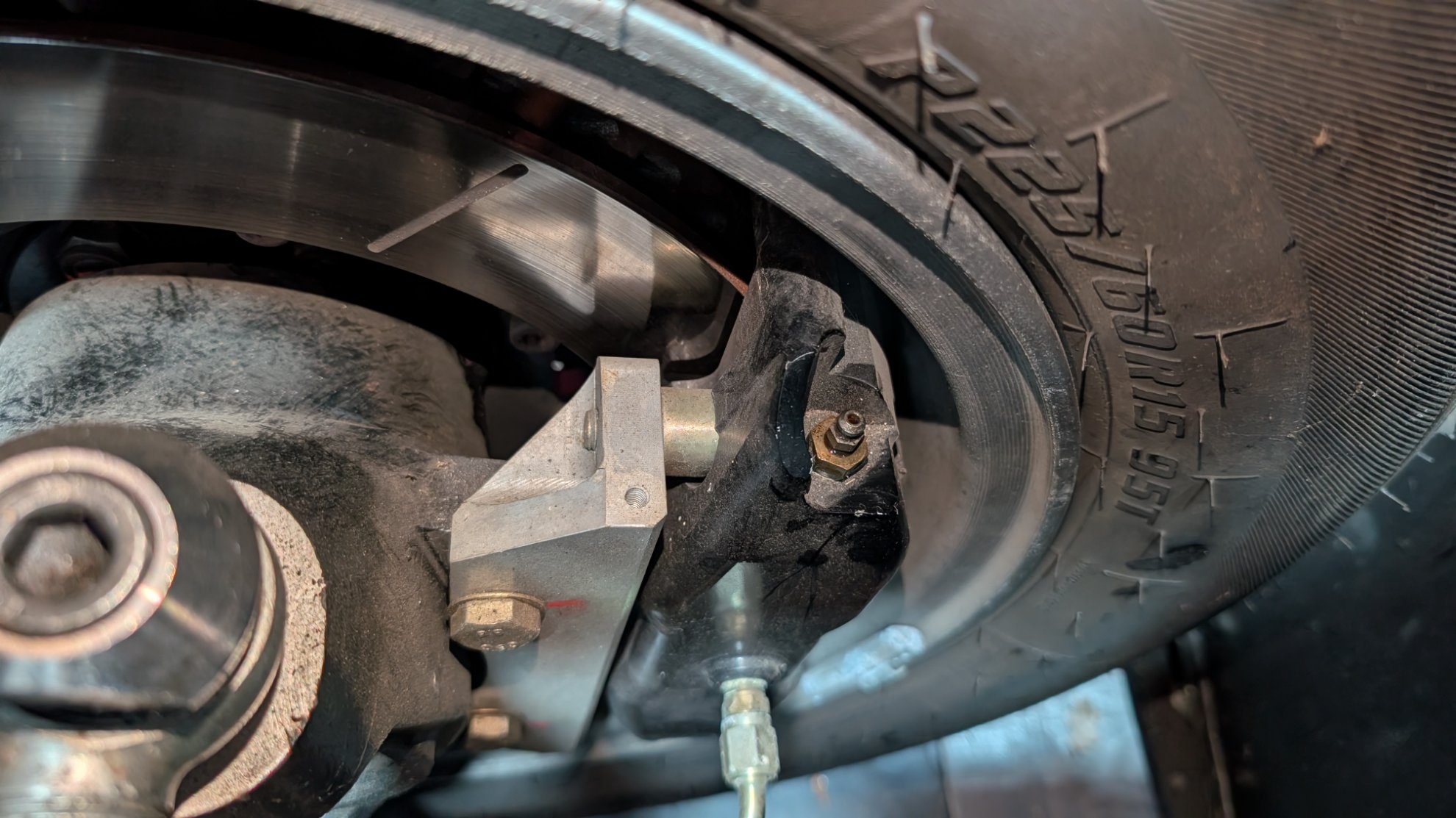

I see only the top caliper bleed screw...not an inner and outer. I am back at it tomorrow, so I will keep looking and trying.
Lee Patterson
1" sounds about like mine. It is definitely not "inches" of travel. And very firm when you bind down on it hard.
The current Wildwood caliper has 4 bleeders on it - 2 top and 2 bottom. Yours being very old must have an older style caliper.

3/8" nuts are tight. I am loosening the 1/8" bleeds 1/2 to 1 turn...I am still barely getting any fluid out with firm pressure on the pedal.
See my picture above...regarding the calipers I have. I will look into it more tomorrow.
