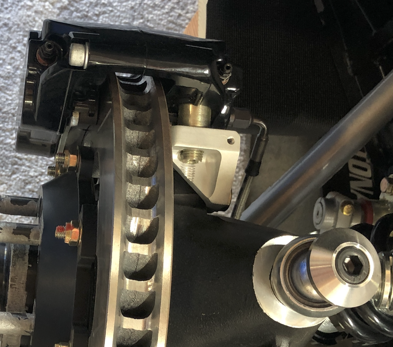

Mike, I also replaced the brake fluid on my early SPF not too long ago.
Unfortunately I'm heading out for work - so quick comments only.
To get to outer bleeding nipples I removed all four wheels to access the calipers easily.
I used a vaccum pump like this:
This is the original Mityvac hand vacuum pump kit used by service professionals worldwide for performing hundreds of automotive diagnostic and mechanical tests and for one-person brake bleeding. The MV8000 kit contains the most popular Selectline hand vacuum pump with vacuum gauge and...
www.autobodytoolmart.com
There are some good videos on YT e.g.
I had a certain sequenz for bleeding the calipers - I will look that up later....
Overall bleeding was not too bad and I got all the old brake fluid out easily - however, proper bleeding (getting all the air out) was more time consuming.
