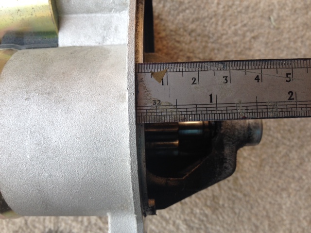

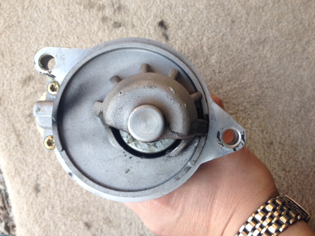

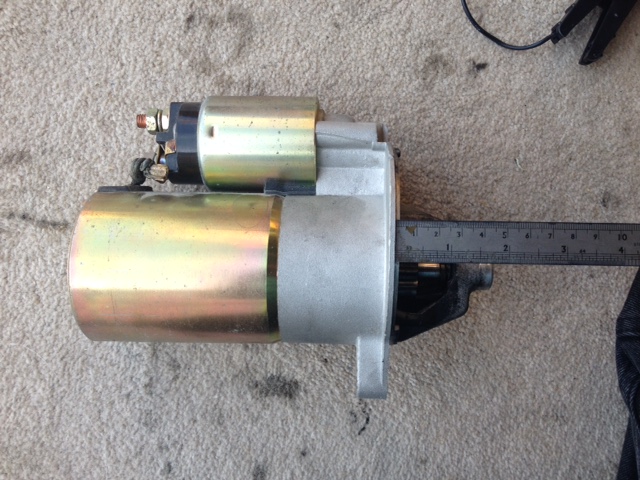

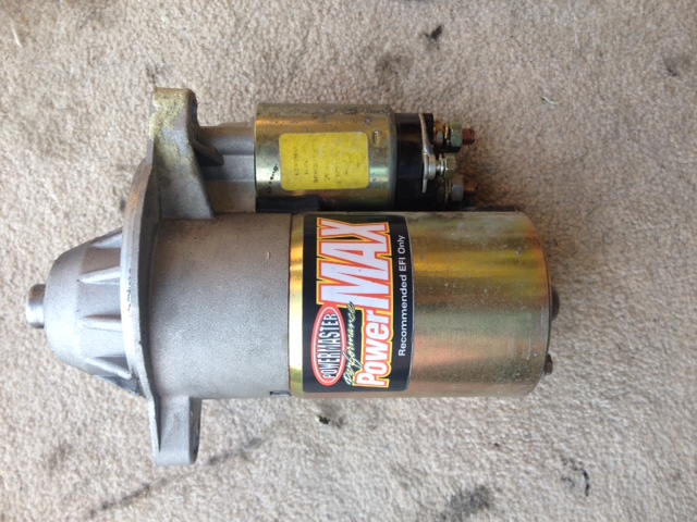

I removed the starter motor this weekend. Its a Powermaster Powermax, see attached photos). Not sure which type as the serial number on the side has deterioted and is unreadable. I am assuming its a 3/4" offset as the distance between the engine side of the flywheel and the face of the mounting is 5/8", and the flywheel has 157 teeth.
I also found the cause of the problem. Last year I fitted a battery isolator on the earth side of the battery! Unknown to me the connection was worsening causing higher load on the solenoid which I assume was the reason for the starter motor failing as it was taking longer and longer to crank the engine resulting in the solenoid failing (a £6 part has cost me a shed load in transport when it broke down and a further cost of a new SM!!). I've learned my lesson here.
Anyway, should I go with the same starter or is there a better alternative, and should I go with higher cranking torque? than the Powermaster (I think its around 160 ft lb torque)

Powermaster is a recognized seller of proper equipment - I would not be afraid of purchasing from them.
I am suprised at the "Recommended EFI Only" on the decal.. Never have seen that before...

Edit - By the way, that Powermaster is a PMGR starter as referred to earlier..

That starter is recommended for motors with 10:1 (max) compression and EFI. Your starter motor is lighter duty than other models offered by Powermaster. Ensure that your power cable and ground are in good condition and sized correctly as this can affect starter motor performance. FYI 10 ohms of resistance between the battery terminals and the cable connection and you may not be able to start your GT40 (or any other car).
The "EFI only" is on units that are not expected to crank "long". The assumption is carb'ed engines must crank longer to fire. If you look at the Powermaster chart they clearly indicate the torque and induction type recommended for each starter.
The Powermaster supplied by Roush in my GT only made it 4000 miles before it quit. Frankly I have had excellent results from the units sold by DB electrical for a much lower price point.
Interesting Rick... I would think that if the starter is so weak that it would not crank a carb'd engine over properly, I would not buy it... EFI engines flood easily if you manage to touch the throttle while cranking.
