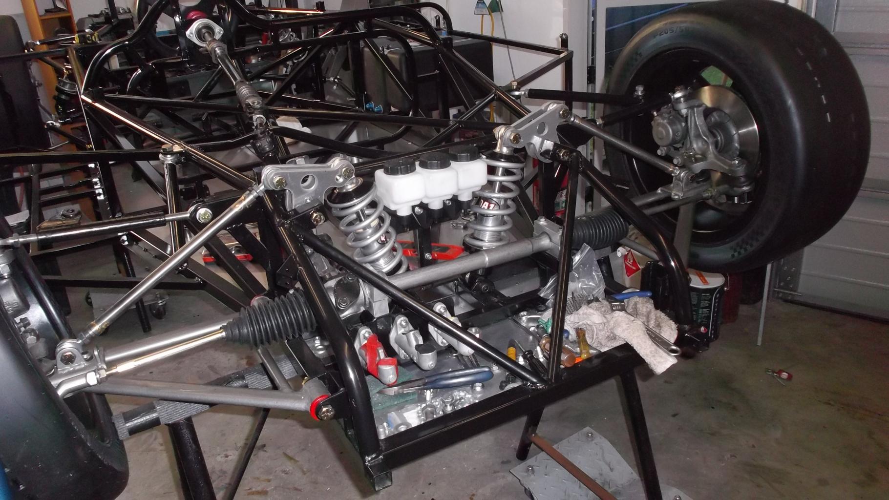

just a quick question as to what sort of front wheel angle is the norm on full lock for a 40, as i was looking at the chassis this arvo with a wheel roughly in the right spot, and it certainly wont do a u turn in a one way street.

Hi Jac i mocked it up using the Mustang11 drop spindle combo i have, and at best i think i could get 23 deg steering angle , is that acceptable,

Assuming that is the inner wheel during the turn John a quick sketch gave me about 40/45 ft turning circle, need a bit of throttle assistance to tighten that up!

well with a change of tyre down to a 225-60-15 [from a 245] and a bit of fiddling i can now get 28-29 deg max angle on the inside wheel turn in, is this an acceptable figure for these cars, as i cant find one iota of information out there.

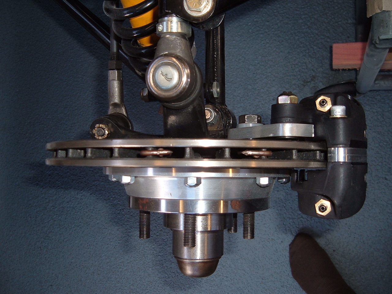

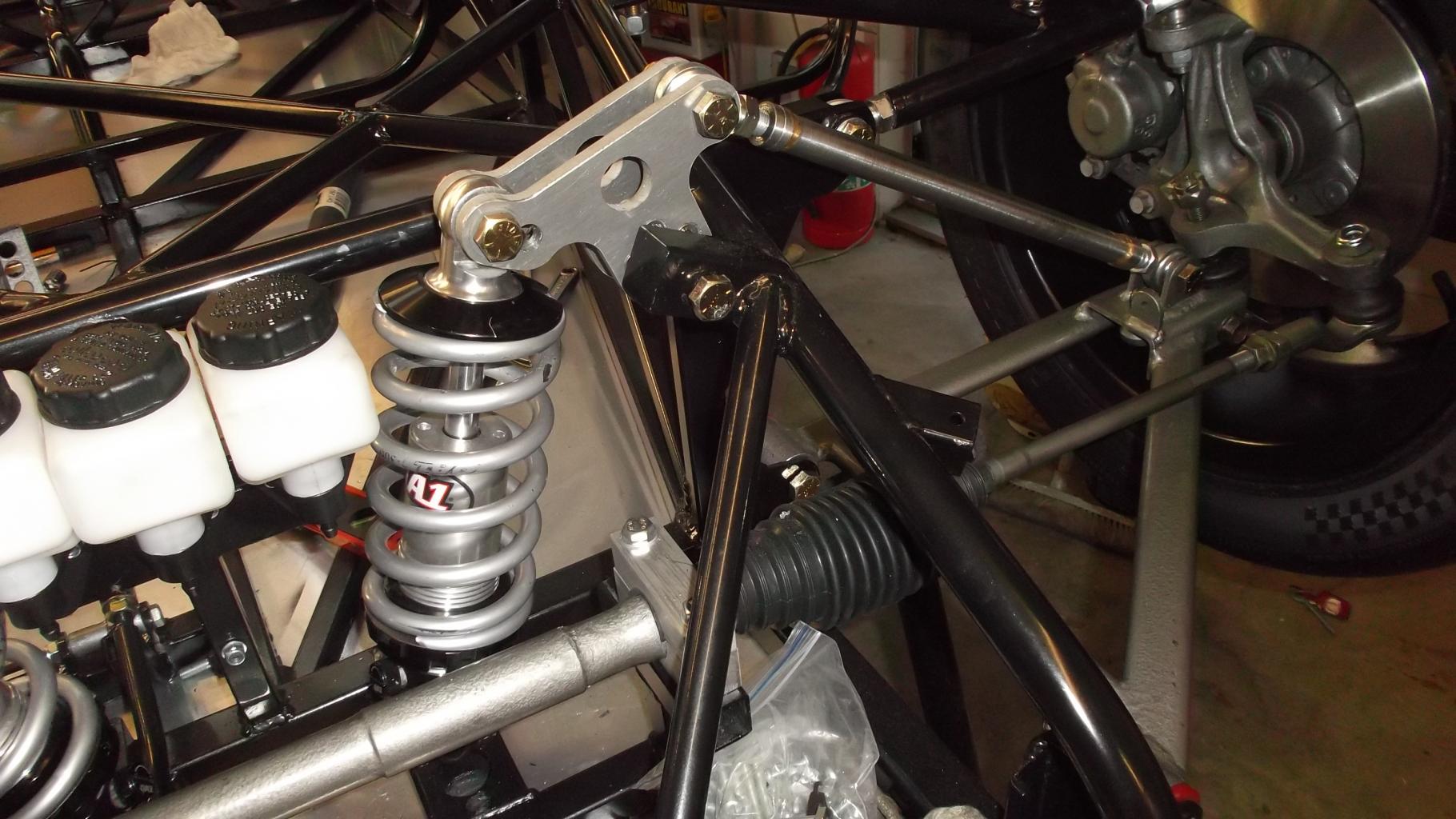

Not sure how much you want to fabricate or adapt but I have found that the MX5 upright appears to give heaps of lock. I can measure it if that helps. Brakes could then be the normal Willwood adaptions. I managed to get the whole upright including the bottom bearing and at this stage am happy.

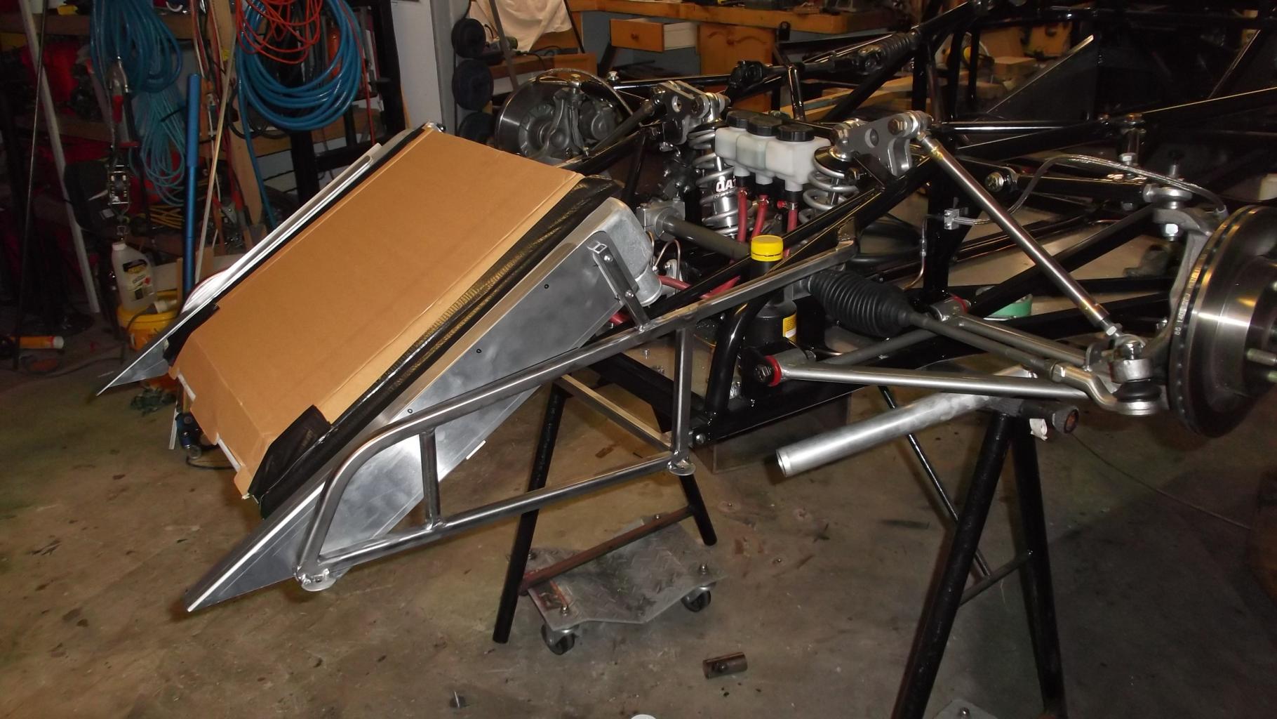

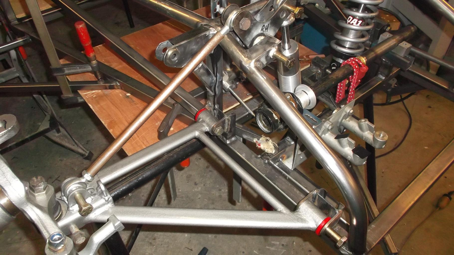

Russel its not the uprite that has been the problem, its the chassis design and the taper on the side rails, that limit how far the wheel can turn in.
kaspa
37' turning circle, 2.8 turns lock to lock for orinal Mk1, as you mention the taper on space frame chassis may hinder you somewhat, the original mono's are relieved in that area.

the MX5 uprights/knuckle that Russell Keach is using also have the axle offset forwards of the kingpin axis to reduce the mechanical trail its only about 10mm to 15mm, not much. This results in slightly less swing in the rear edge of the tyre, more in the front. hard to explain, but does add up.
Russell, it looks like you have had yours apart to repaint? any chance you would be able to confirm if the bearing size is a common size? I wonder if it would be feasible to put a 5 x 4.5" (or 4.75") pcd hub on the stub axle.

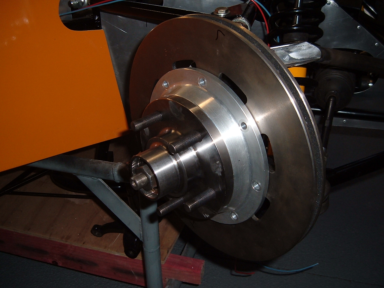

Ryan, just had a look and doubt that there is enough dia as the 100 pcd leaves little material left. Turning up new bearing carrier / hubs is no biggie and could be taylored to what ever dimensions you wanted...i did that on my first car to correct scrub radius.
I can also see what you mean by that off set...never noticed it.

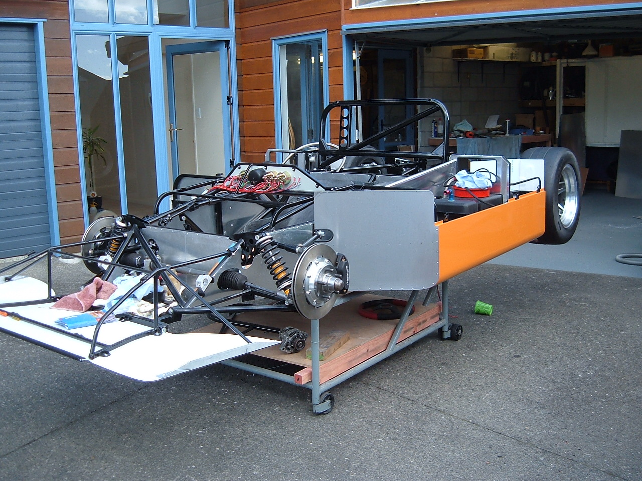

I have attached some pics from my first McLaren replica that may help.
Russell
