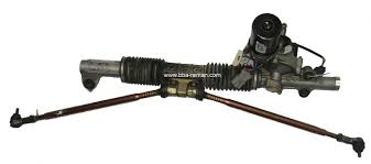

What I came up with it Honda civic power racks hyd or elec.
These are a rear steer, where the inner tie rods mount to remove that and mount a bar that is the correct length to give no bump steer, mount your rack end /rose joints to the end of the bar.
You have an adjustment by longer or shorter bar.
I have designed this into my next project and on susprog it has no bumpsteer.
Daiwoo use a similar rack hyd.
They are rear steer as well.

Got it sorted, i managed to get the rack length of the 4WD Territory rack, clamped on some suspension brackets in the right spot, ran a straight edge from top to bottom through hole centers and i'm a couple of mm out, dont think its worth worrying about, its that close to spot on.
cheers John
