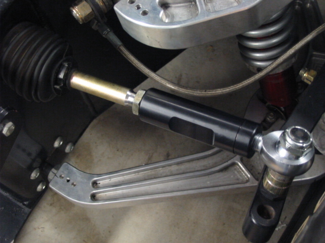

You should have two connection points for your tie rod. The aft connection will give you quicker steering and is best for street use. Could your tie rods be connected to the forward connection point?
Egoman / Wedge, is right, closer to the ball joint or pivot point will make it respond quicker but moving this in will also allow you to turn tighter and may cause your tires to rub?

Aft = inner point = closer to ball joint = closer to pivot point. (On the RCR GT 40, since the steering arm is forward of the ball joint).
