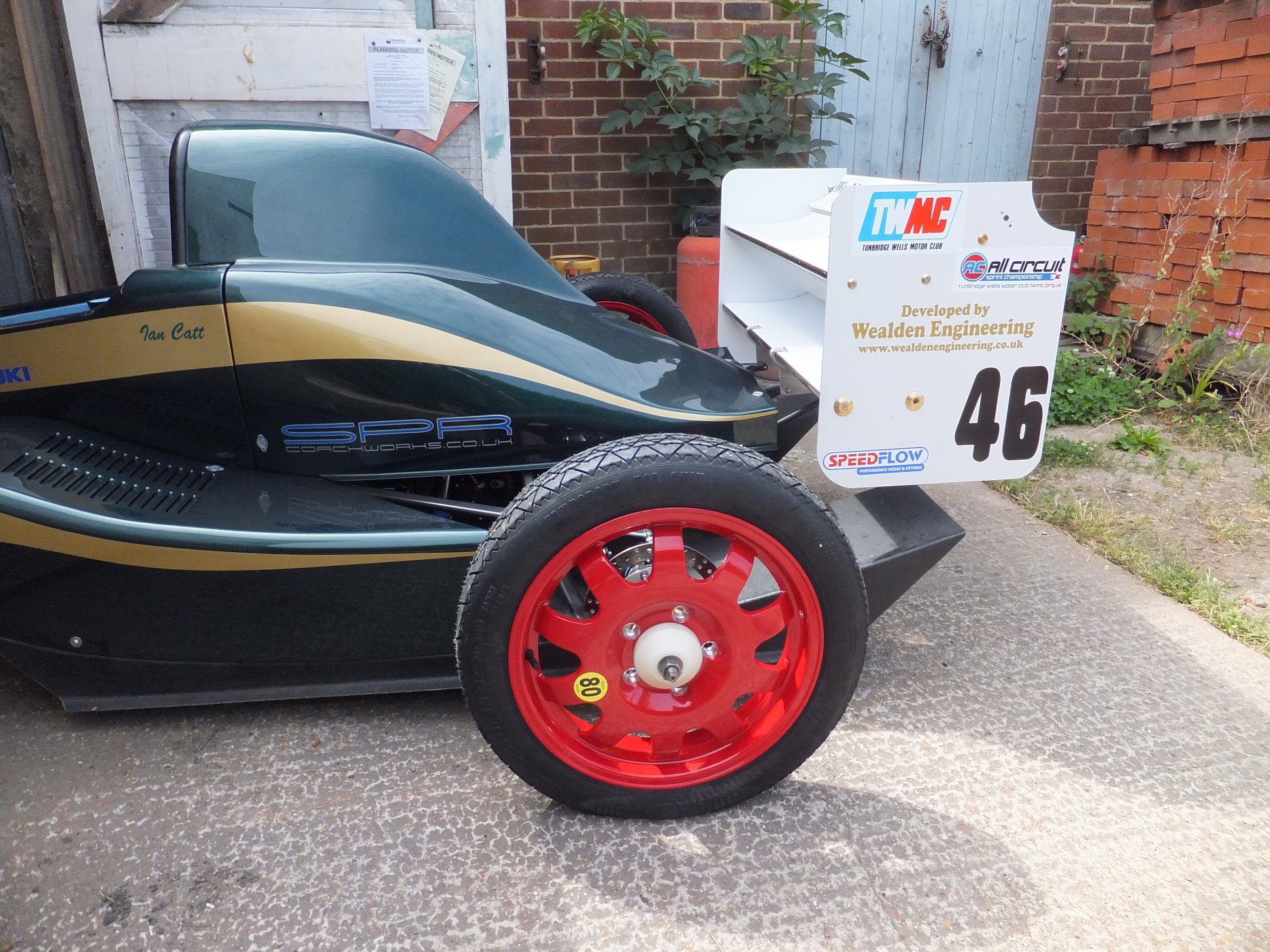

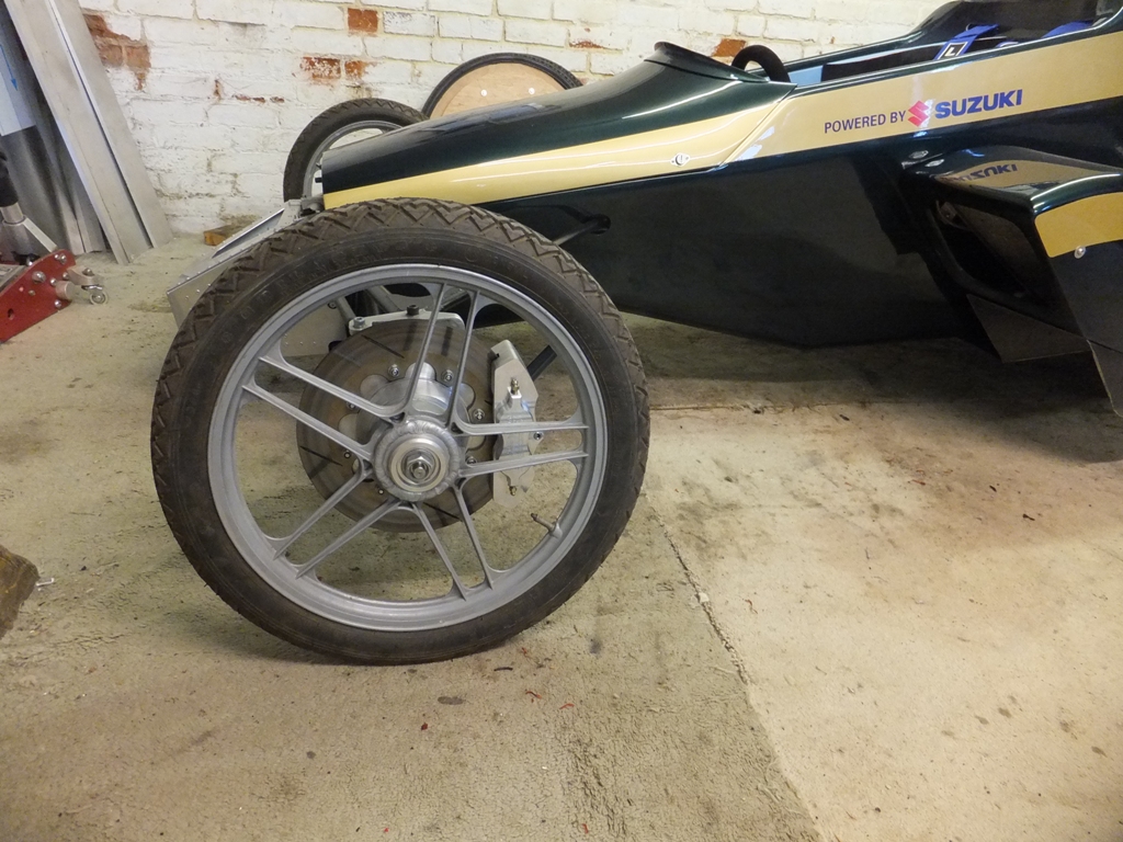

Frank’s “get you home” tyres are the way to go
i made some plywead wheels, but too point loaded for weight, and when first used as transport wheels in a trailer they put too much unsprung load on the suspension and broke it . The wheels shown are not pegged or bolted, they just sit on nylon centres and turn independently, after we are never going to drive on them, Frank
