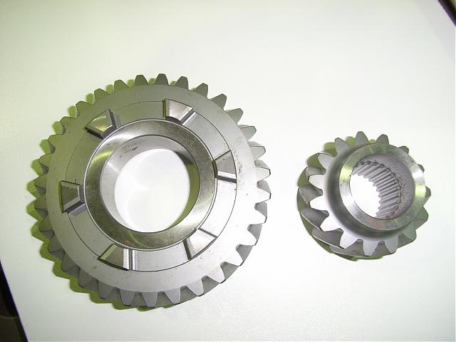

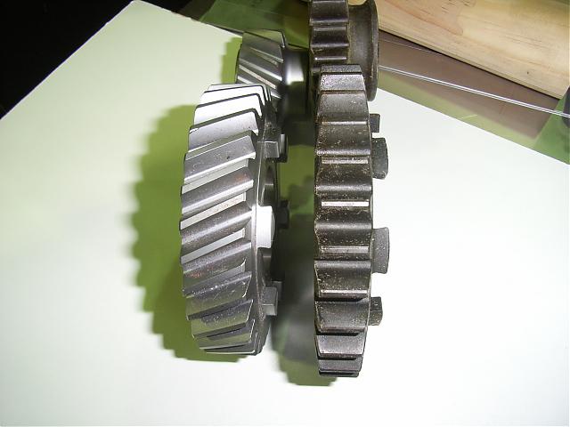

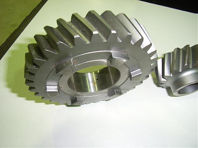

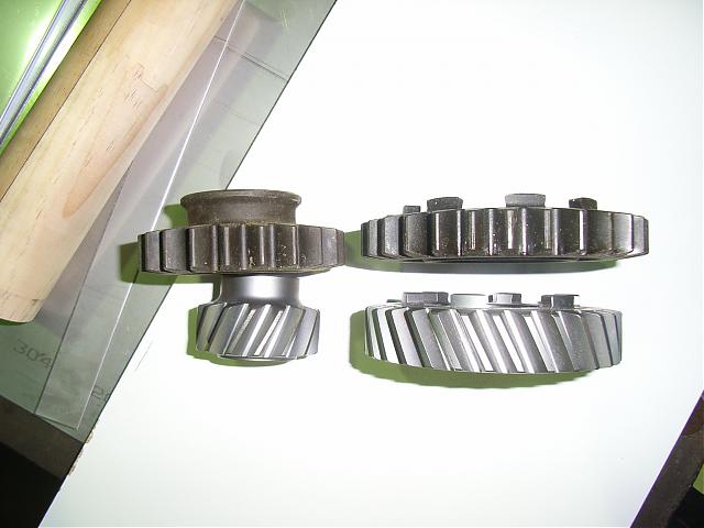

I found some pictures of a spare first gear from my Holinger box showing the helical cut with dog gears and a 4th or 5th gear set from the Hewland with straight cut and dog gears, its interesting to see how much wider the Holinger gears are even before you add the effect of the helical cut.
