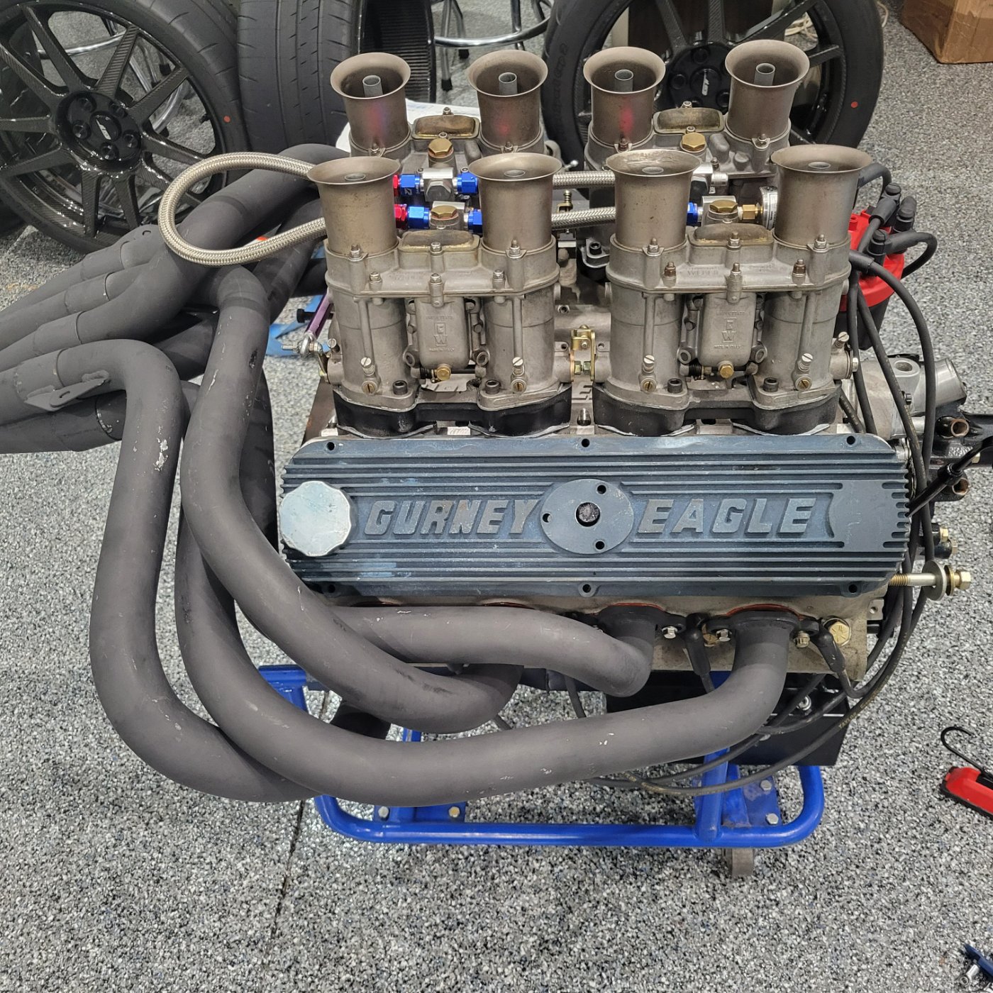

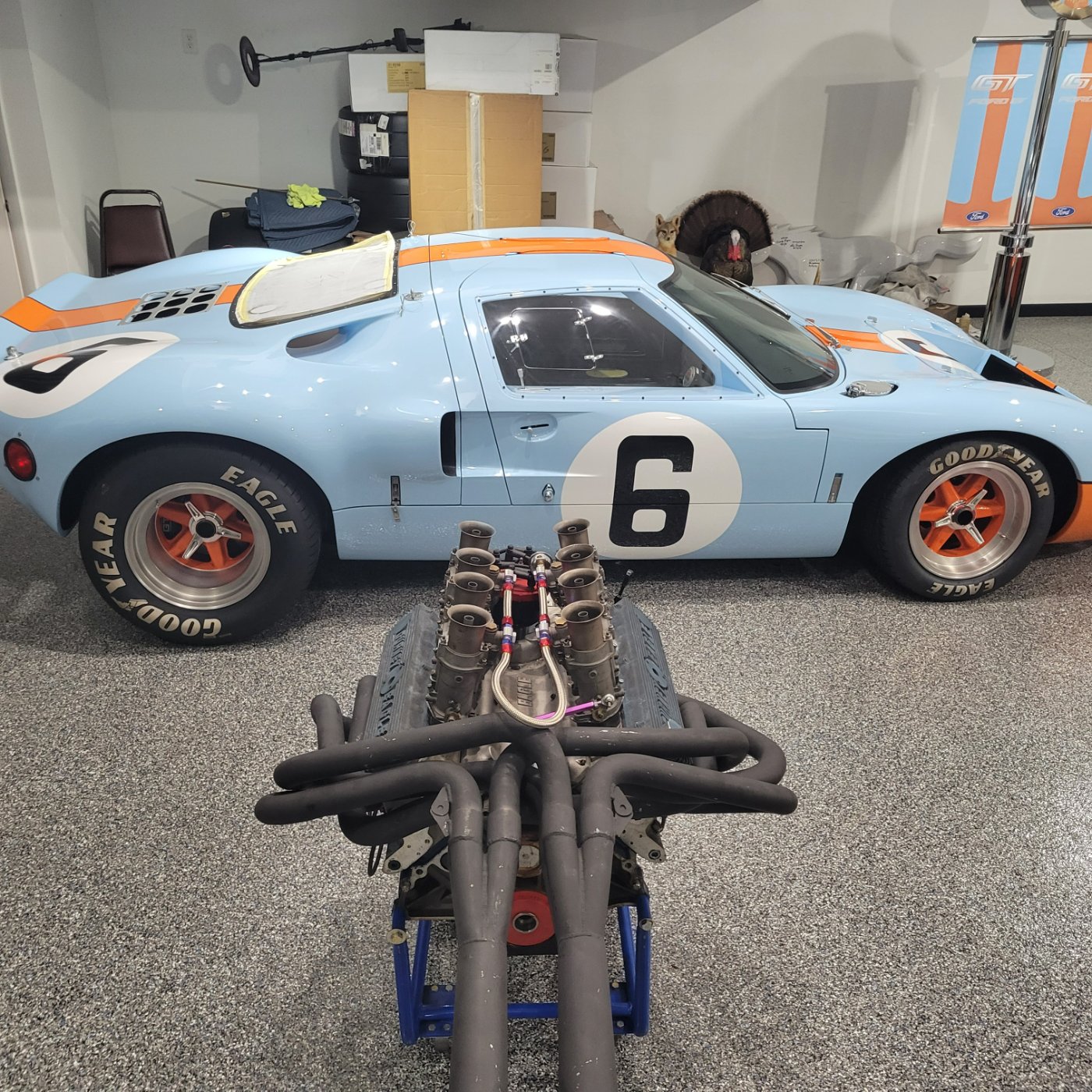

Agreed youn will always want a GW motor in a mkI

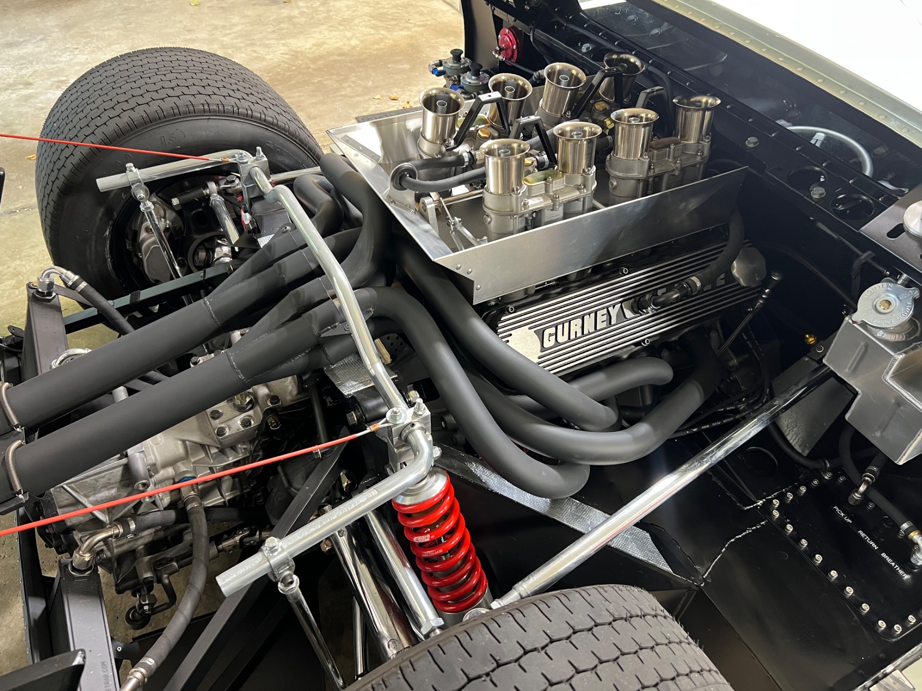

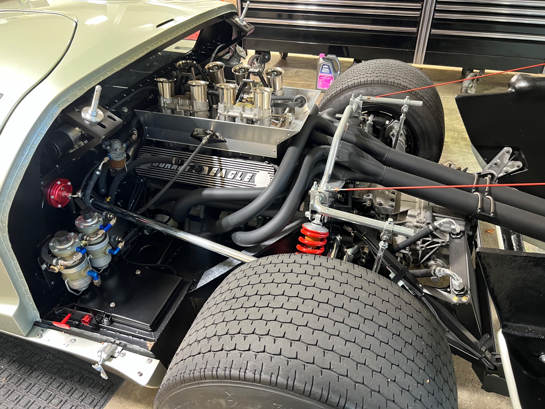

When specing out mine I wanted it to be close as possible so RHD, Gurney Westlake with webbers. Hard to find someone putting one together like that and giving it up. If it's left hand drive and it drives great and your happy with it then that's all that matters.
