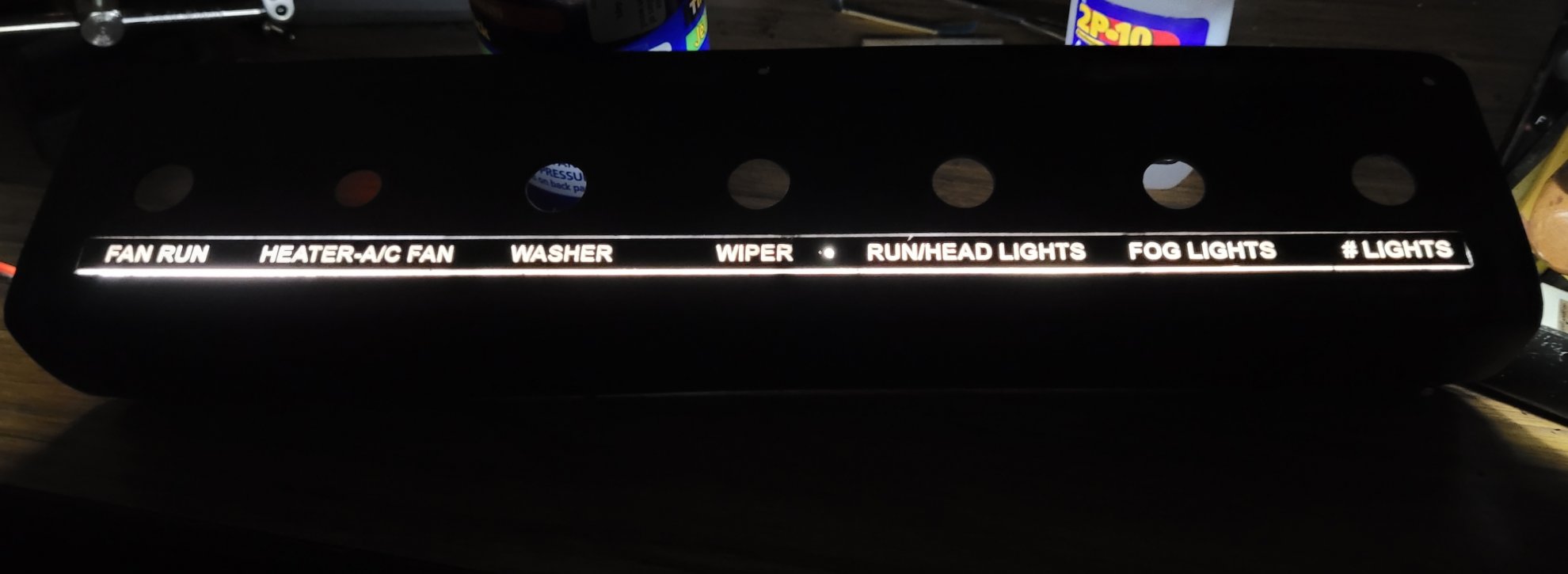

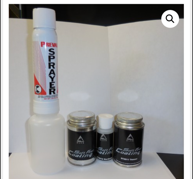

Does anyone know what paint Superformance uses to paint their Dashboards? It has to be painted because there are a few different materials. Dash fiberglass, switch panels ABS, etc. I'm trying to add some much-needed lighted lettering and will need to do some touchup of the paint. I might also have to re-make the switch panels out of a laser-friendly material and laser cut or CNC the lettering directly into the panel which again will need to be painted. Thanks for the help.
Phil G

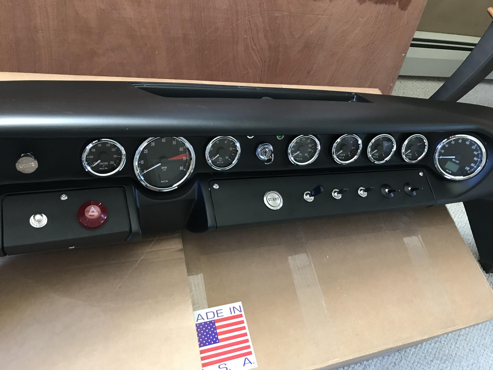

I am not 100% sure on this but I believe SPF dash is painted with ALSA soft touch paint. ALSA has a sample kit you can buy which should be more than enough for what you need. I did my complete dash with there sample kit with Preval sprayer.

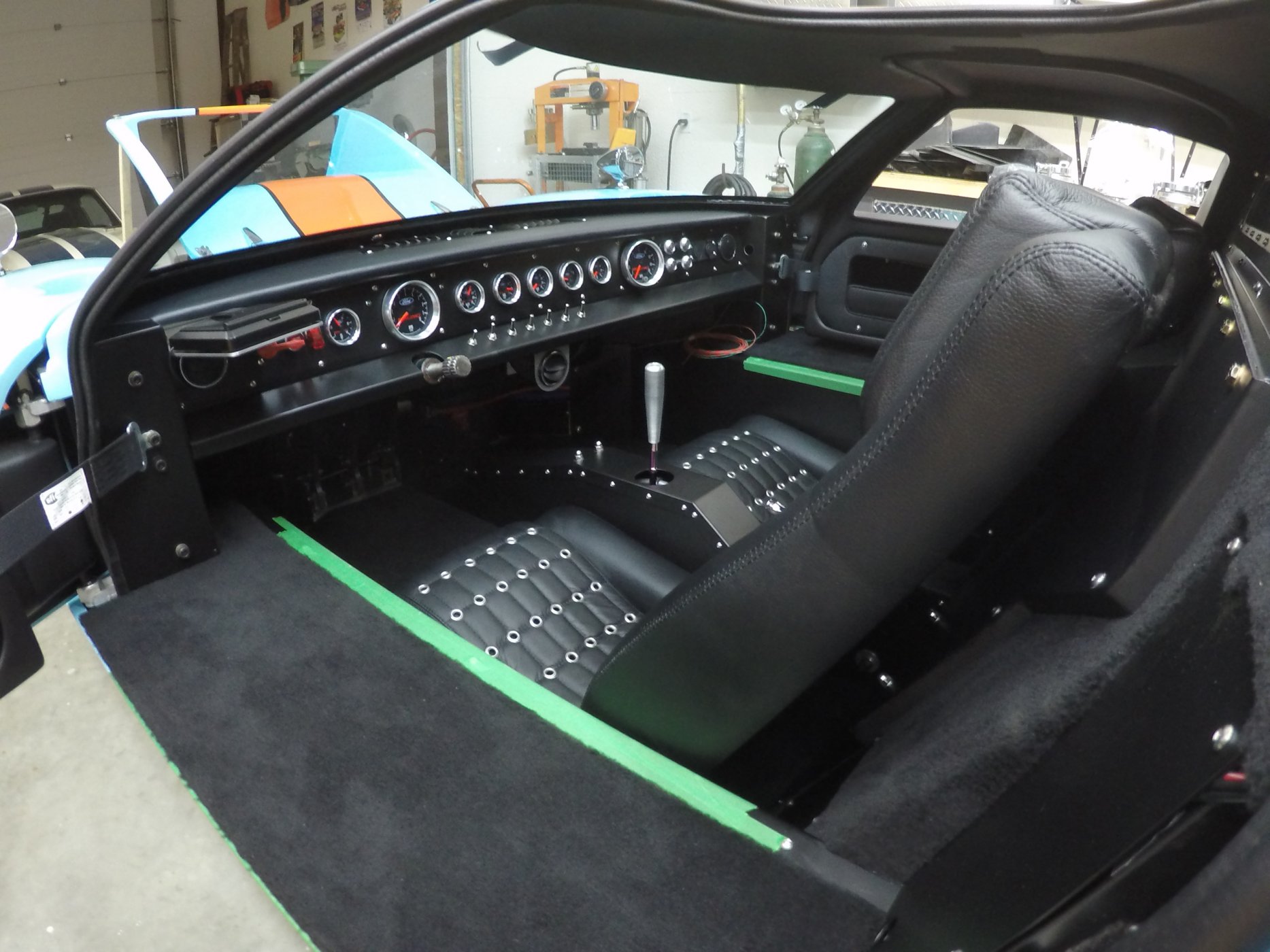

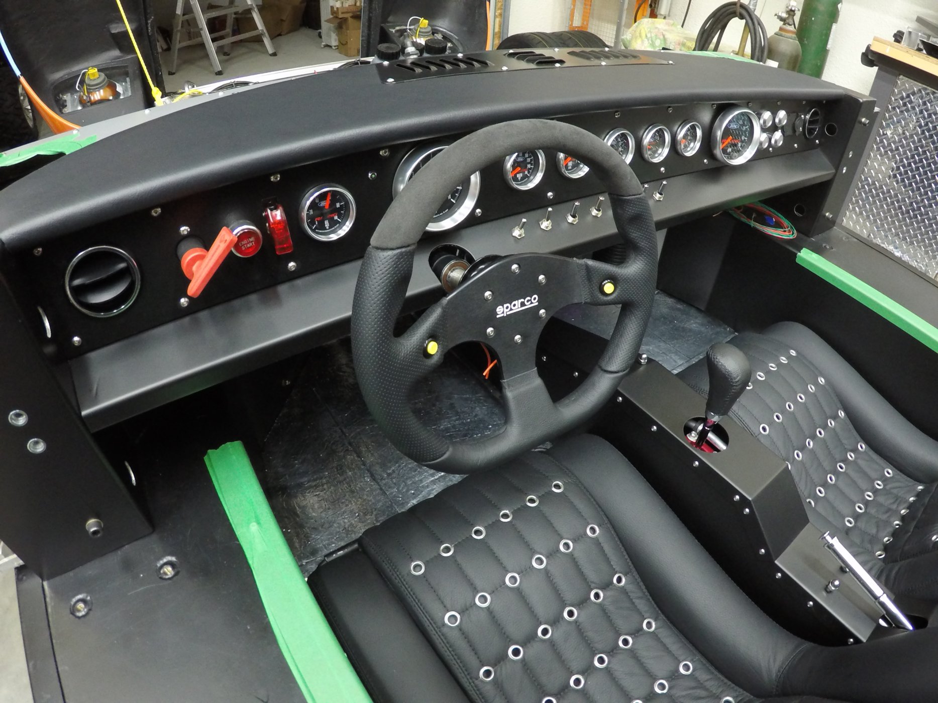

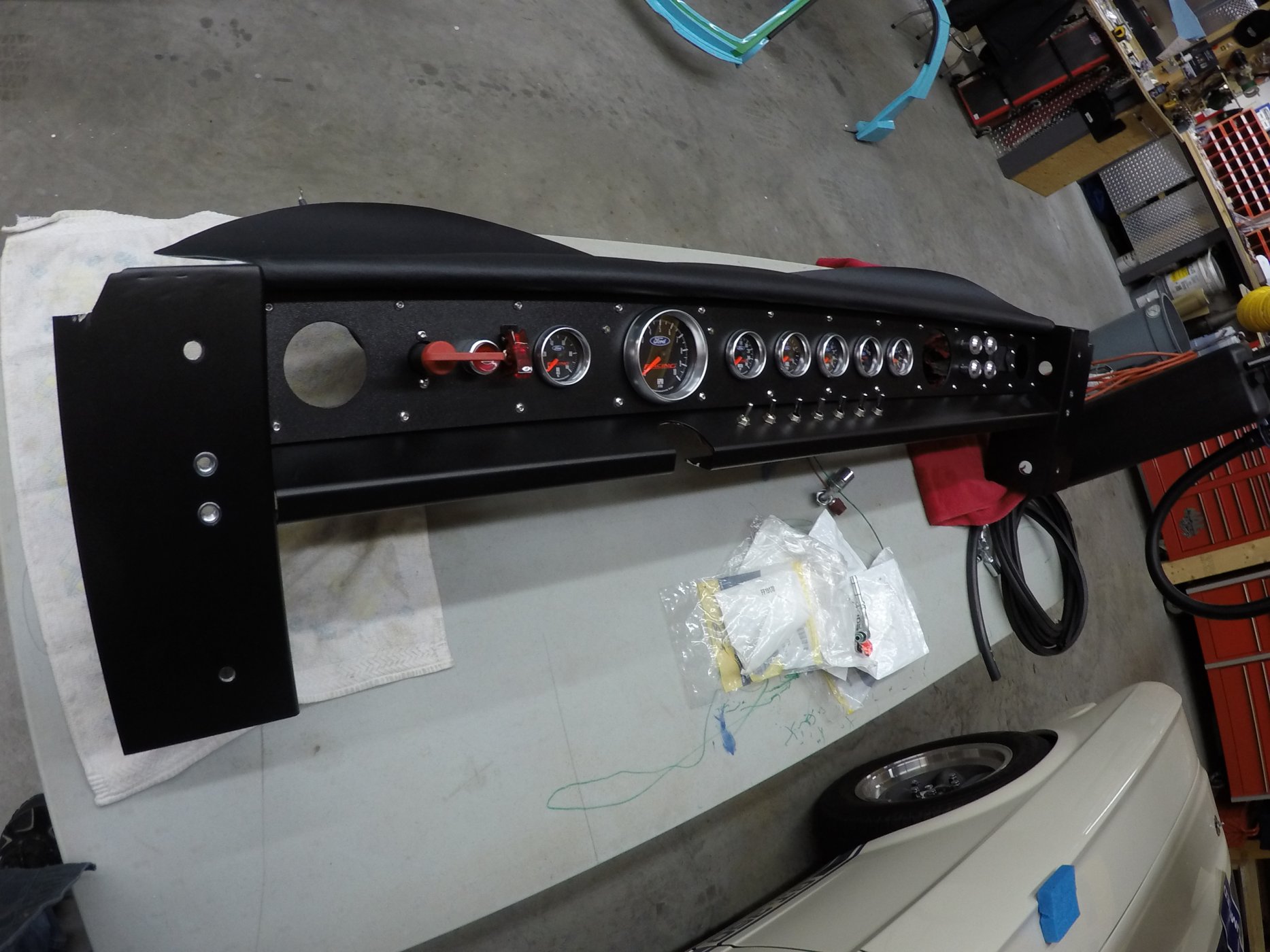

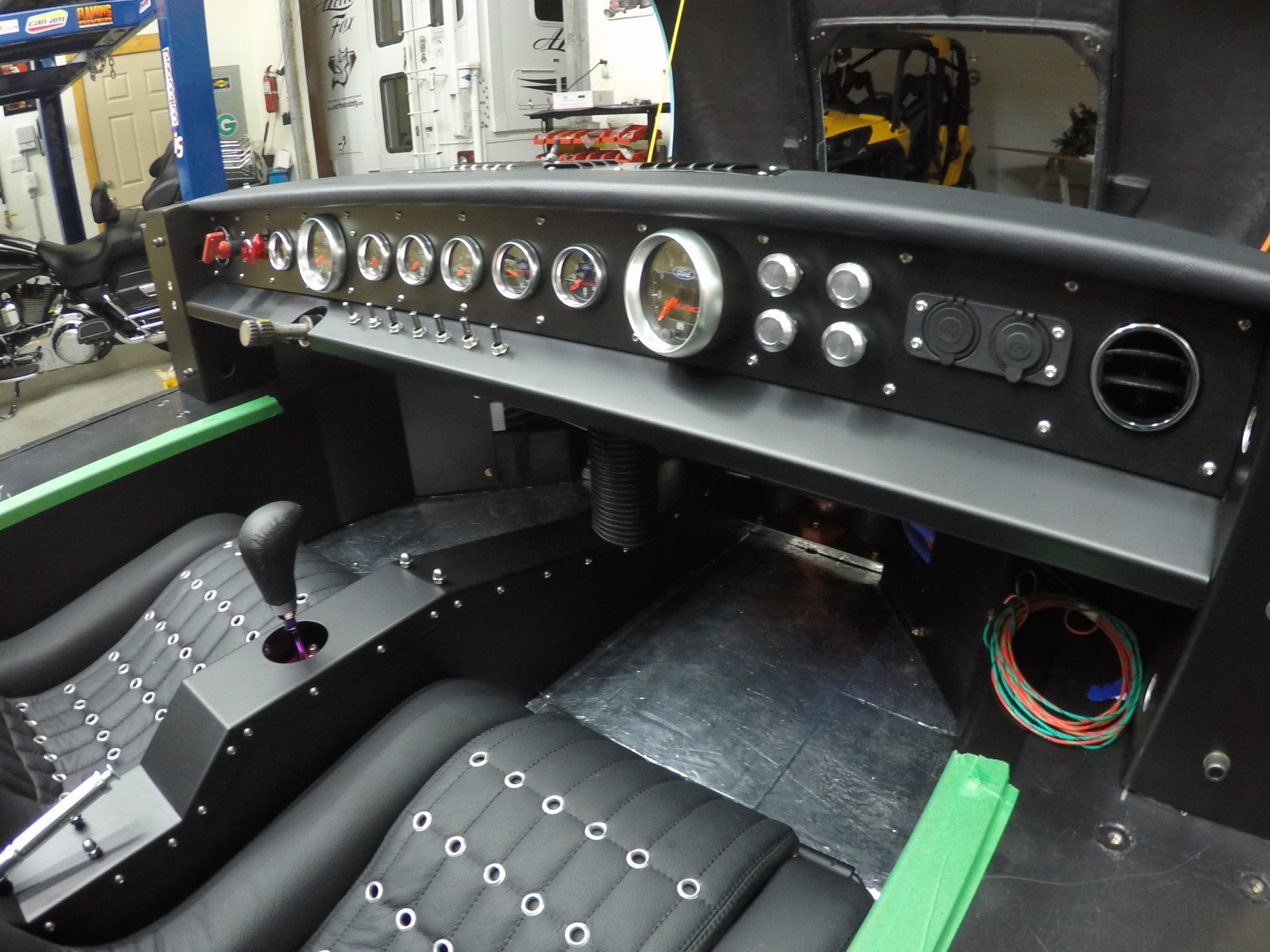

I built my own and powder coated it and made a soft touch top piece Dave because the dash I got was junk and beyond fixing.
