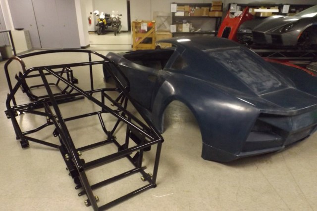

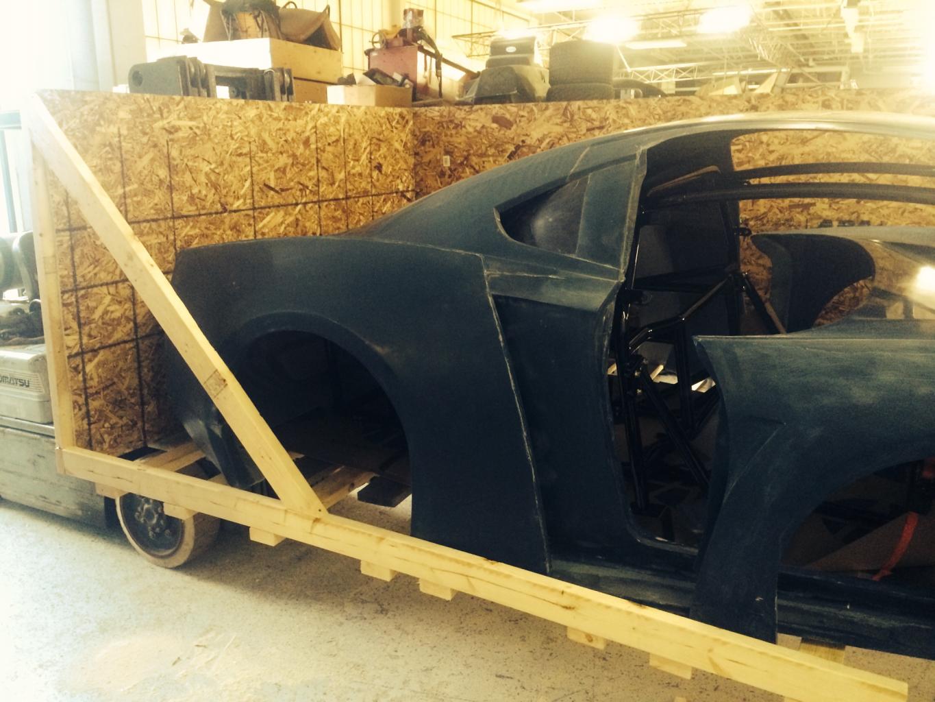

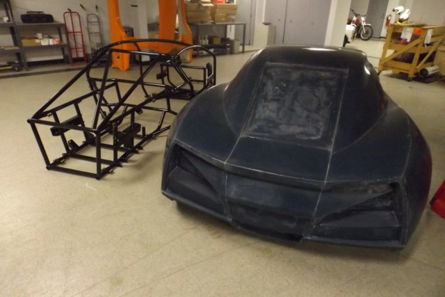

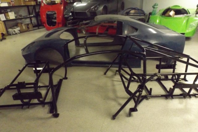

Did get the body and tube framing. Just haven't had time to post any pics.
Everything looks great. The rear is one piece which is nice.
Started positioning the rear frame into the donor. I was conservative in my initial cutting of the body which is good. I have placed the frame in and out of the rear about 10 times to make sure everything is lining up and trimming the donor just right.
i know everyone is anxious about seeing pics.
Yeah, it's hard to live vicariously without visuals! :cry:
Yep, plus I'll have to let everyone see how messy the barn is :)
I have attached some pre-shipping pics

Awesome....looks great. Can't wait to see your progress. Did any other tidbits ship with it?? Would like an idea of the complete kit...I'm sure you were planning on doing so sorry if I'm rushing.
Fran,
So the kit isn't necessarily come gel coated like the SLC (not necessarily a bad thing)? Is that because you do some work on it first?
Do all the tube frame's come painted? basicly wondering if this is you're typical kit or addon's besides the additional roll cage.
Still love it...Thanks!!!
Sorry i wasnt clear... I can see that it's gel-coated during molding but I was more referring to the finish not being similar to the SLC. I wasnt sure if it's because they join some of the body panels themselves or just since you have to do body work to skin the roof it doesn't really matter if it's finished or not. Was just curious it doesnt matter either way. I definitely think it's better this way. wasn't expecting it to be one or two pieces. I can see how it should come together nicely.
Doug S.
I am amazed at how much of the body there is...expected the "tub", for lack of a better word, to be that section of the Eclipse and then just a front and rear section to bond to it...but, of course, that may be EXACTLY what I'm looking at. I just wasn't expecting the top of the cabin to be part of the RCR product.
The tube frame looks VERY well done, not that I'd ever expect anything else from RCR!
Cheers!
Doug
